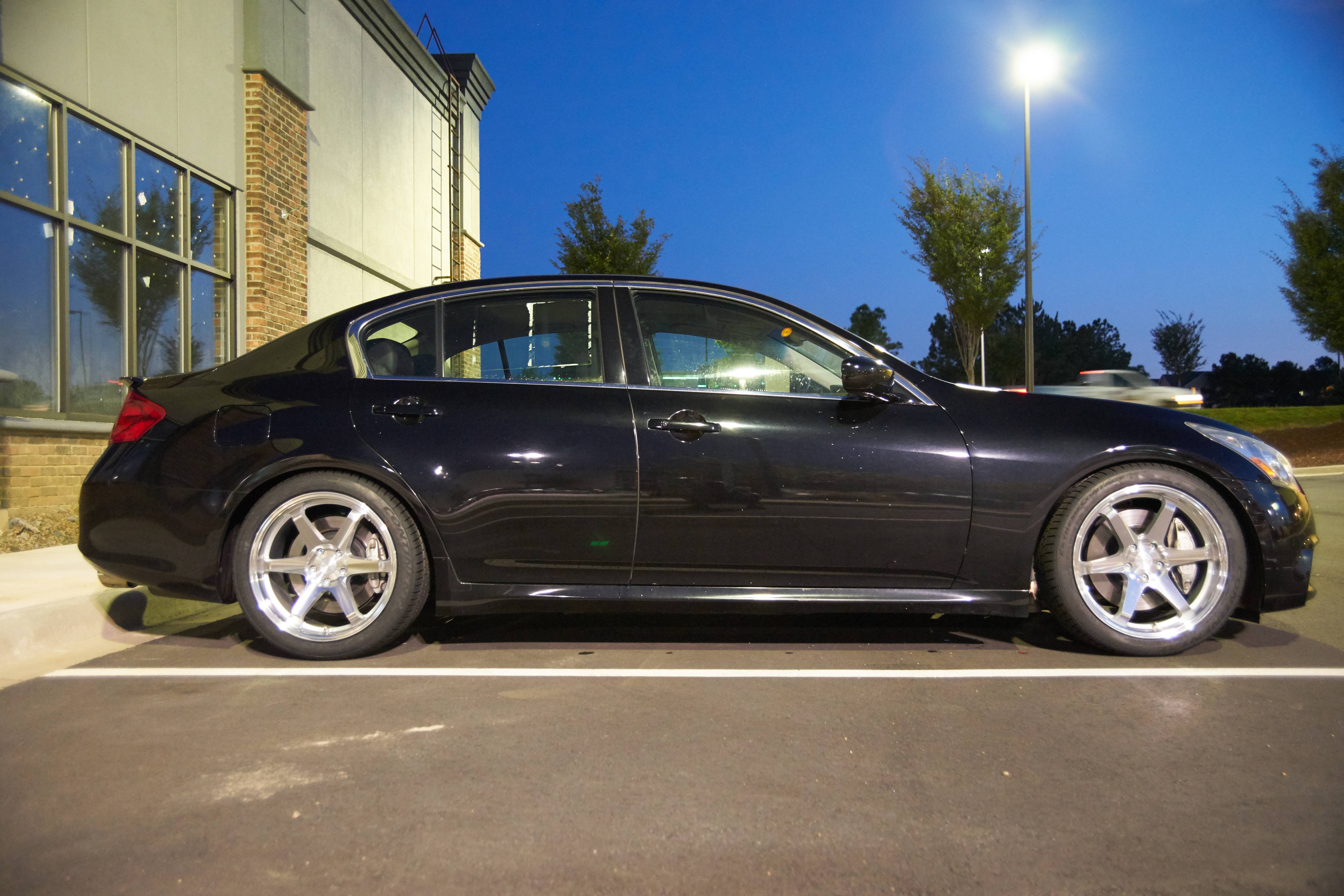

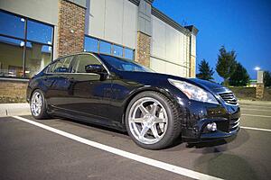

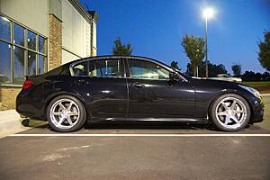

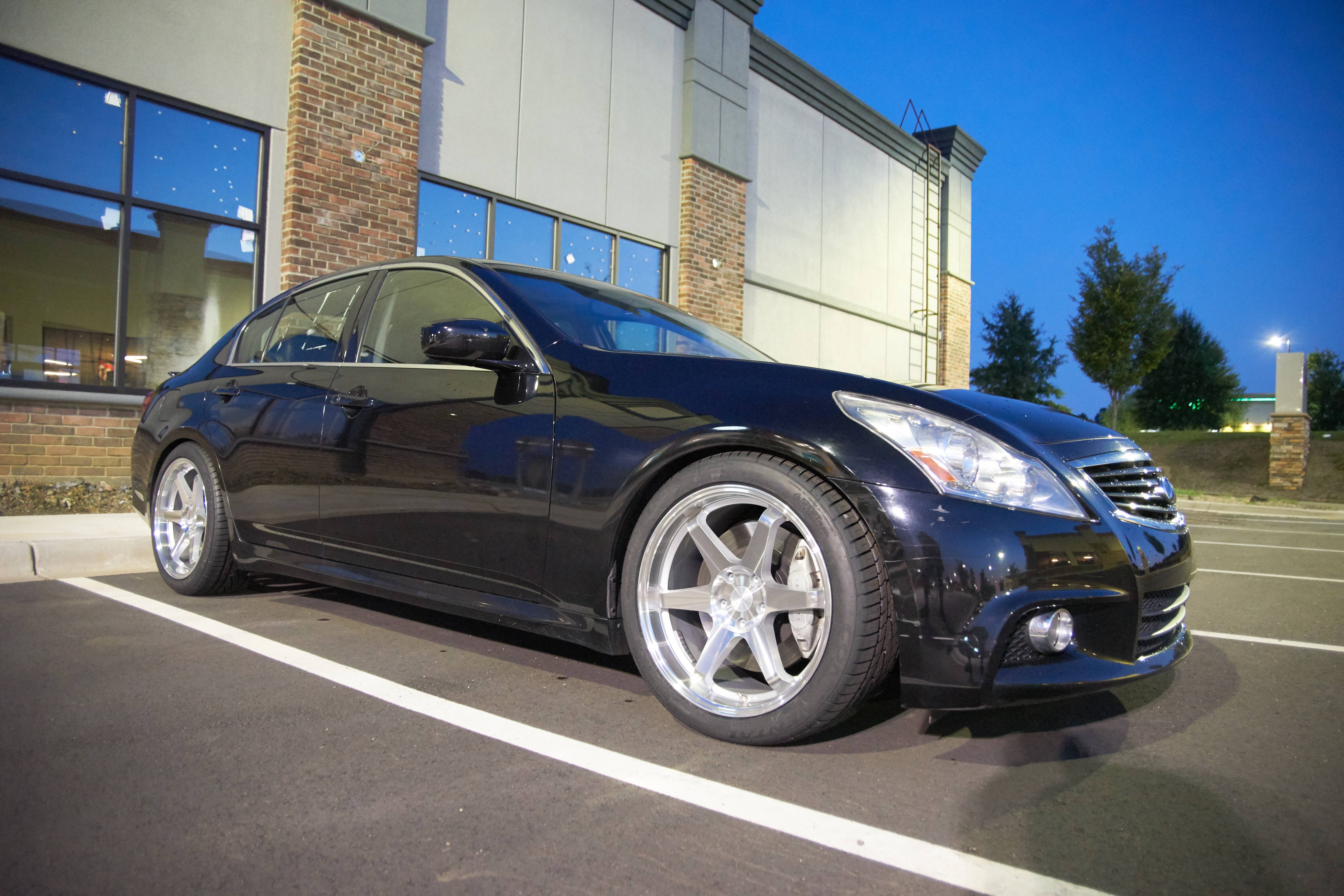

Got the wheels on... 19x9.5 +25/+35 ESR SR07s
Dropped the front right corner a tad to balance it all out; driveway is sloped
Old Sep 10, 2017 | 10:40 AM
  #23
Looks like that extra drop made a nice difference w/ the fit right there. What alignment specs are you running now?
Well to be fair my driveway is sloped, which puts extra weight on the front. I think I need to raise the rear, but I don't know if I have any adjustment left. I might need longer springs out back. Been thinking about upping the rear rate anyway.
Alignment is a little up in the air. I think the shop that did it tried to align the car with 220lb of wheels and tires loaded I have a 6 month unlimited warranty on it so I think I'm gonna grab front and rear camber kits and get it dialed in. The fronts rub just a hair on hard bumps so I will go a little more negative up front; the rears had pretty gnarly camber wear so I will go a little more positive out back.
It does handle a lot better now. Steering is lighter but more responsive and it has the same planted feel as my old Z. Grip is pretty tenacious as well. I just need to get all my settings dialed in to balance grip/looks/tire life. In retrospect going with the 8.5/9.5 probably would have been the better move.... I will see what happens with this set of tires. If I can get 20K out of the rears I will probably jump on the staggered train next go round.
