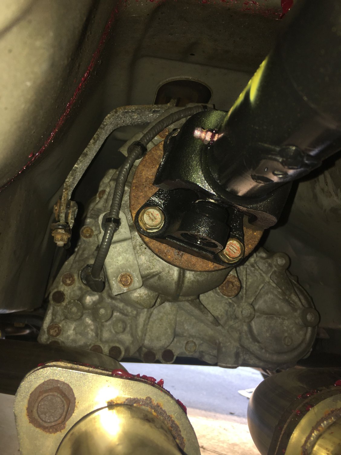

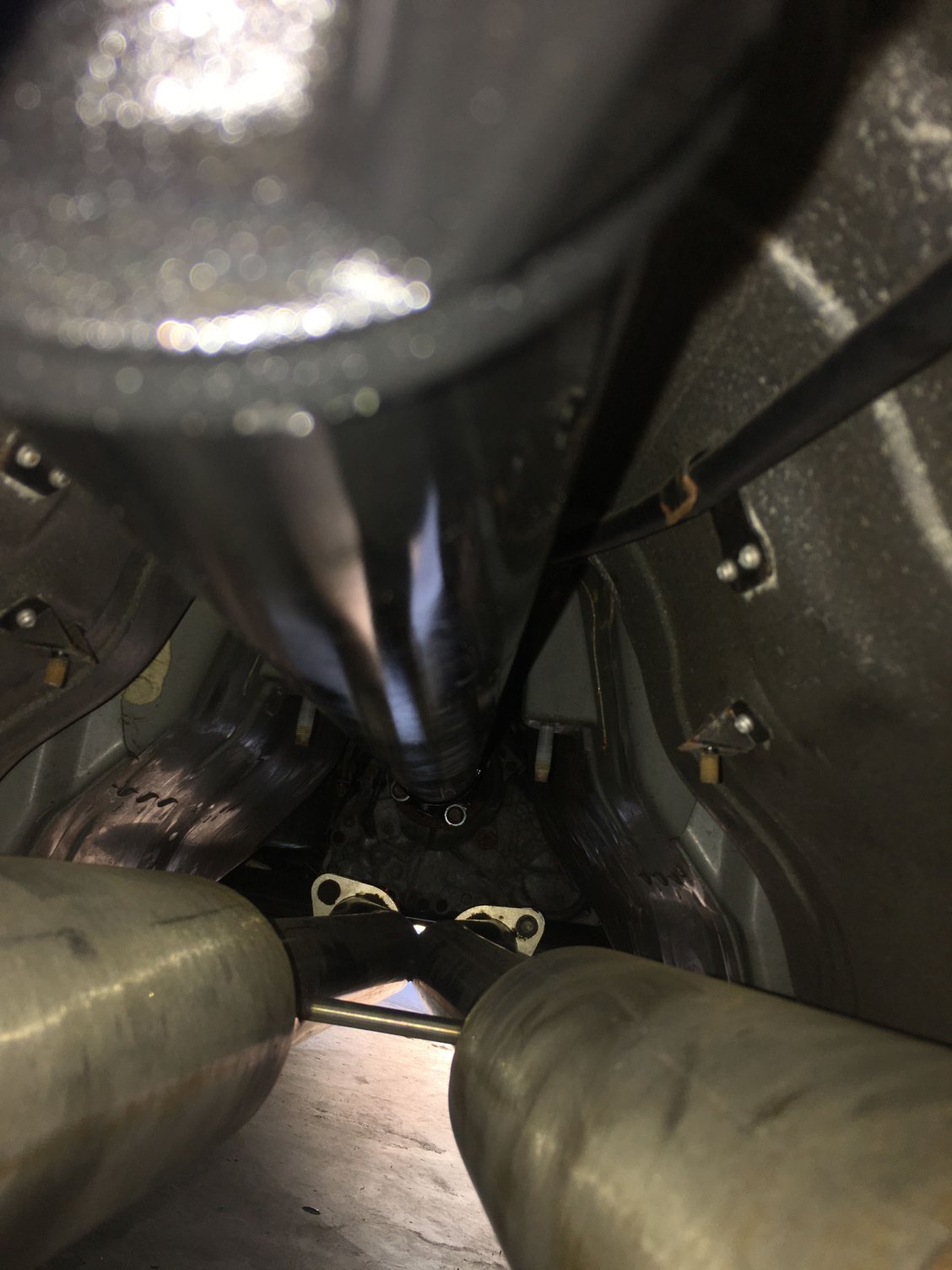

So this is where we’re at. Ended up going with a steel driveshaft $500 installed. (Kinda cheap I thought)
However, my reasoning for doing steel over aluminum so is because my local driveshaft guy AND thedriveshaftshop said they can’t make it in aluminum with my dimensions and the way it bolts up. Still lighter than stock, don’t have the accurate weight. Was told it would shave 10lbs or so hopefully that’s true. It looks amazing

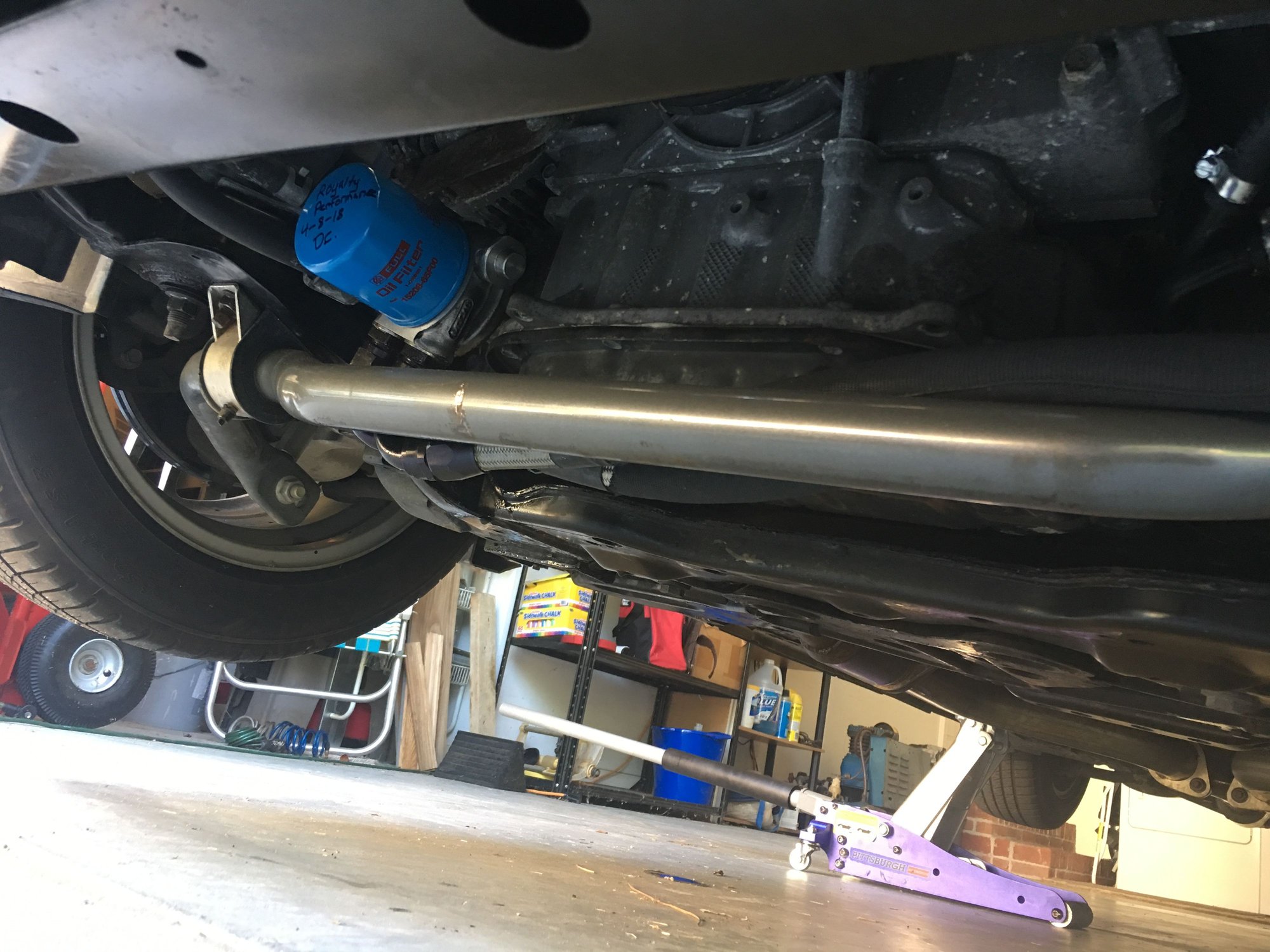

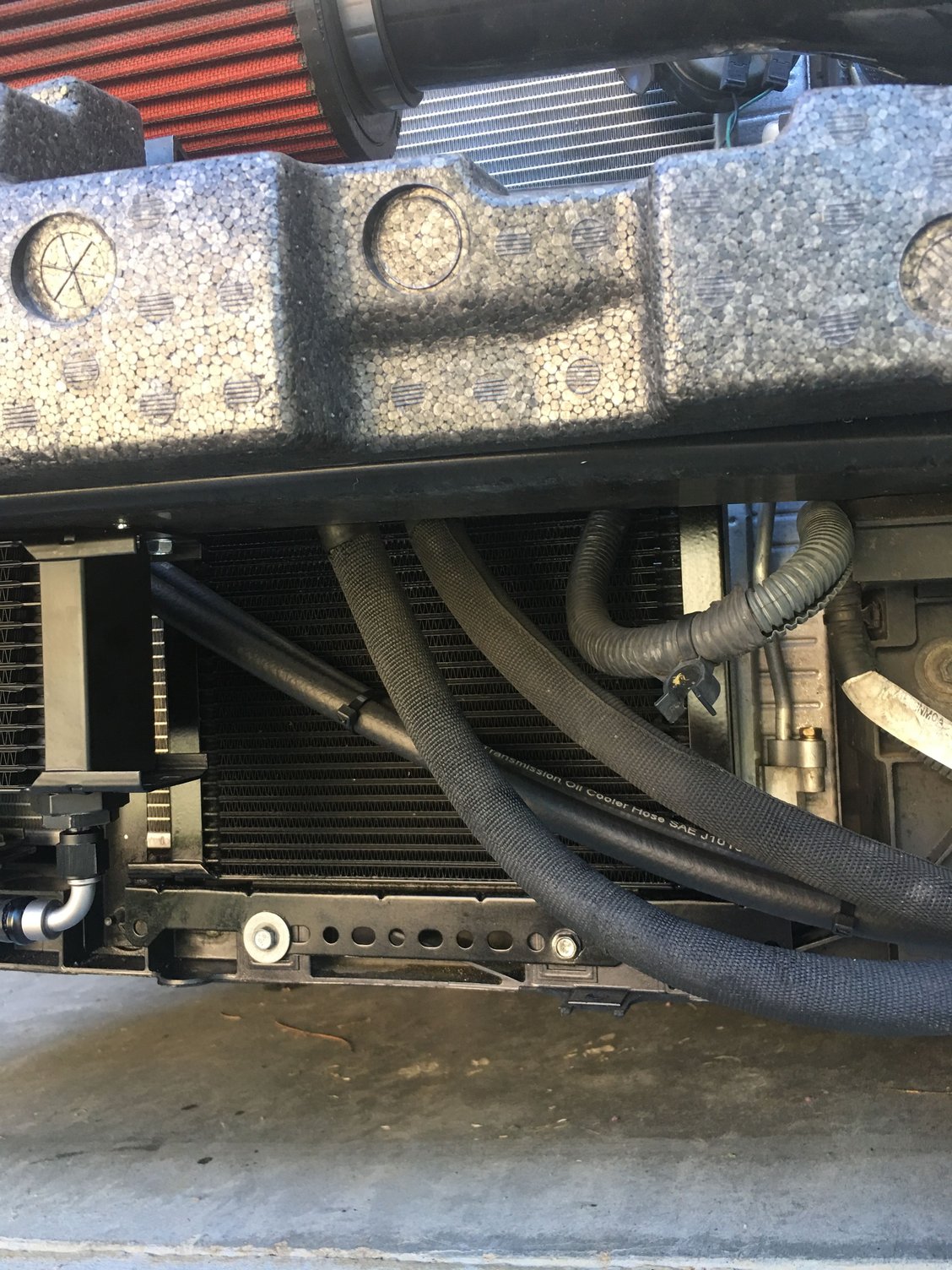

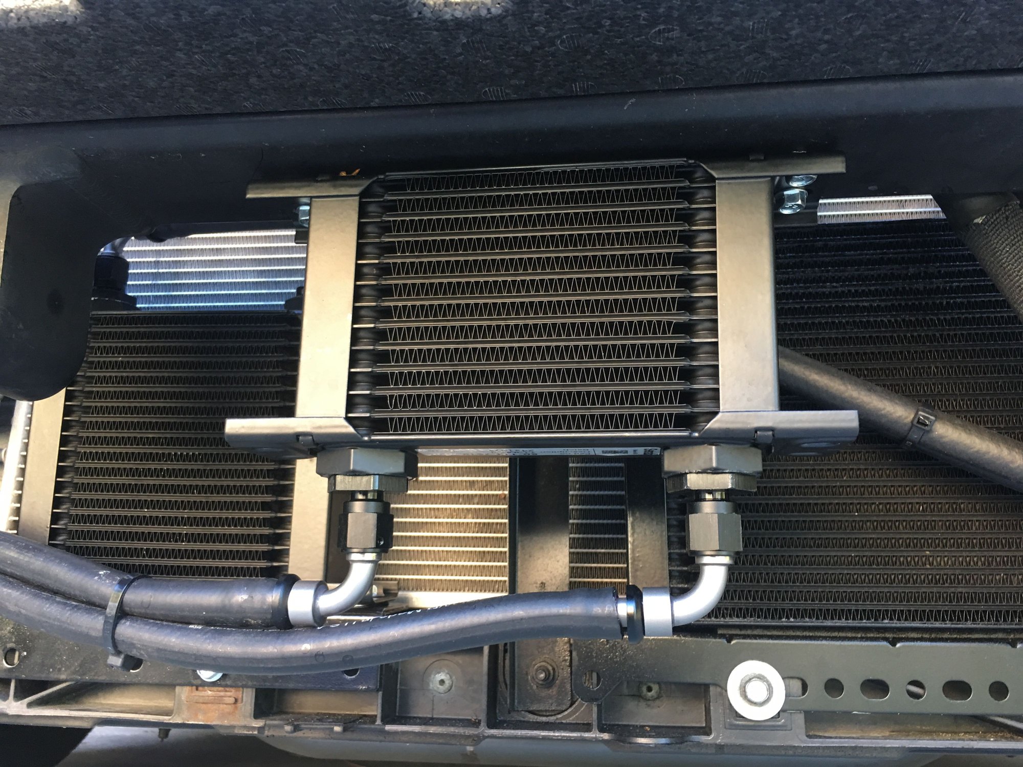

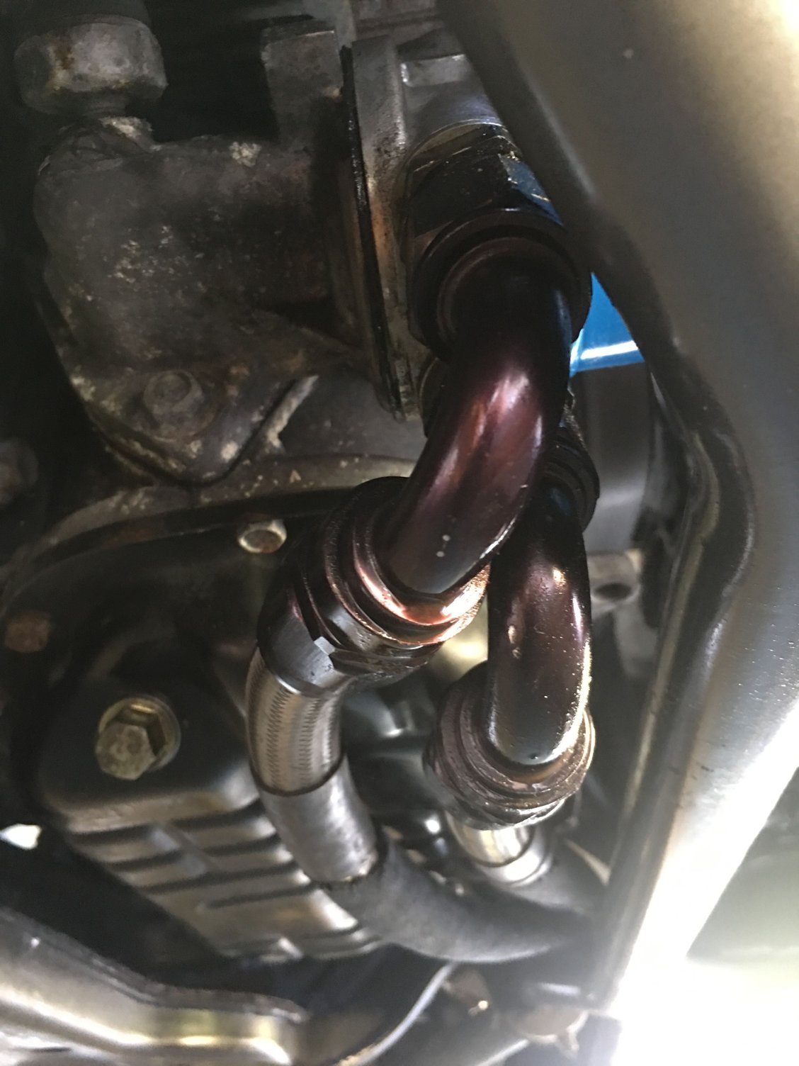

At the filter side
Showing front of oil cooler.
Showing front of oil cooler with where lines follow the sway bar to the filter area.
Filter area
Overview of everything Here you go buddy!!!!!

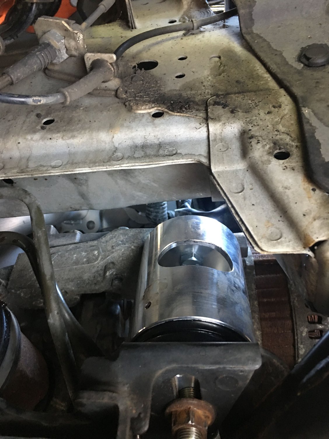

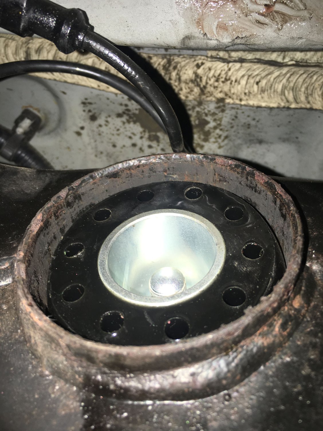

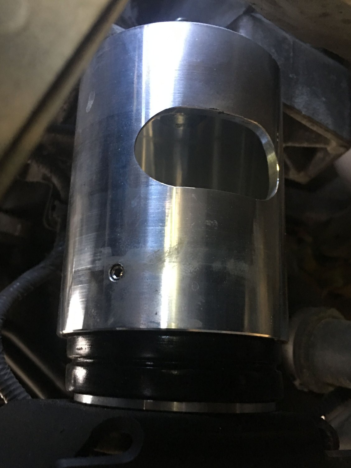

Z1 motor mount
Z1 power steering cooler
Rear Diff bushing

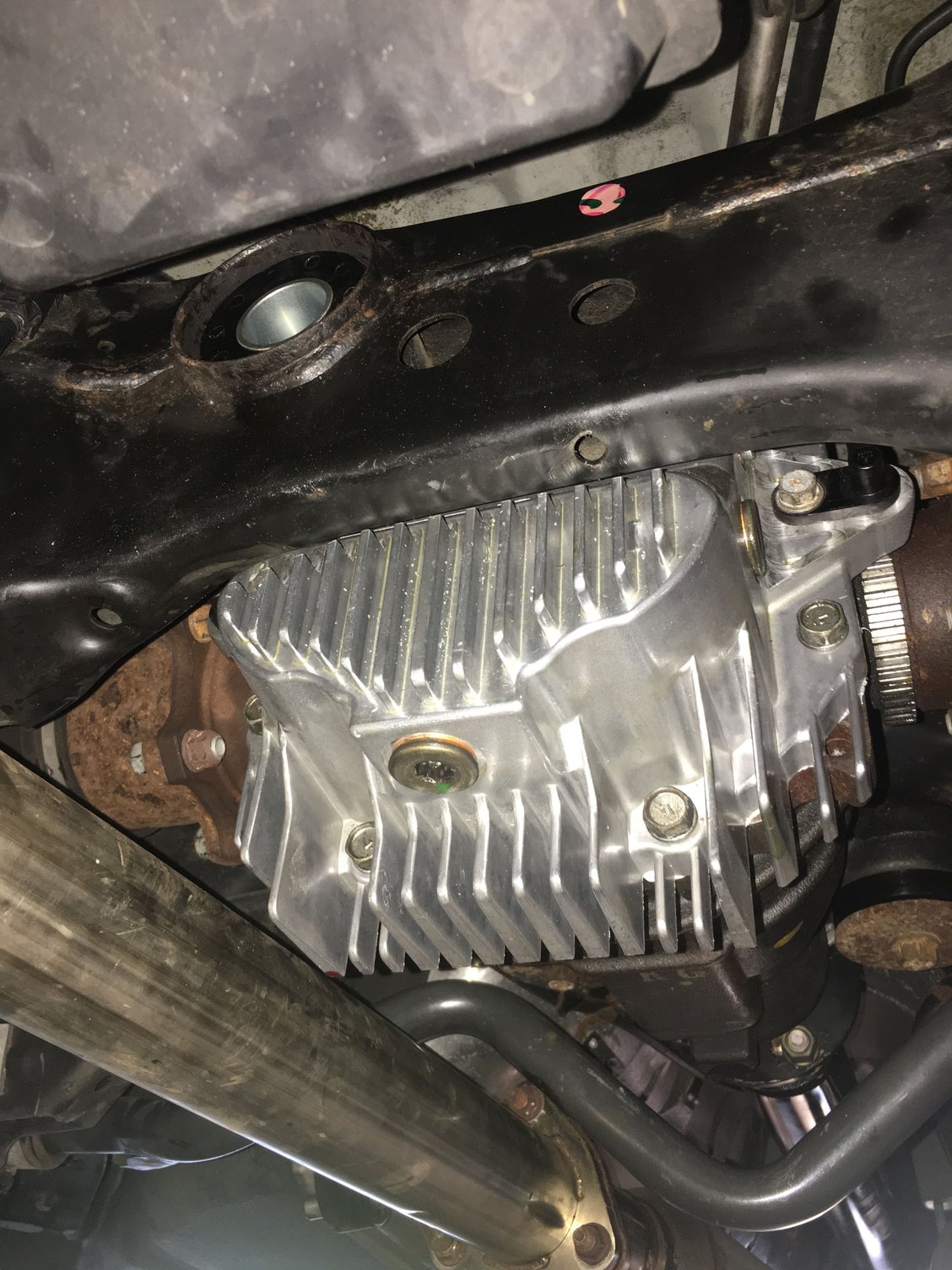

Z1 diff cover
Rear diff
Overview

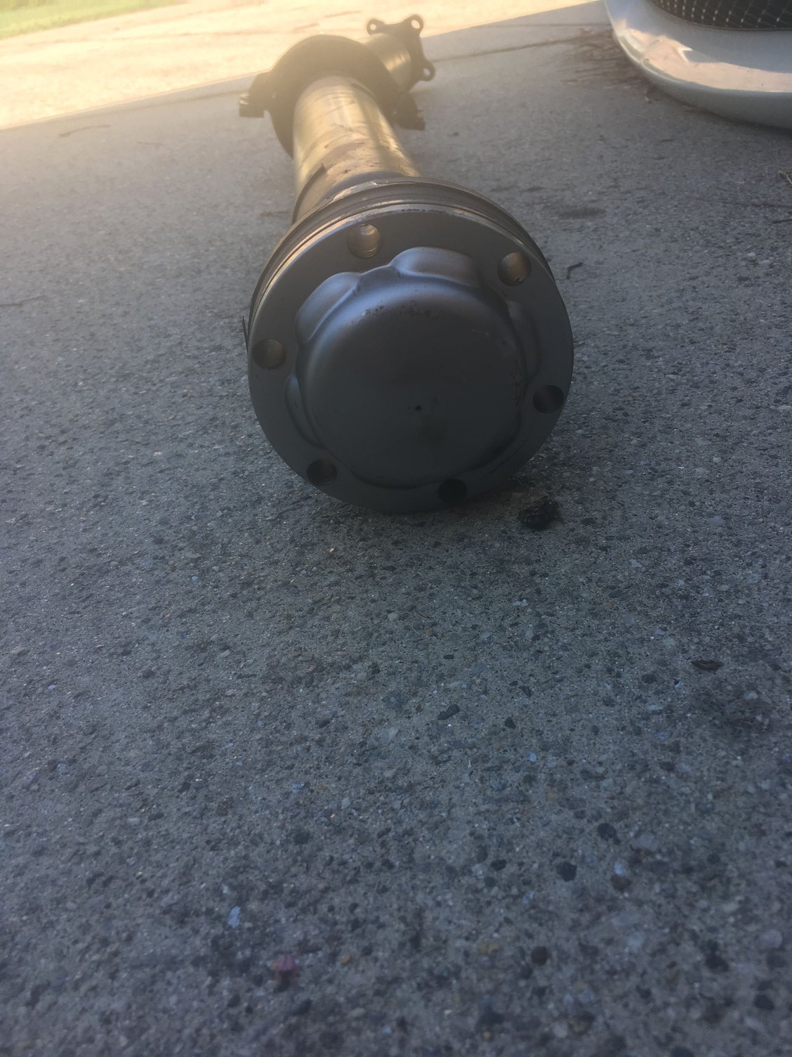

Oem driveshaft
Oem driveshaft
Oem driveshaft
Oem driveshaft
Oem driveshaft
Trans cooler
Motor mount

Z1 motor mount. Helped solve clearance issue with my headers by lifting motor up a little bit. Sooooo happy

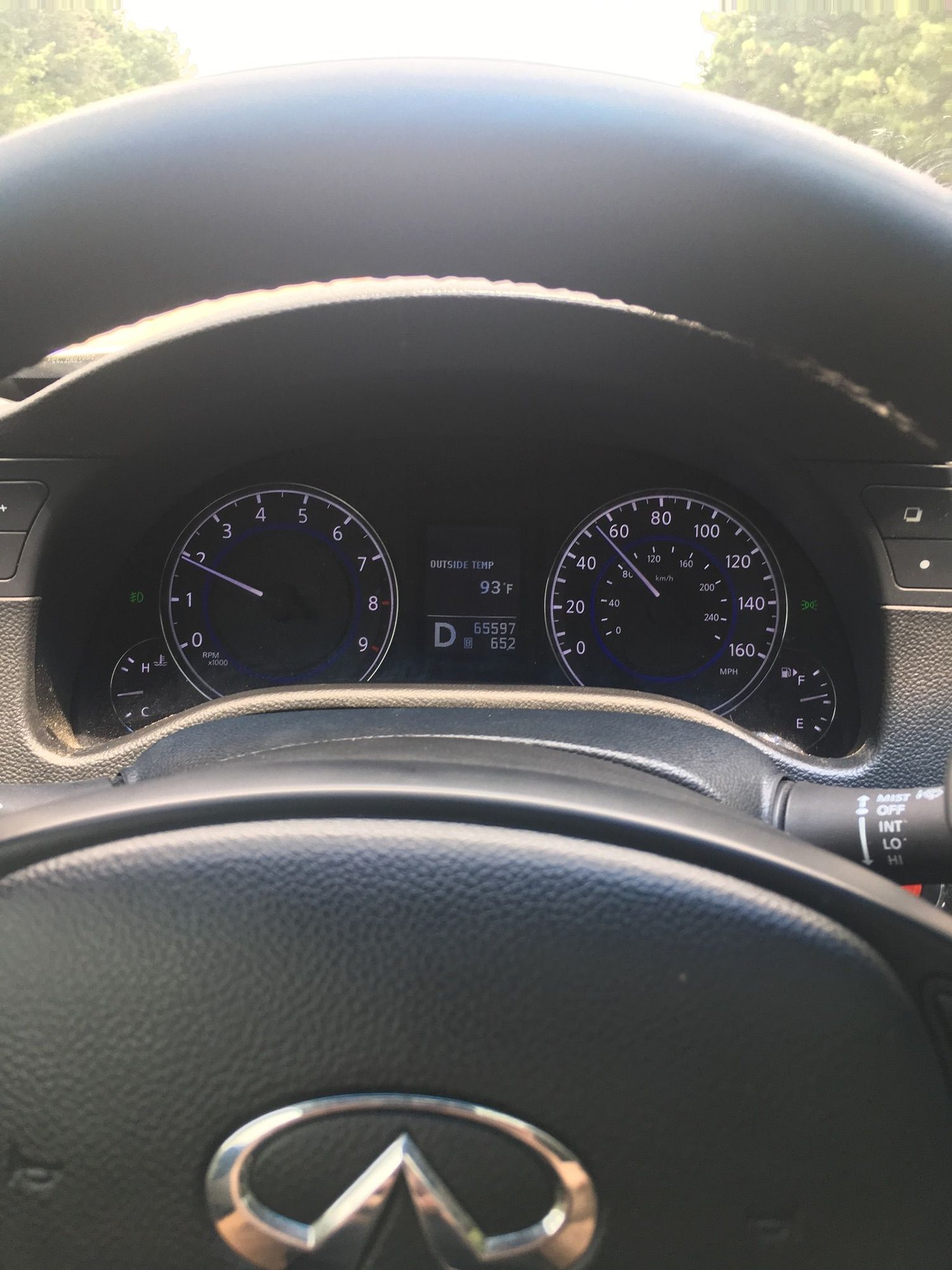

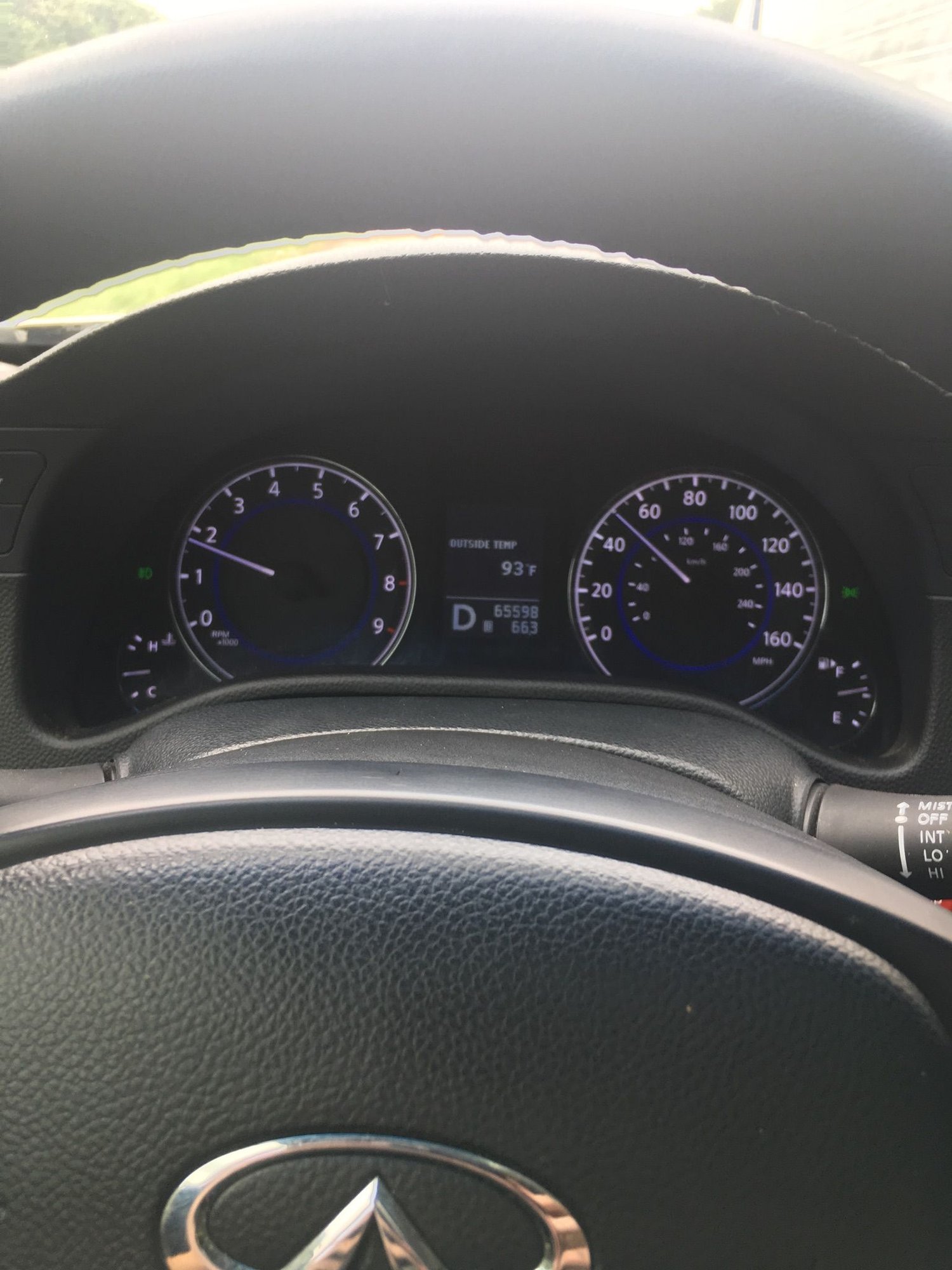

Planning on getting a few more pictures of rpm at 40mph, 45 mph, 75mph, 80mph. That would make a comple log for people interested in the 3.69 gears. 40mph to 80mph cruising rpm in drive. Idle
Rpm at 70mph
Rpm at 60
Rpm at 55
Rpm at 65
Rpm at 50
