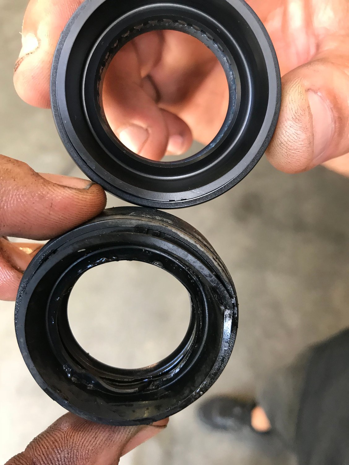

Forgot to mention y’all, I have the car back and I have been driving it putting miles on it! No leaks or issues and I’ve checked religiously. The issue that happen was the seal on front diff was messed up(see pic below I believe it’s called input shaft seal? Could be super wrong). Replaced with new oem seal. Might I add that Justin at royalty performance fixed it at no cost to me no questions asked. Why is that cool? Cause that is 8-10 hrs shop labor each time to get to that seal and put it all back together. Have to drop entire subframe and who knows what else. Have to say, not many people would of done what he did. That would also mean if he didn’t, I would paying for around 16-20hrs labor just to get front diff situated. They didn’t have to do what they did, but the fact they did is incredible. Also that seal leaking isn’t something they caused. I bought a 10 year old used g35 diff off eBay.
