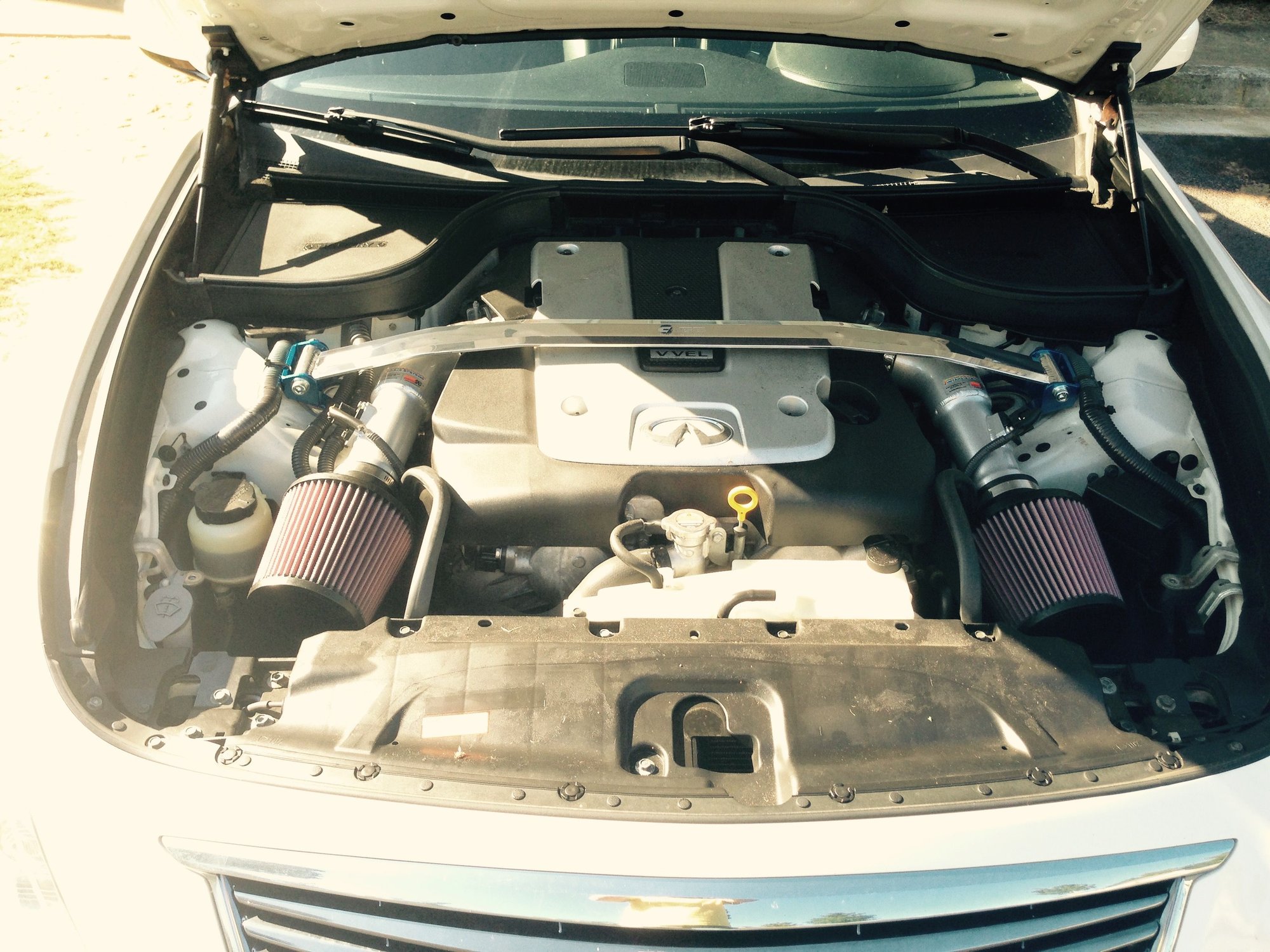

-3 inch intake w/ vstack

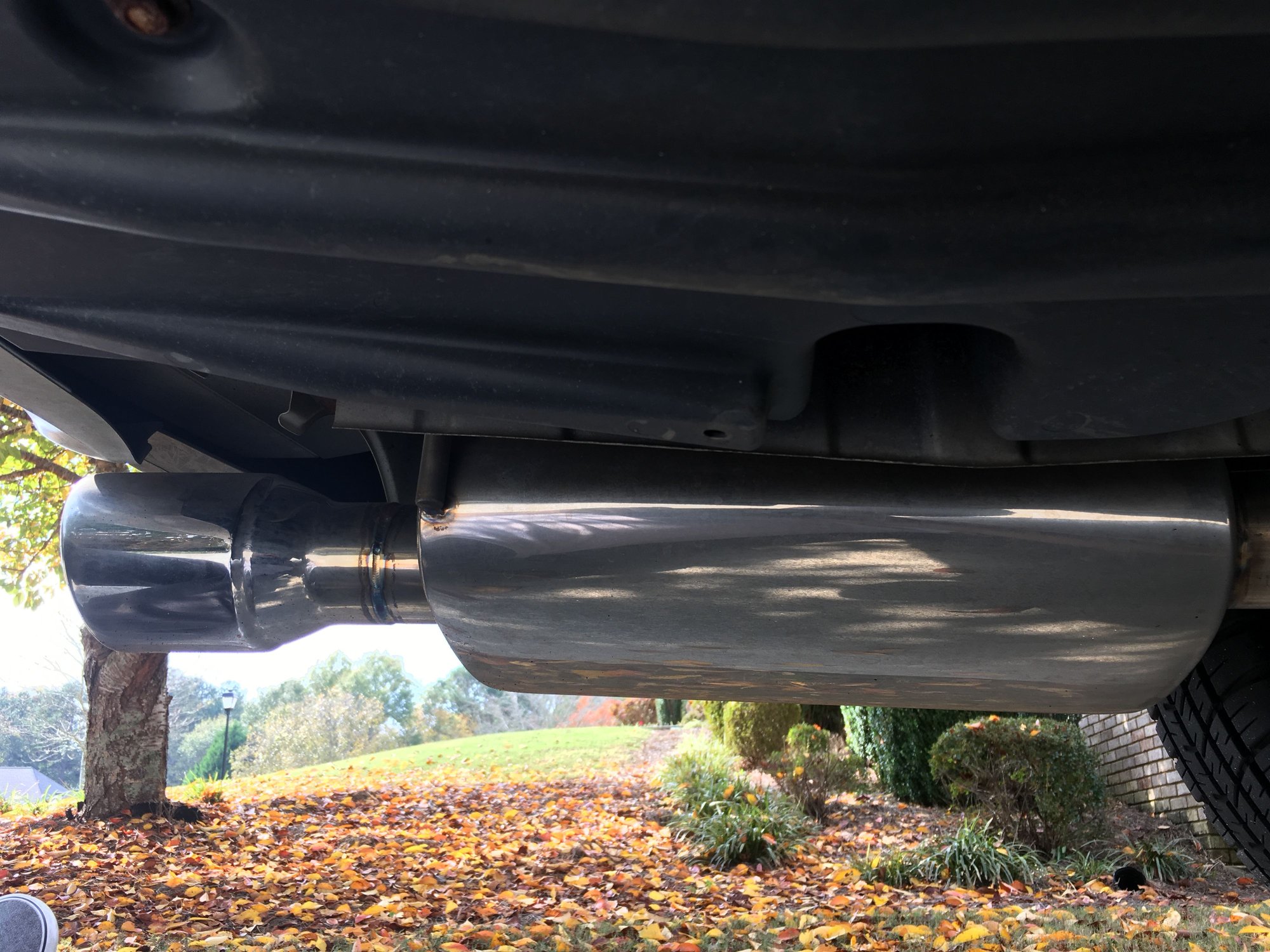

-Soho motorsports y pipe (2.5 into 3 inch)
-Soho motorsports single exit (3 inch exhaust)

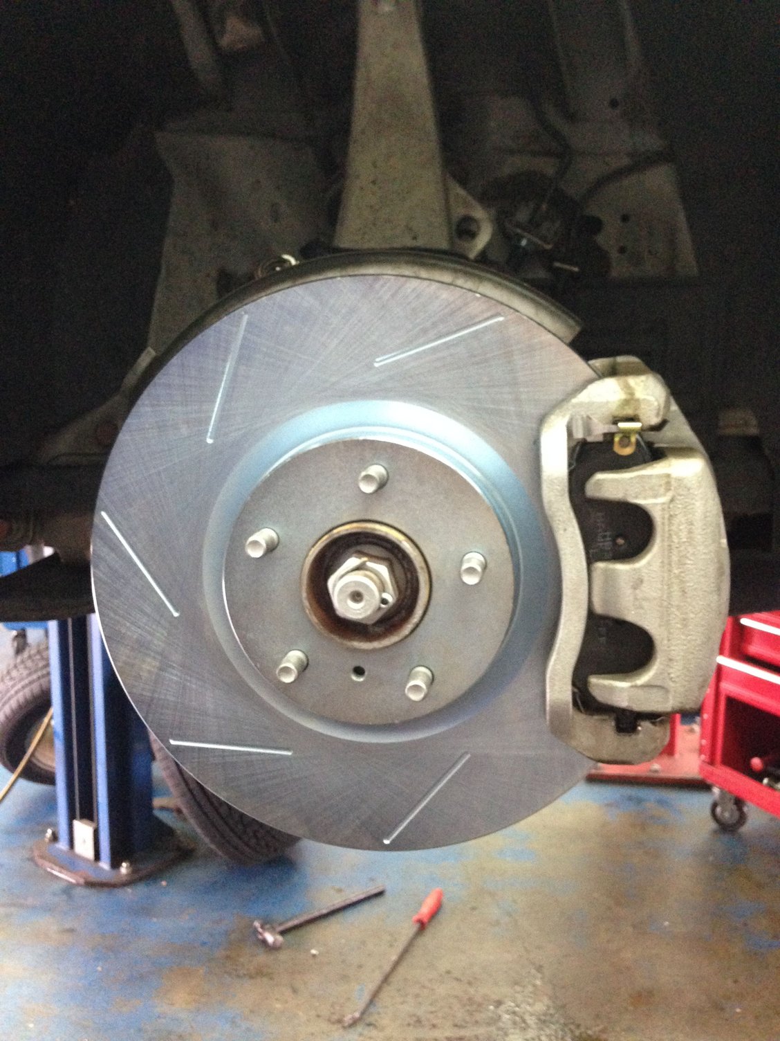

Brakes
Carbotech 1521 pads
Z1 motorsports - Slotted rotors
Z1 motorsports - Master cylinder brace
Z1 motorsports - Stainless steel brake lines

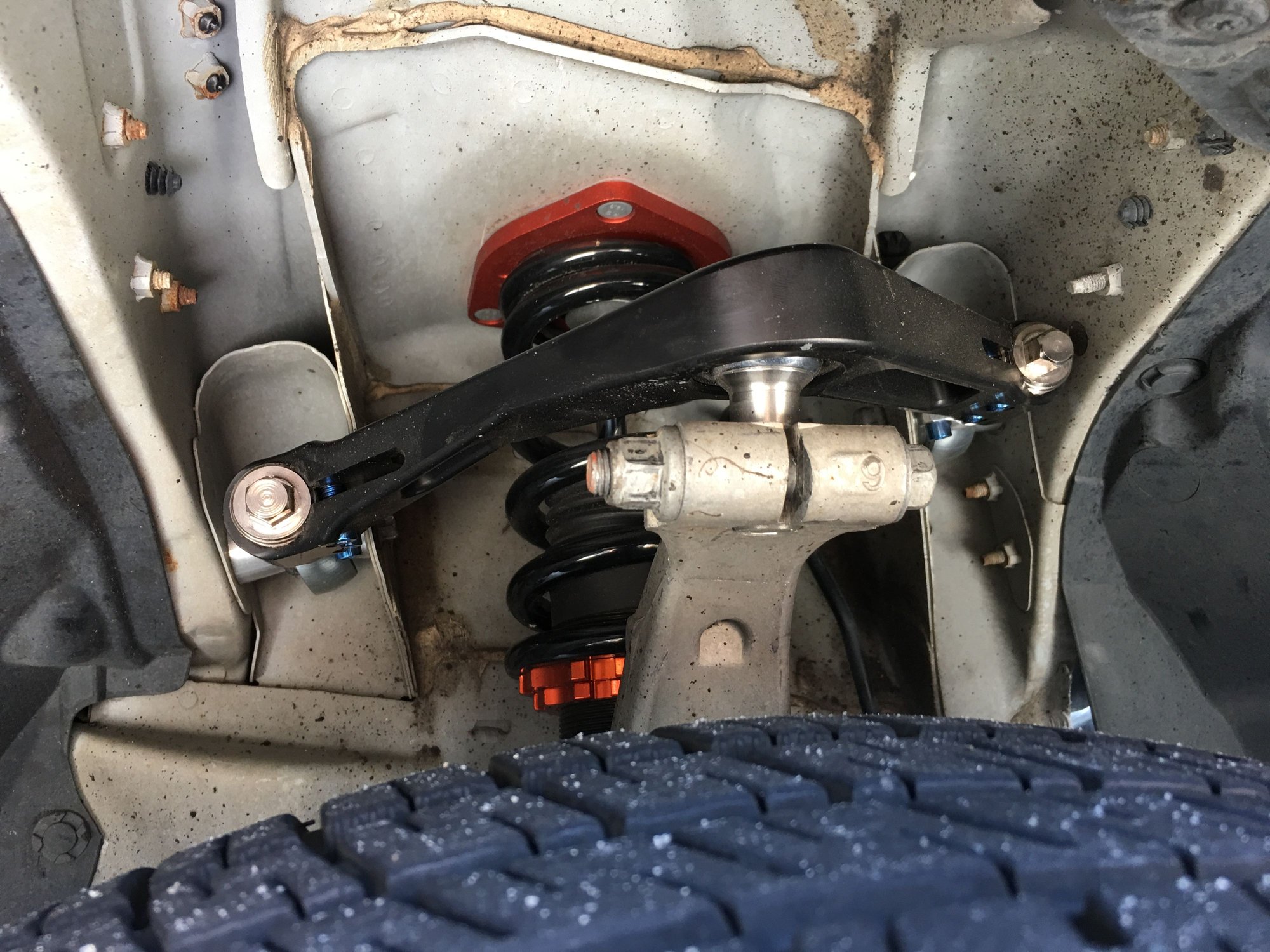

Feal 441+ coilovers (Swift 12k/5k spring rates)
SPL - Front/Rear end links
SPL - Lockout bolts
SPL - Rear camber arms
SPL - Rear toe arms
SPL - Front control arms
SPL - Rear traction arms

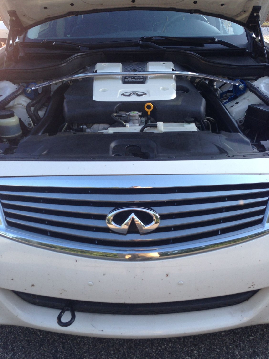

Oem tow hook (painted black, blends in you can’t ever see it. I also cut a hole in the trim piece that fits around the oem tow hook that finishes off the lower grill)
Oem midnight black front grill
Paint matched engine cover

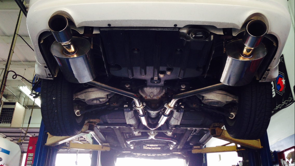

Fast Intentions 2.5 inch exhaust. 18 inch resonators.

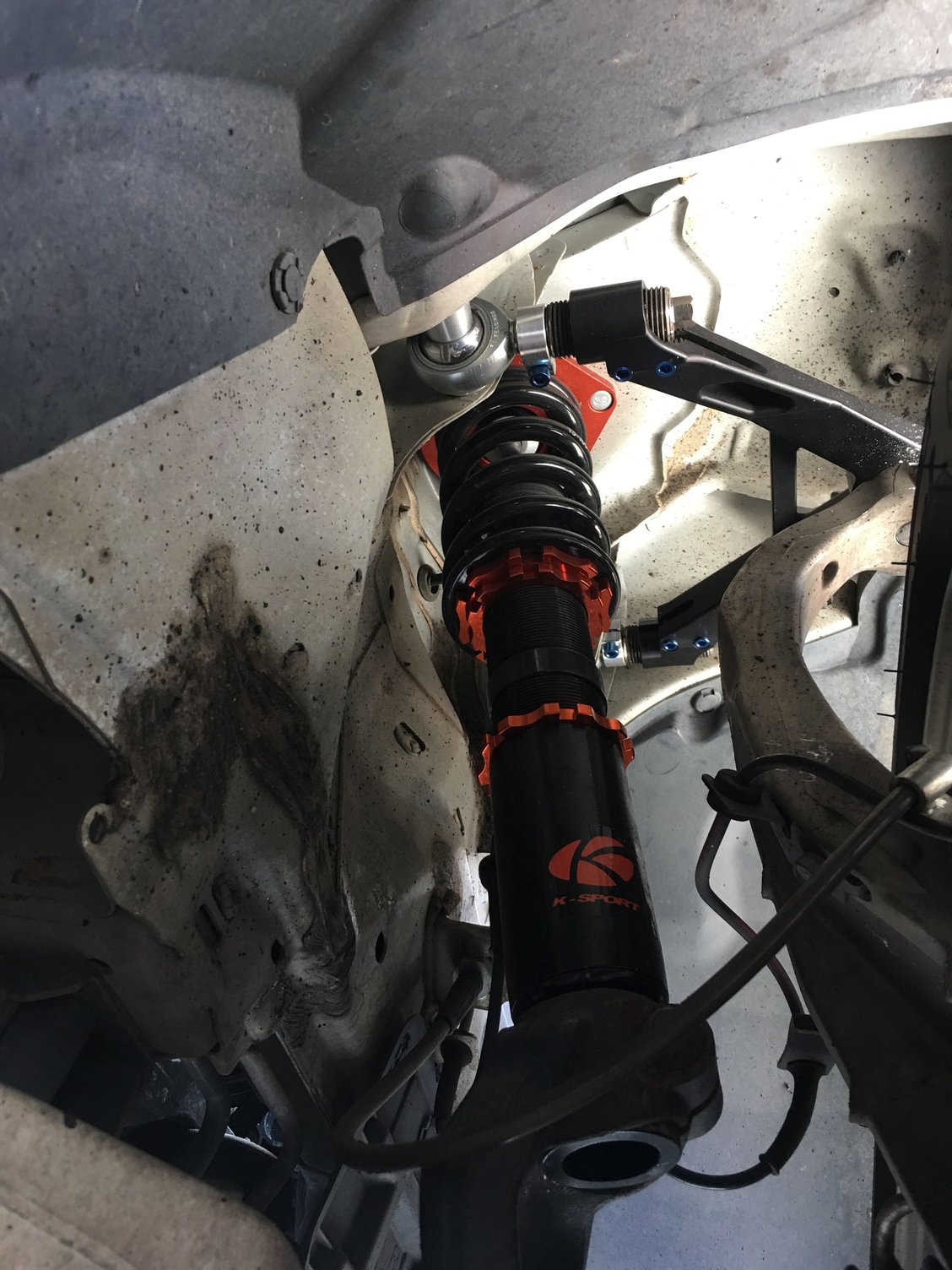

K sport coils
K sport coils and spl front control arm
Spl front end link

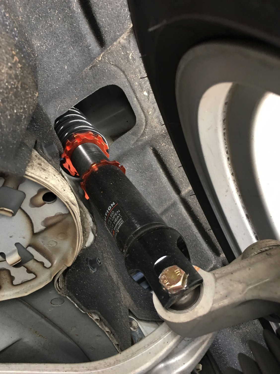

Rear toe arm. Deleted the spring bucket on both sides.

Oem tow hook painted back with hole dremeled out. Planning track day soon
Got the engine cover painted color code QAA (moonlight white)

Originally Posted by bigmike35nj
What's your impressions on the z1 intake?
I have no dyno results with it on but I came from the k&n typhoon. I like it a lot for me I knew it had to be a long tube intake. This was my setup before I swapped them. I recommend them or any long tube intake.
Old Apr 19, 2016 | 09:01 AM
Mattlorentzoe's Avatar
Mattlorentzoe
Joined: Jun 2015
Posts: 773
Likes: 157
From: Gwinnett County, Georgia
This was before the z1 intakes. The sound is better with the z1. The k&n had a whistle noise to them I hated that
