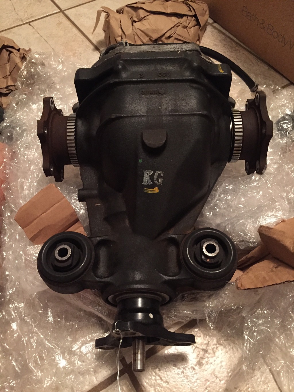

VLSD + final drive DIY and review
https://www.myg37.com/forums/d-i-y-i...-3-69-1-a.html

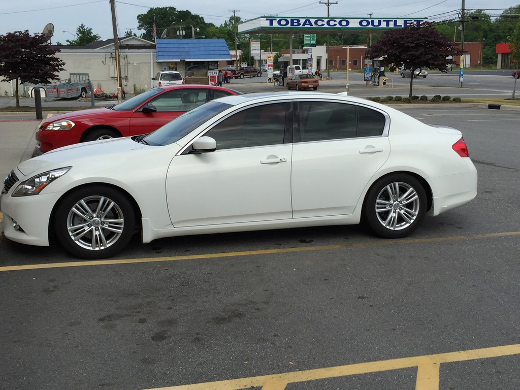

When i bought her

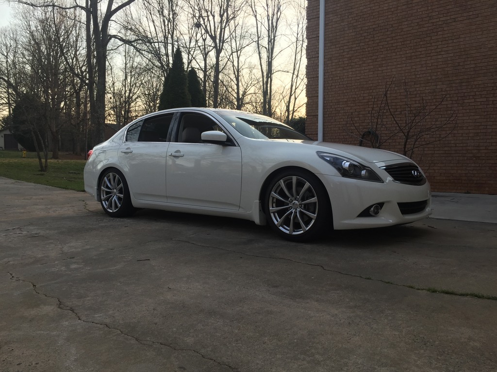

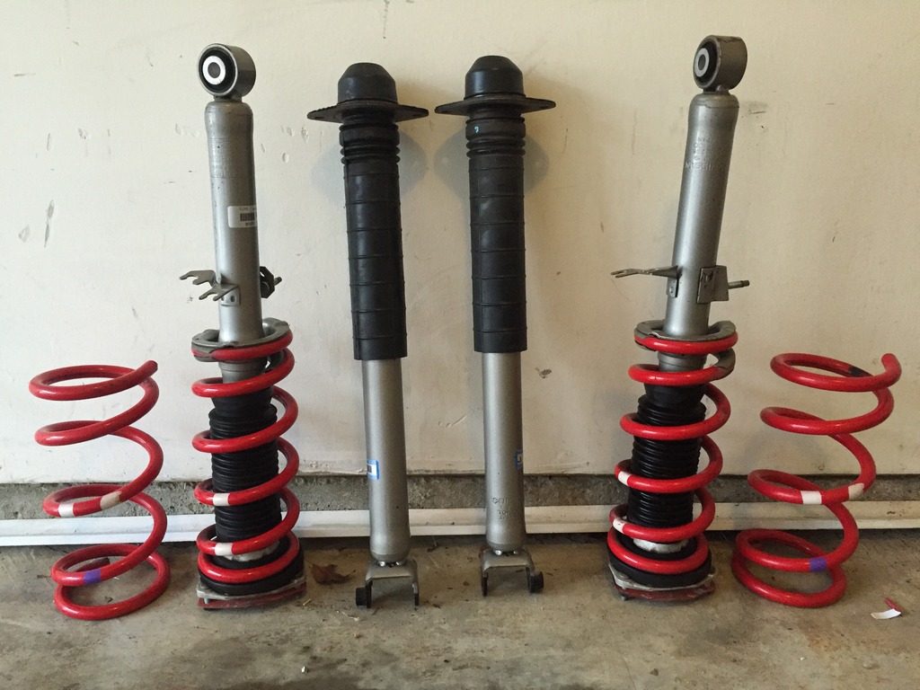

Eibach springs and Godspeed Sway bars

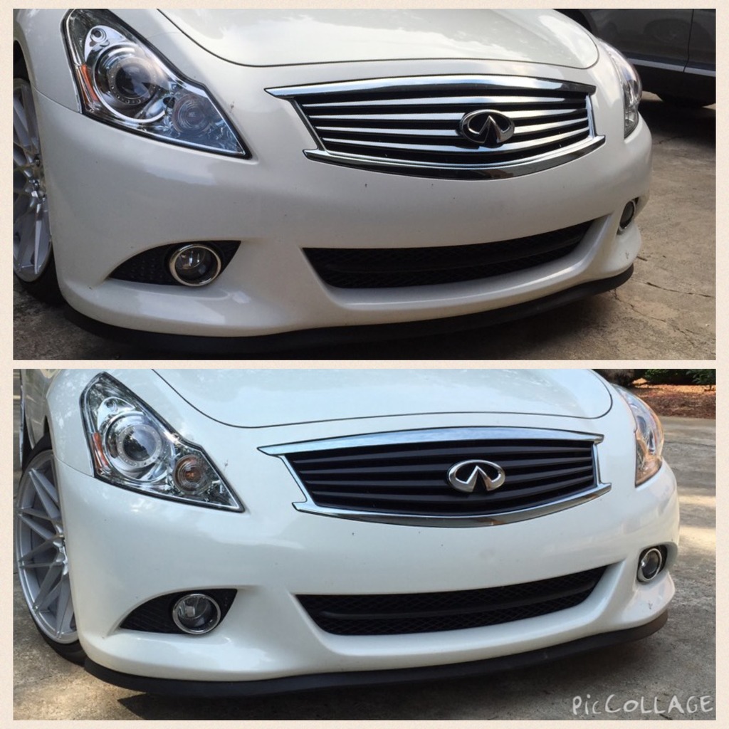

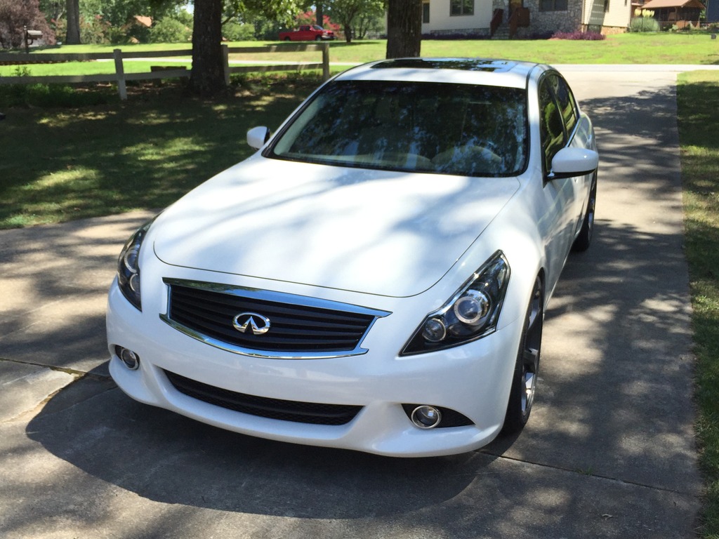

Klutch KM20 19x10 +40/+45 and Center grille black out
VLSD and Whiteline bushing swap

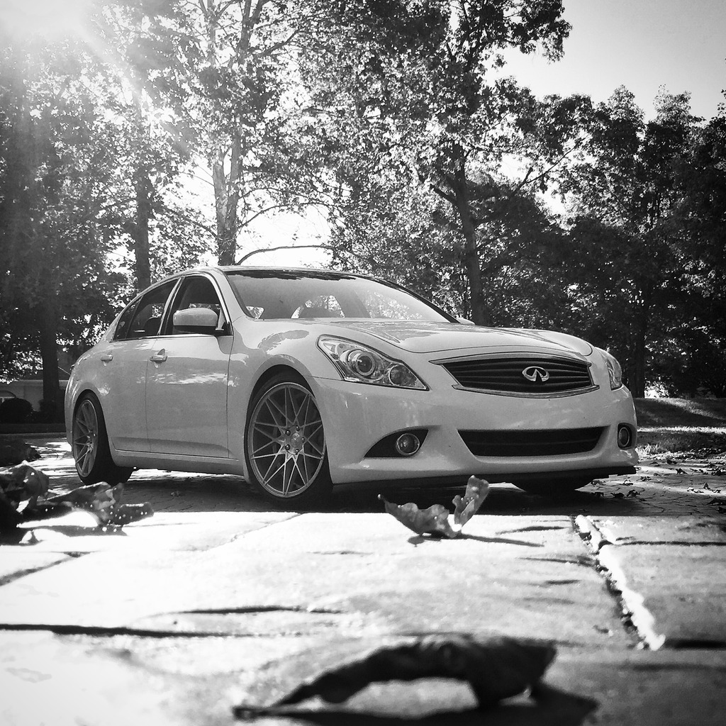

Enkei RPF1 19x8.5 +42 Square

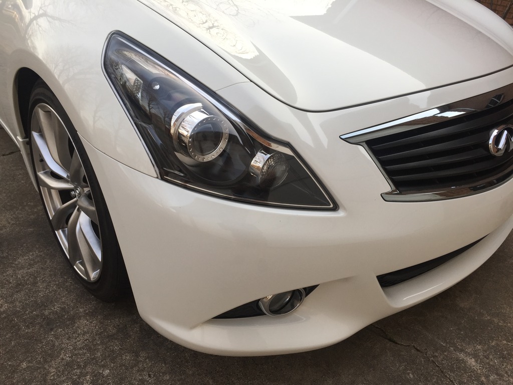

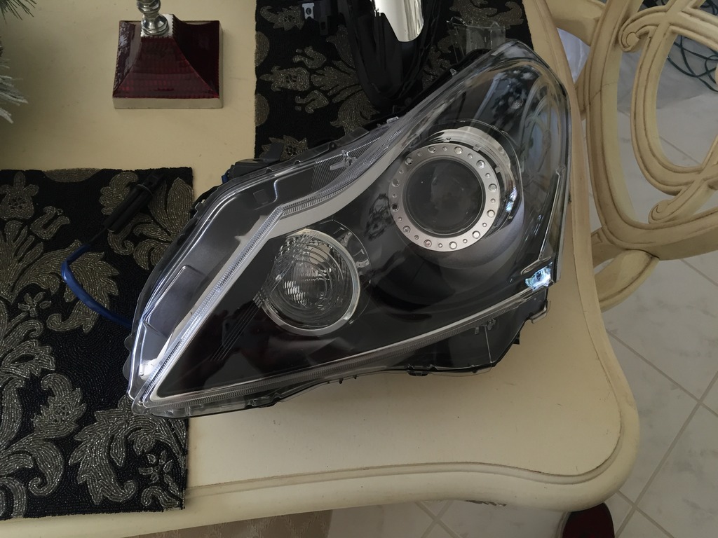

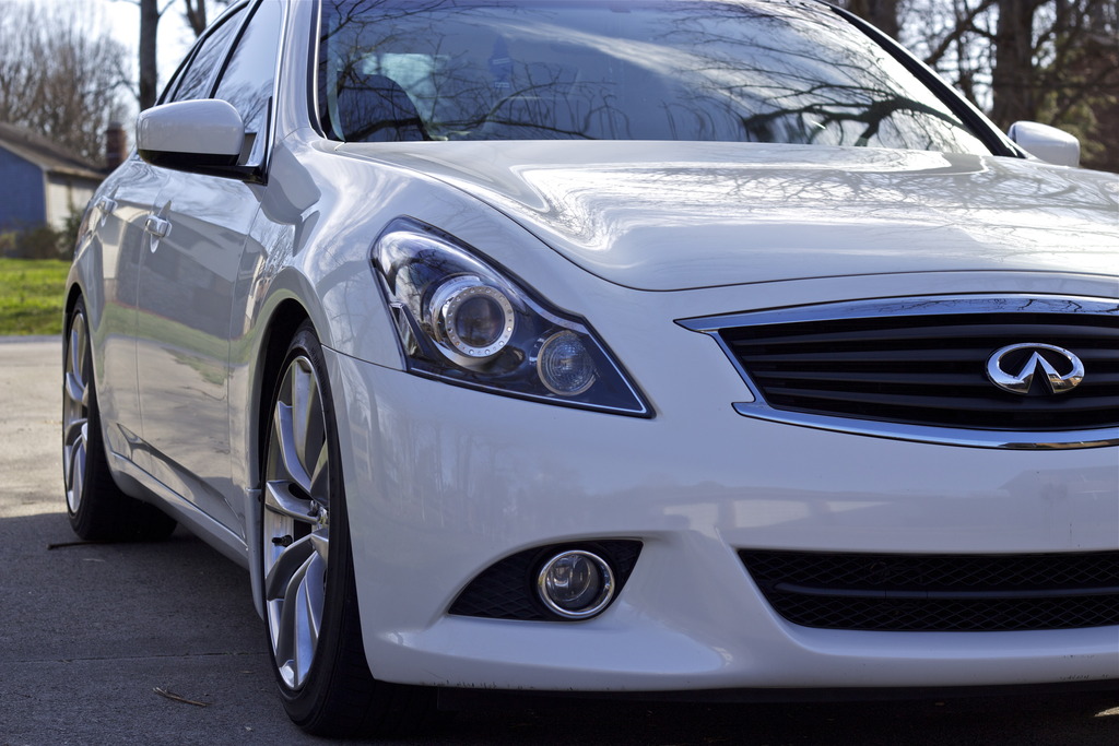

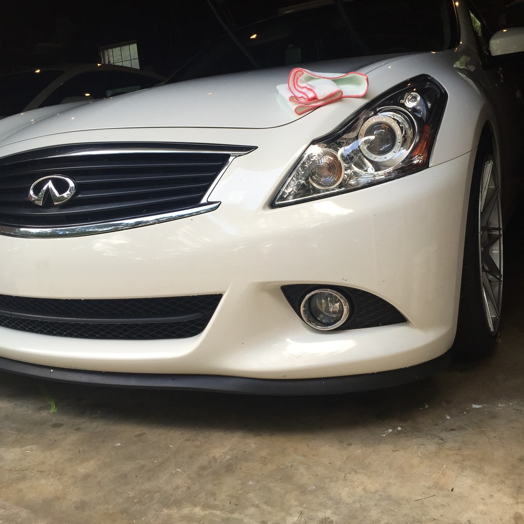

Black housing Headlights

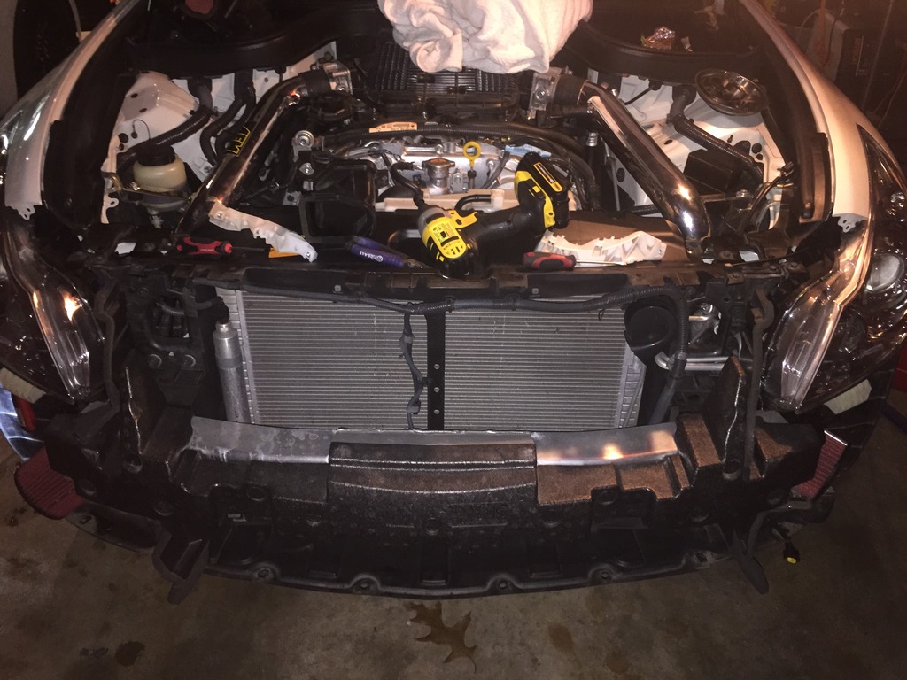

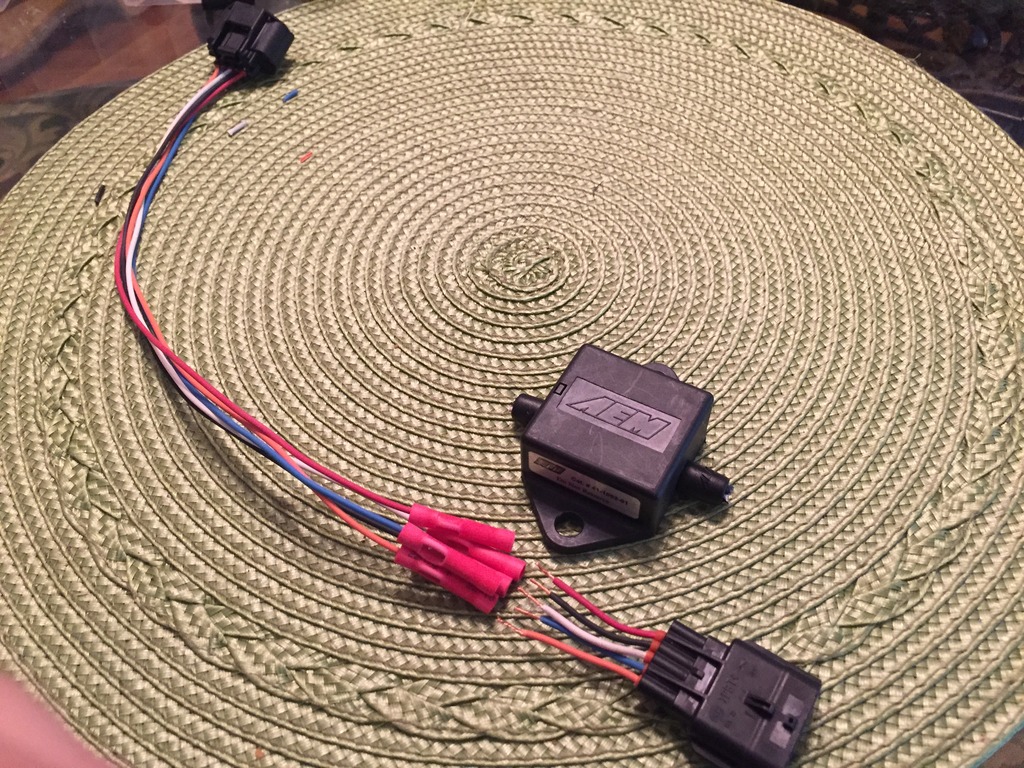

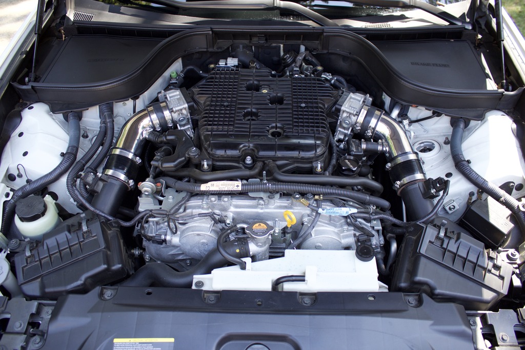

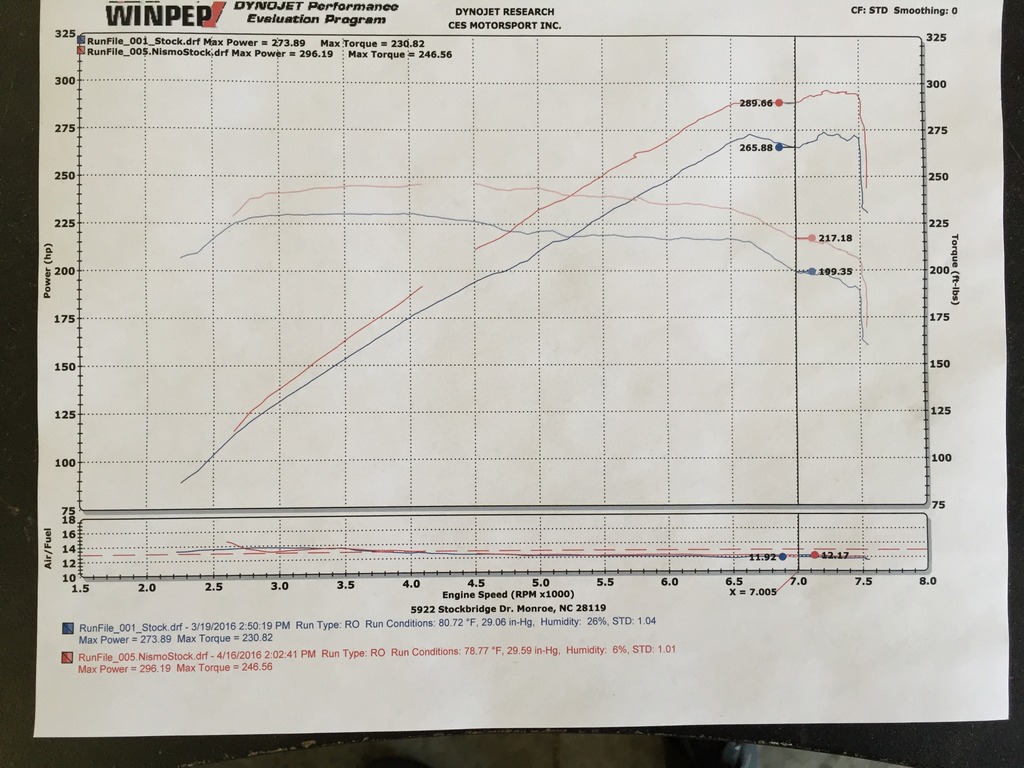

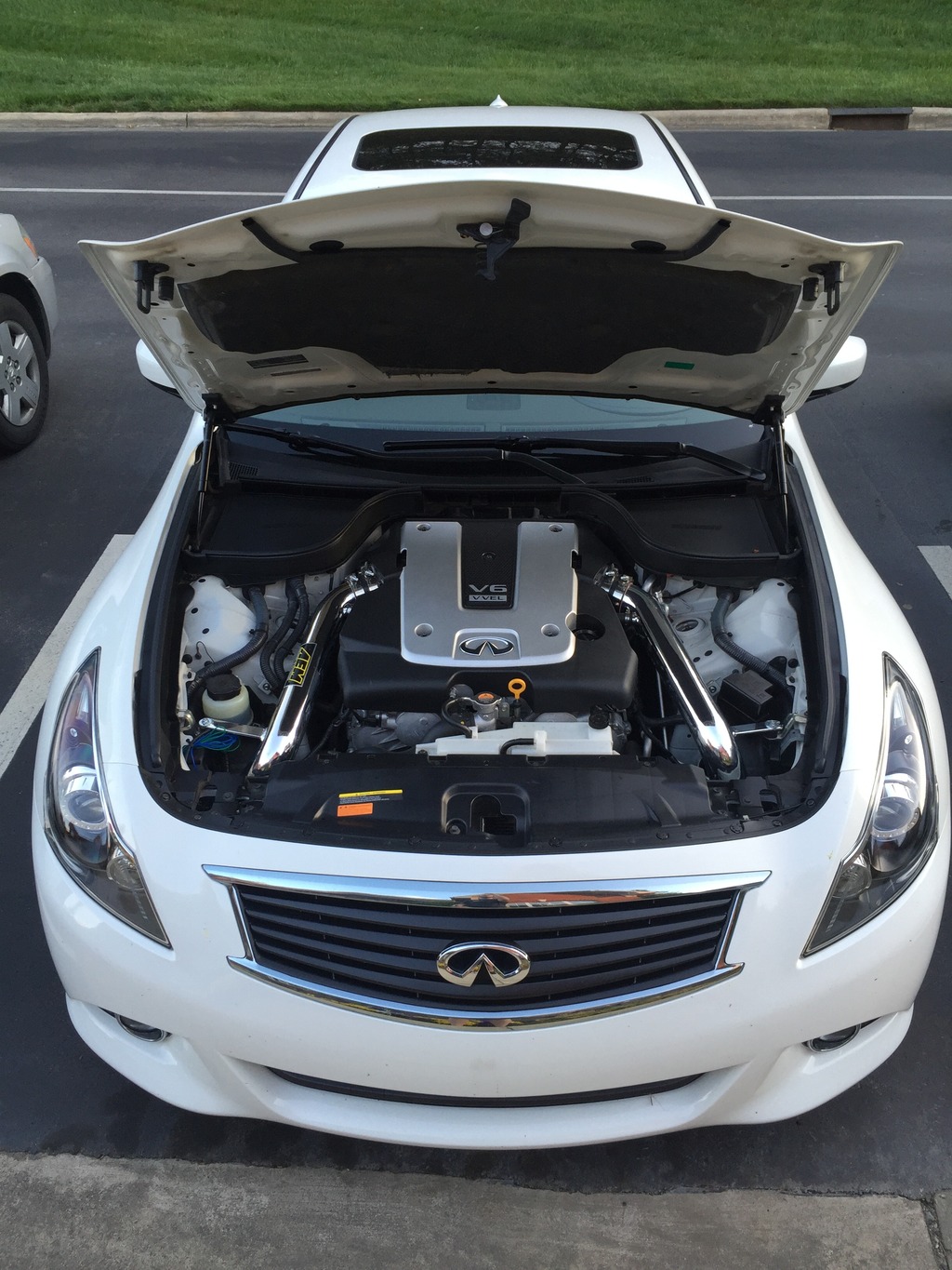

Aem intakes (came from 370z nismo. No choke point at the MAF)

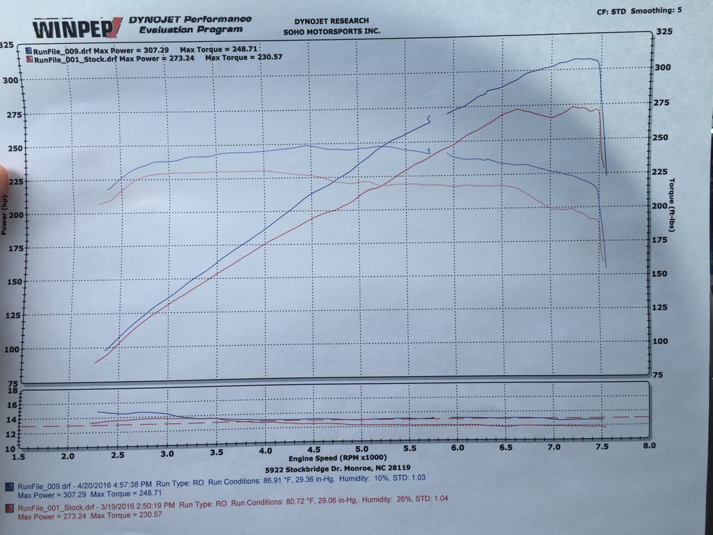

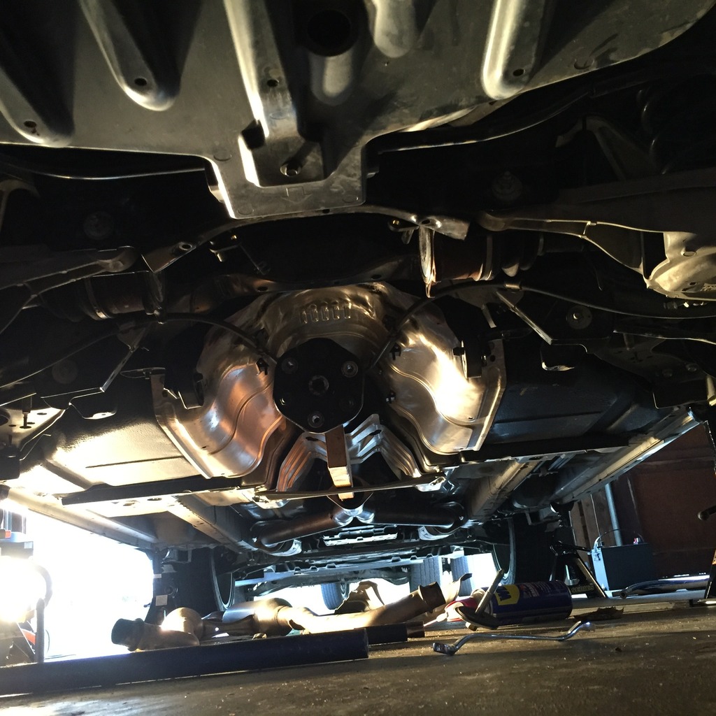

So with the exhaust I put down around 295. I added the intakes and the car jumped to a ridiculous air to fuel ratio of 15.5 by 4500 RPMS which means.... They flow. A lot. lol so I ended up flashing EcuTek to make them work. After adding the intakes and tune it made an extra 12hp which is pretty good I guess. This is with stock cats too. So I believe they are now the choke point. There is no way that the intakes are the restricting factor anymore. So mods are:
AEM long tubes
Nismo 370z H-pipe
Nismo 370z mid pipe
Custom 2-1/4 inch axle back.

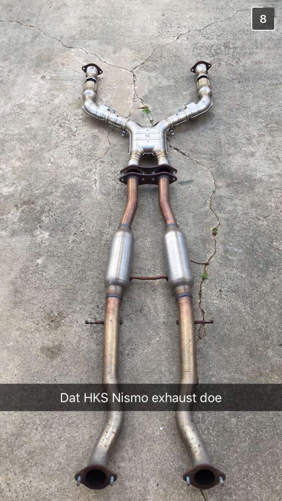

Nismo H-Pipe and Mid pipe for “custom" exhaust build (dont mind the inside joke on snap chat)

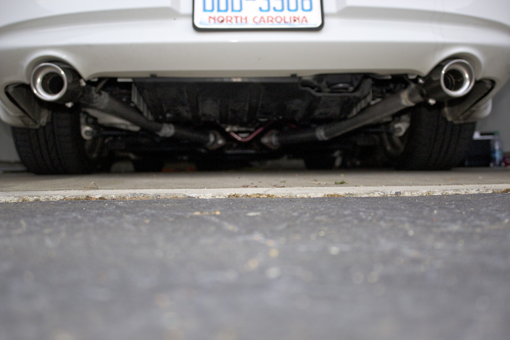

I (almost) finished making my exhaust this weekend. I still have to order mufflers, get it powdered and get resonated tips. heres what it sounds like with just resonators. Don’t expect anything amazing below… lol This is my first time and I learned that building exhausts on your back and trying to tack with your eyes closed because your harbor freight mask doesn’t fit under the car really sucks a$$ lol
https://www.youtube.com/watch?v=s47L...ature=youtu.be
Fitment:
Underneath: (had to increase the shadows feature where the piping would show. the light sections are where I wire brushed before and after welding. pretty happy with the turn out. order some 14in round magnaflow mufflers and I’m still looking for tips.
Dyno results and video: no tune just CBE exhaust...

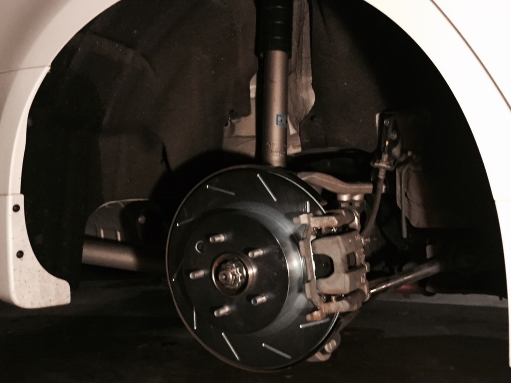

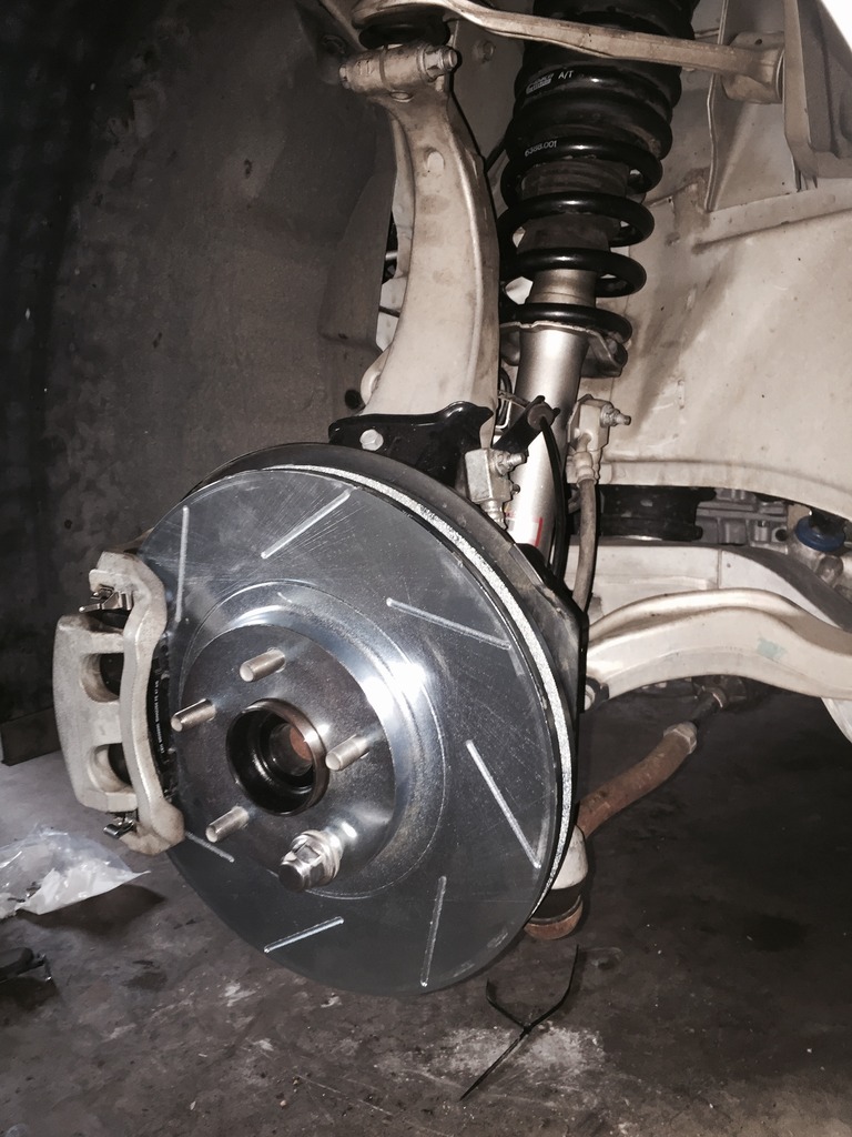

it was time for some brakes so i ordered a Package from z1. It was money well spent for sure!! link below
https://www.z1motorsports.com/brakes...ge-p-4671.html
While doing the brakes i also swapped in some 370z Nismo struts/shocks while keeping my eibach springs.

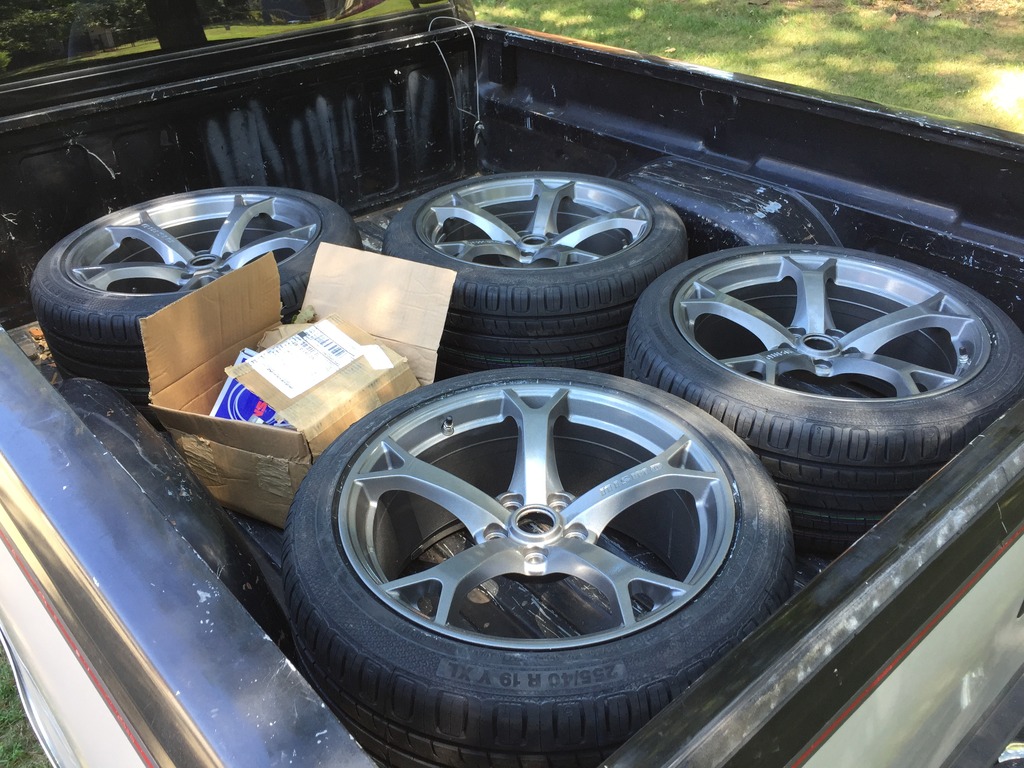

Sold my square setup of coupe wheels and finally finished the square nismo wheels I put together. also painted the trim piece on the trunk to match the wheels. I think it all came out a little better than I expected.
19x9.5 +40 255/40/19 square
Mixed jet black and sparkling silver to get this color. Came out a little darker than I wanted but it will do for now.
