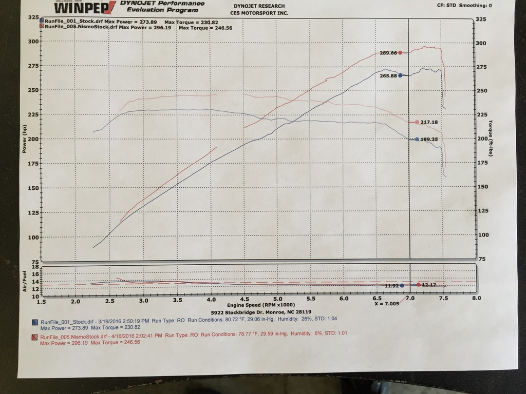

Dyno results in
Here's a little dyno video of the exhaust. Getting a tune along with some AEM cold airs on Tuesday morning as for the exhaust gains. Well, we were pretty surprised. The sound and gains def made it worth the time I spent.

Wow, count me as impressed w/ those gains, that Nismo Hybrid Y-X setup looks like a great combo. You might cause those parts to fly off the shelves :P)
Old Apr 17, 2016 | 12:34 PM
Those gains are A LOT more then what I would've expected I'm honestly in shock! Thanks for posting that picture bc I probably wouldn't have believed it without seeing it! Great freaking job Gregor!
Lol I didn't think about that. And I'm der impressed. I was expecting 10-15. Even nik at soho was like wtf!?? I honestly think it's because of the H-pipe and then it's all 2.25 until it comes out the bumper. True dual ftw
Thanks man I appreciate it. I also am in shock so was soho Motorsports haha
