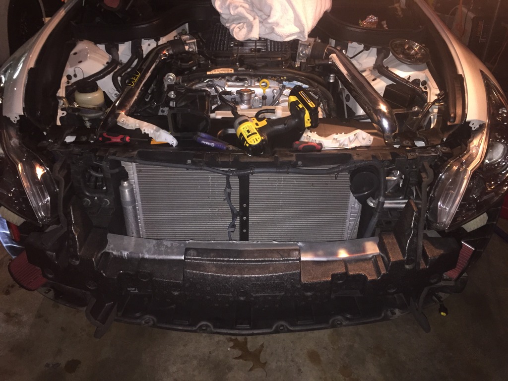

Surprisingly, it was not that difficult to make these fit. And when I say fit, I mean fit without any issues or contact of other parts. I had to cut the lower bracket off of the driver side intake and then it bolted right up using the factory intake mounts up top (still need to make a mount down low). The left side wasn't bad at all but I had to remove the washer box and make a mount for the lower bracket. So here they are. Bolted up like they were made for the vehicle. I tried starting it with the MAF modules for the 370 and it would not run right (just wanted to check idle).

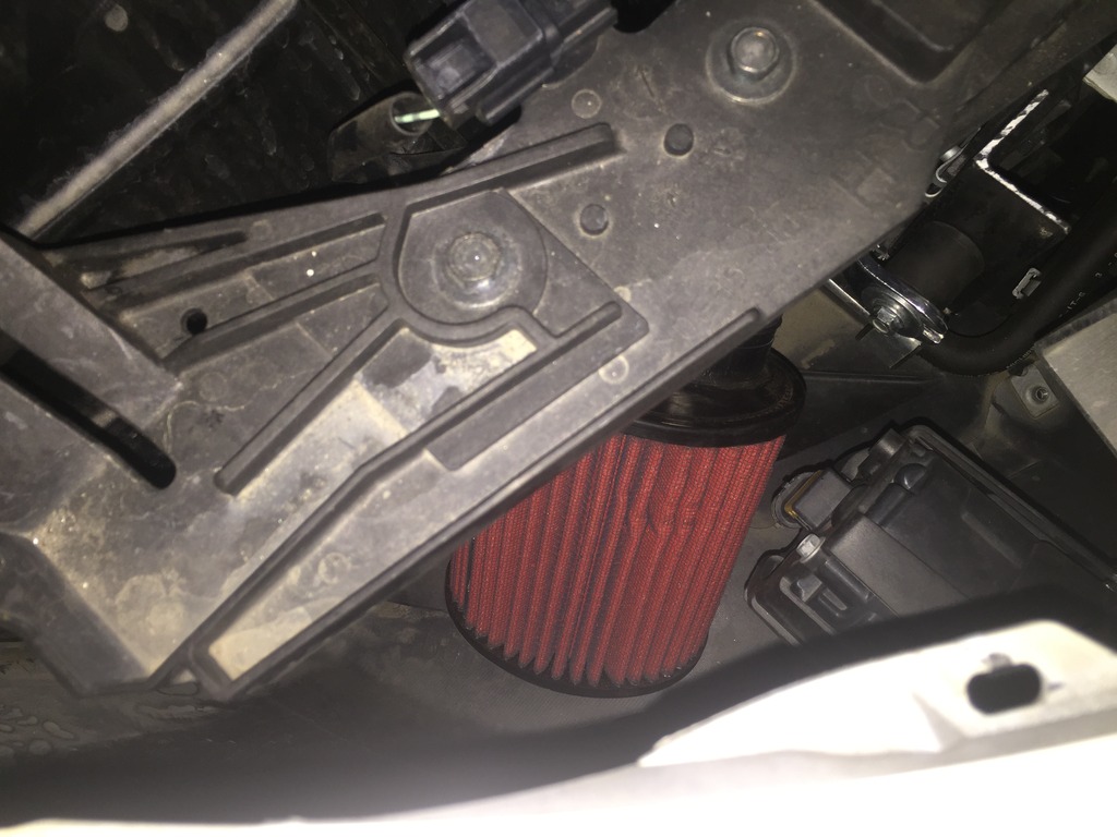

Custom mount for the bottom bracket can be seen here at the top right corner of the picture. Used a thick 90 degree metal bend, bolted to the front clip, and then reaches to the intake with an isolation mount.
Driver size clearance is tight. After more adjusting it was not touching the fog light. Also had to bend the horn mount upwards.

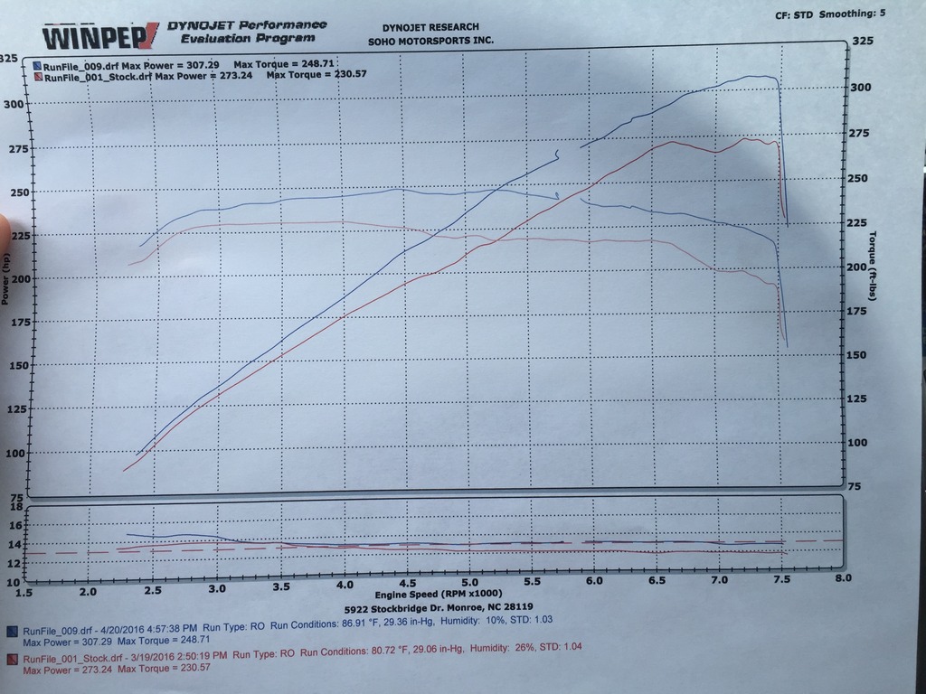

So with the exhaust I put down around 295. I added the intakes and the car jumped to a ridiculous air to fuel ratio of 15.5 by 4500 RPMS which means.... They flow. A lot. lol so I ended up flashing EcuTek to make them work. After adding the intakes and tune it made an extra 12hp which is pretty good I guess. This is with stock cats too. So I believe they are now the choke point. There is no way that the intakes are the restricting factor anymore. So mods are:
AEM long tubes
Nismo 370z H-pipe
Nismo 370z mid pipe
Custom 2-1/4 inch axle back.

Is the dyno sheet before or after you got the lean AFR corrected? It looks like after, but just wanted to double check.
Great gains under the curve if so!
Also, I really like how those utilize the stock airbox mounting holes. Wish my Stillens had that.
Where do the MAF's go?
Mafs are Down near the filters. Came with extensions that go in between the mafs and the stock clips.
I don't have a graph of just the intakes. I tried my best to get the car tuned with just the intakes but it didn't work out. The graph is bone stock vs intake, exhaust, and tune. Before installing the intakes. The car made 296 and 237. But that was also in colder and less humid weather. So after correcting the AFR the car picked up 11hp and 3ft/lb and made 307.
