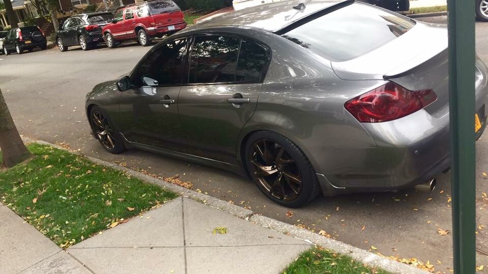

Here is LEGEND one PIC ONLY.

I've been looking at that also.
BTW nice color car. Same as me
