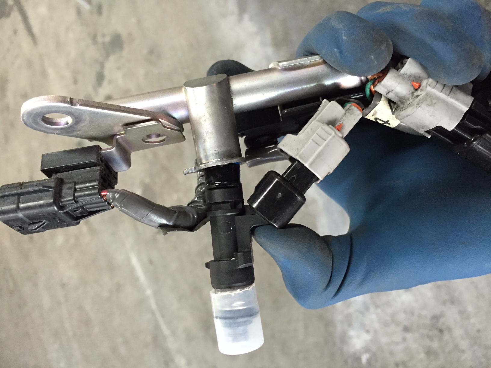

Injectors connectors
Had a few delays with my built. The Injectors connectors For the DW 1000cc's was touching the Fuel Rail. Therefore I had to obtain another set that is compatible for the G37.

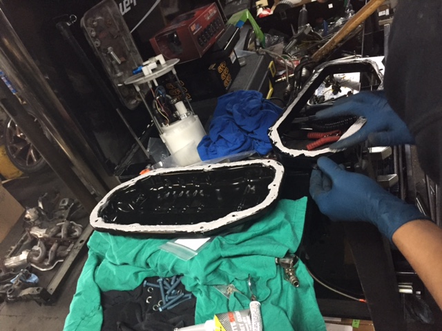

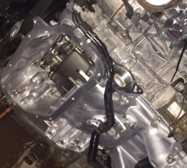

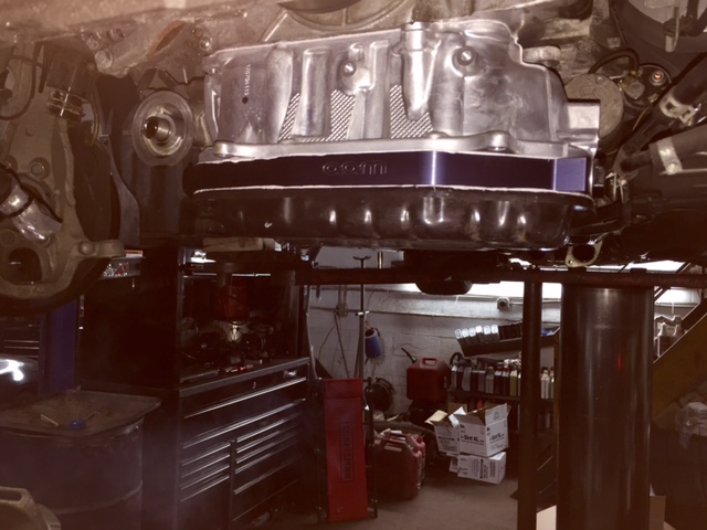

AAM Oil pan Spacer
I was able to capture the rightful way of setting up the Oil pan spacer. Once done right you won't have any clearance issues.
Final setup of the Oil Pan Spacer.

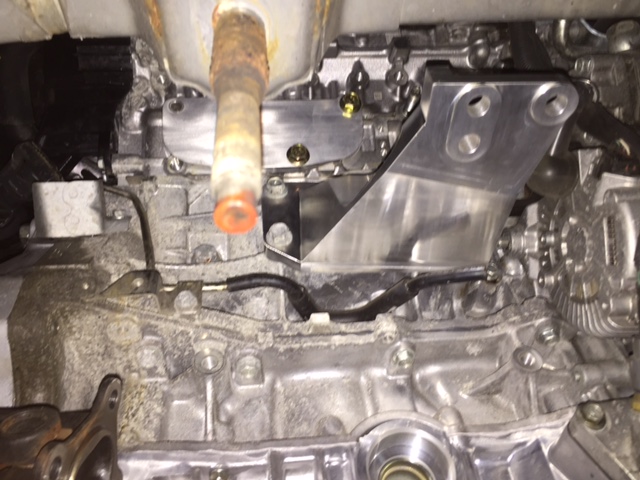

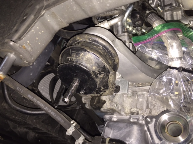

AWD drive passenger head has to be tapped and so the GTM Aluminum template has to be used to correct measurement when drilling so that the passenger side manifold's goes on effortlessly. G37x awd - TT kit-img_1729.jpg
Also here is the photo or the Modified GTM Oil Pan G37x awd - TT kit-fullsizerender-2-.jpg and Engine Mount.G37x awd - TT kit-img_1730.jpg

Nice progress, glad you were able to that oil pan out of harms way. Thanks for providing detailed pics.
