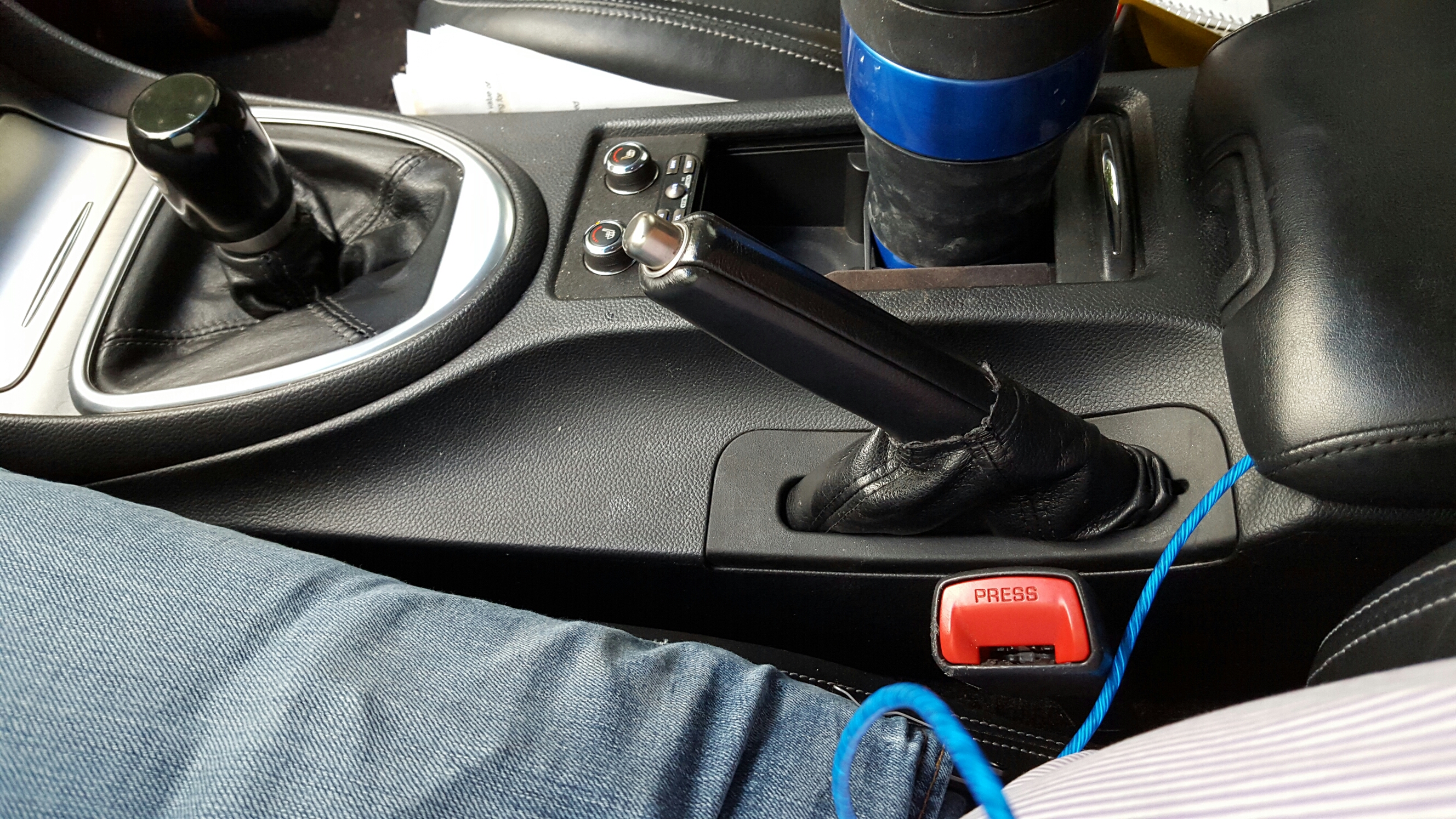

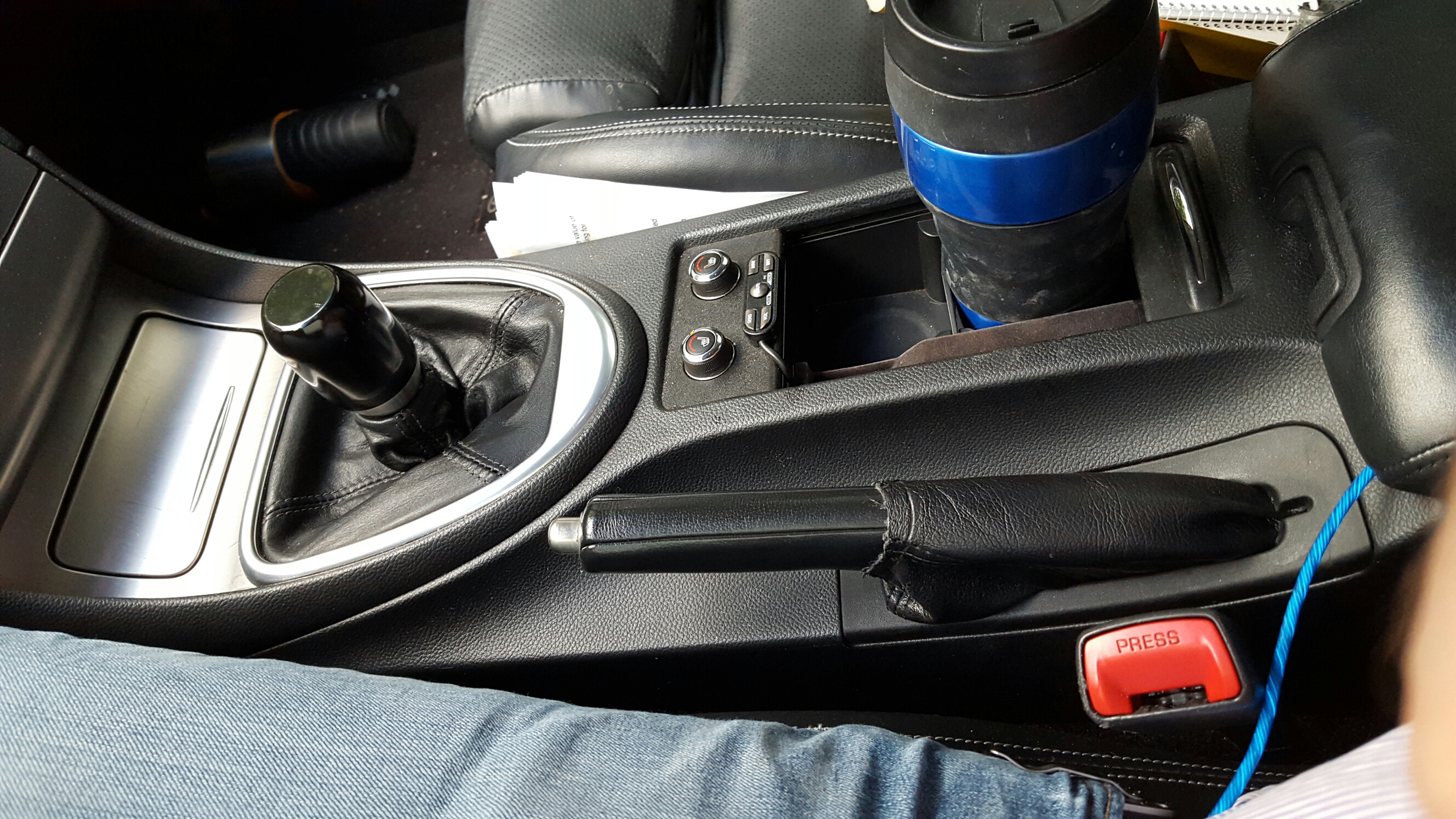

So i copied Rochester and recycled the factory shift boot. Going to see if i can get my girlfriend to fold the "leather" and put a stich on it so it looks better. Until then i used black shoe polish to dye the fabric black.

The OEM boot has four 1" leather tabs intended to wrap over the inner ring and zip-tie. You know what I'm talking about, and from your pics it looks like you lopped them off.
Instead, I inverted the boot, and slipped it on (with WD40, because tight ft) inside-out, pulling it down the handle with those tabs. Then you re-invert the boot over the arm, and you have a reasonable folded-over trim on the handle.
I probably should have explained this first. Sorry.

Yeah unfortunately I cut that. Oh well. She enjoys sowing anyway . Are ypu not worried about the wd40 staining or ruining the handle's fake leather or the boot?

No, not at all... simply wipe it off and clean up. I just needed something to lubricate the fit, because it was so tight.
Been there, done that.

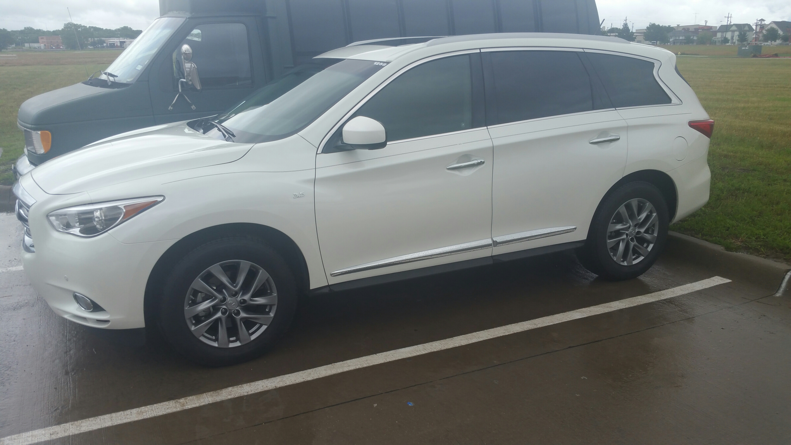

The loaner while mine gets diagnosed. Might be a while. Infiniti apparently had a major recall on the Q54, or whatever the big SUV is, timing chain.
