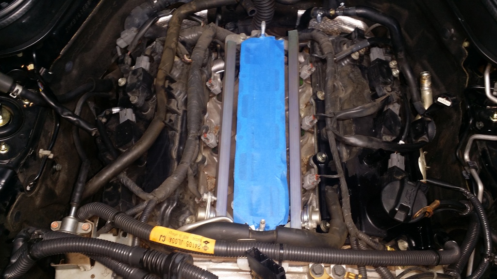

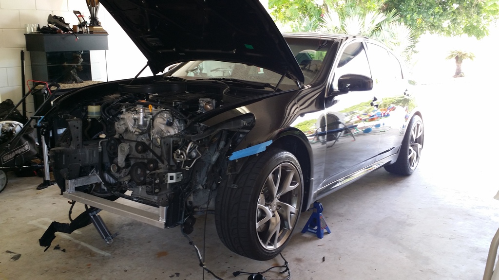

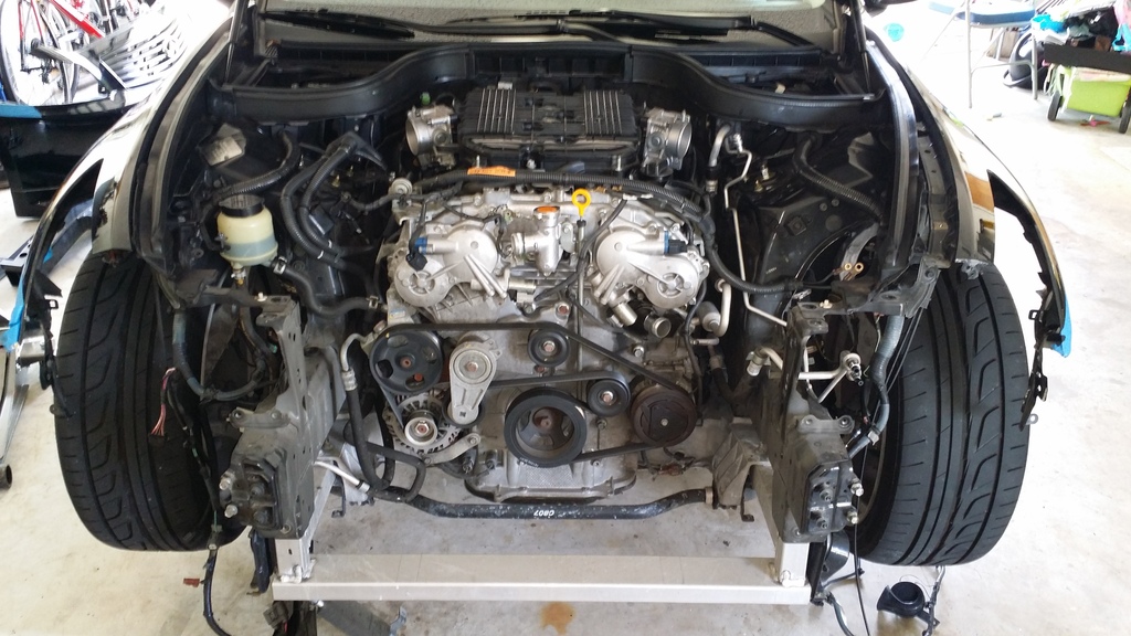

I bought a 350z VQ35HR replacement motor to get it running again. It has 43k miles on it, my car currently has 75k, so at least I'm getting a lower mileage motor. I started the tear down and will document the rebuild as I work on it.

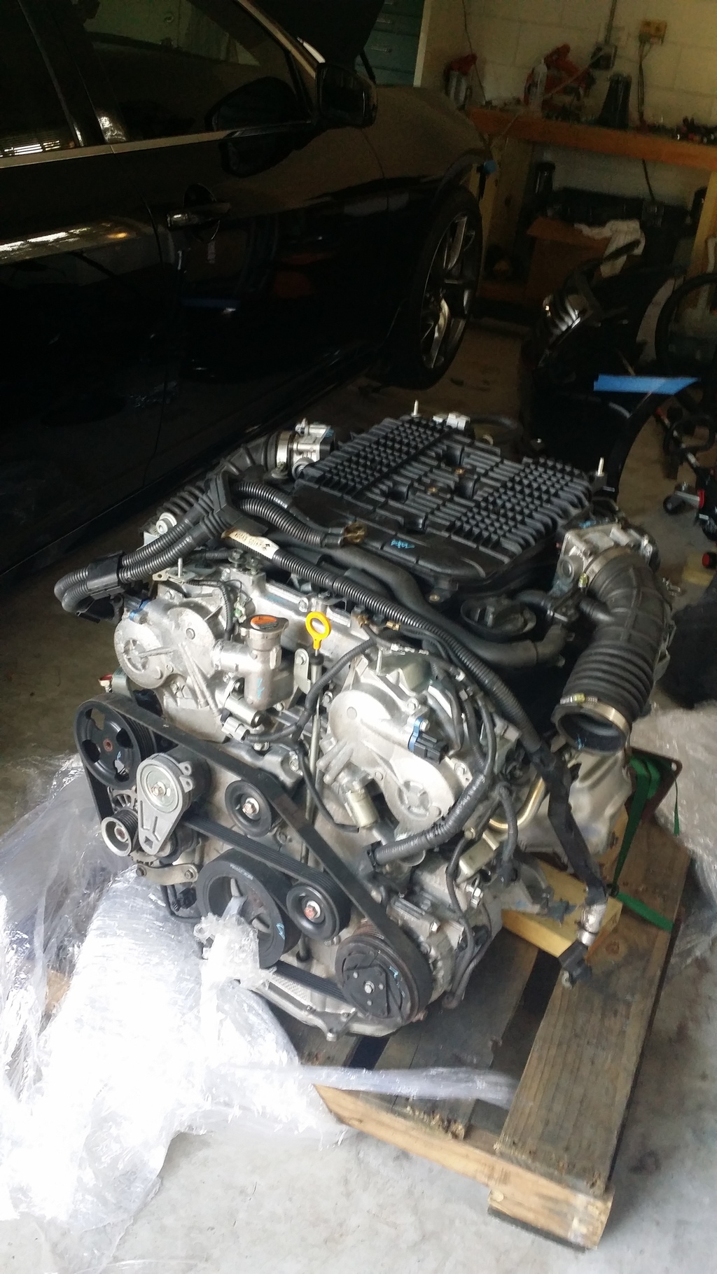

So the new motor arrived today.

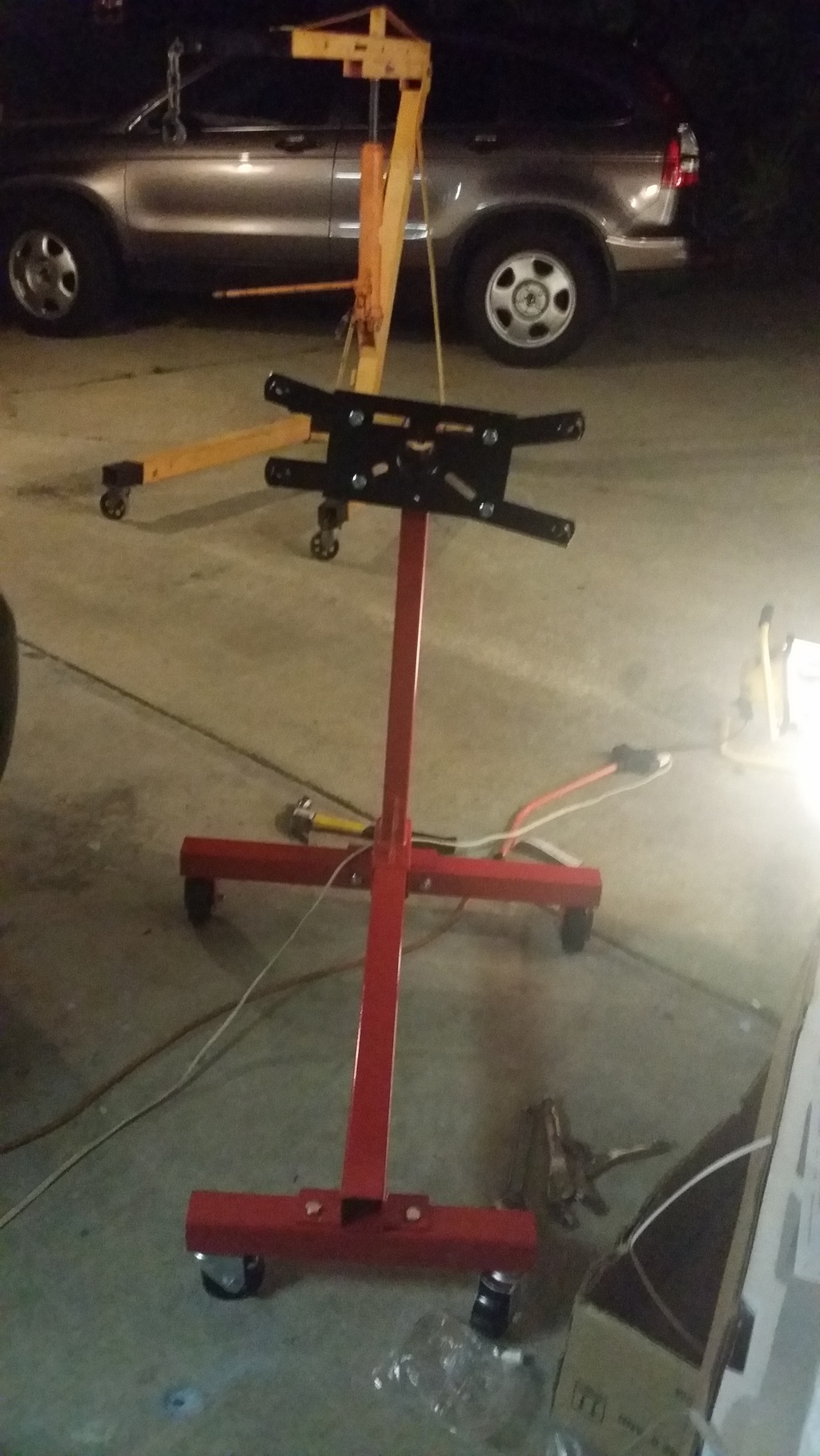

I bought and assembled a stand...
More updates tomorrow as I get the motor out...

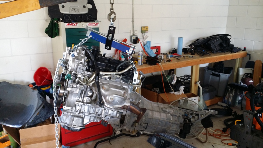

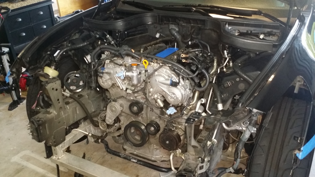

I have a few significant updates...
I got the motor out...I decided to remove it with the trans to make it easier to align the clutch later.
I cleaned up the mess and ordered some Pizza. I'm taking a break.
