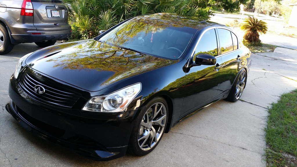

For reference, this was the car before the rebuild...

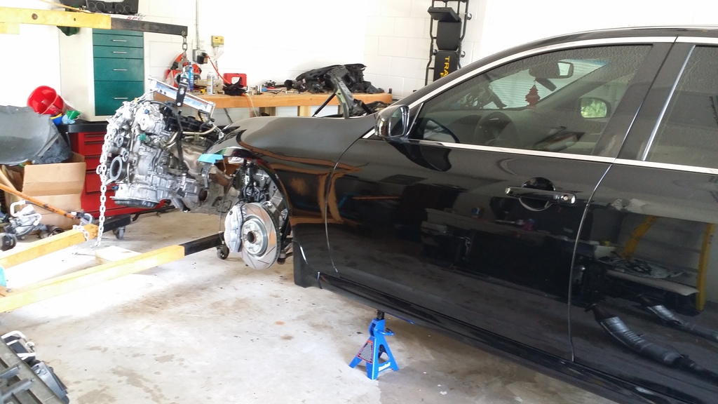

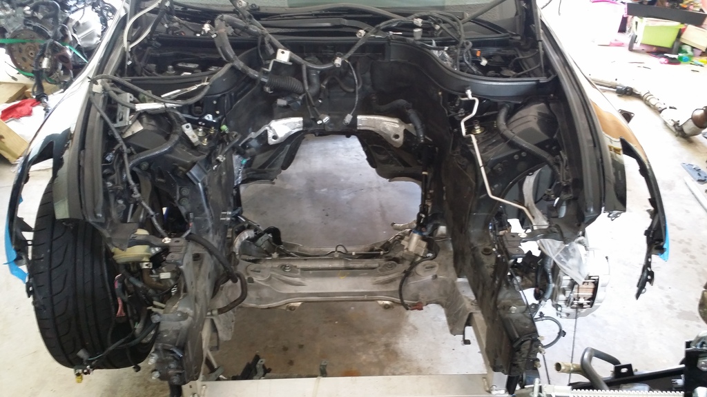

I got the motor out...I decided to remove it with the trans to make it easier to align the clutch later.
I cleaned up the mess and ordered some Pizza. I'm taking a break.
