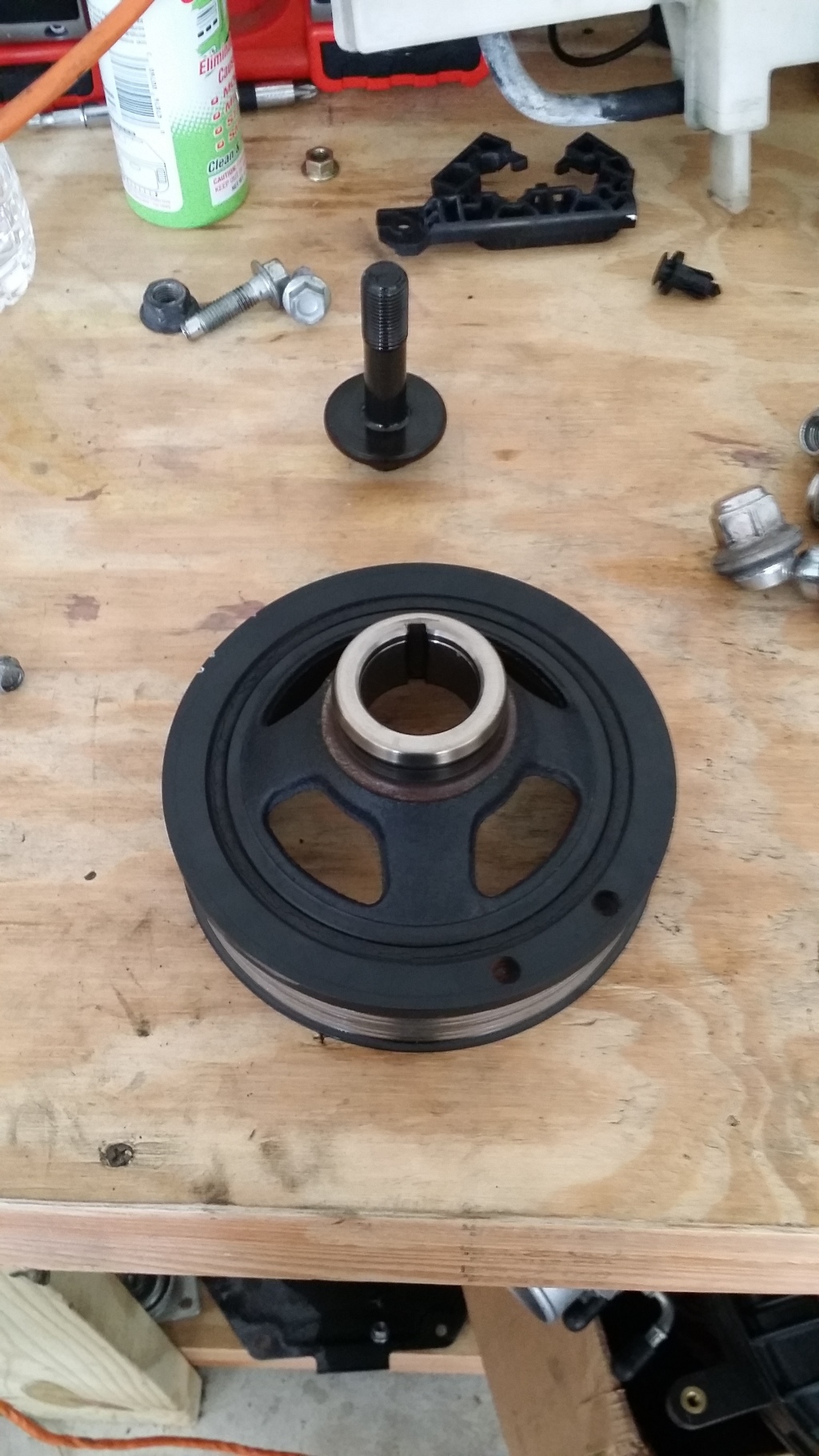

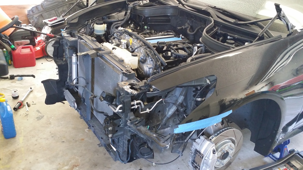

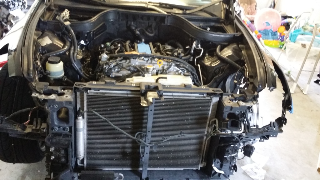

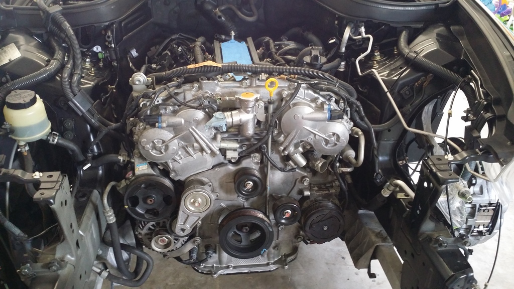

Here's a few more pics that I didn't post.
At this step I needed to swap the crank pulley and didn't have the factory flywheel stop tool.
I went to home depot and bought a length of steel. I drilled 2 holes in it and used the alternator bracket to create a wrench. I had two bolts tightened down. The steel bar up front jammed under the frame and the alternator bracket in the rear behind the pulley.
I was able to use a 1/2 2ft long breaker bar with my jack handle and break the bolt lose. It took a ton of effort to remove! I read the torque specs in the manual and it states 33 ft lbs...that's crazy.

After that it was smooth sailing...
