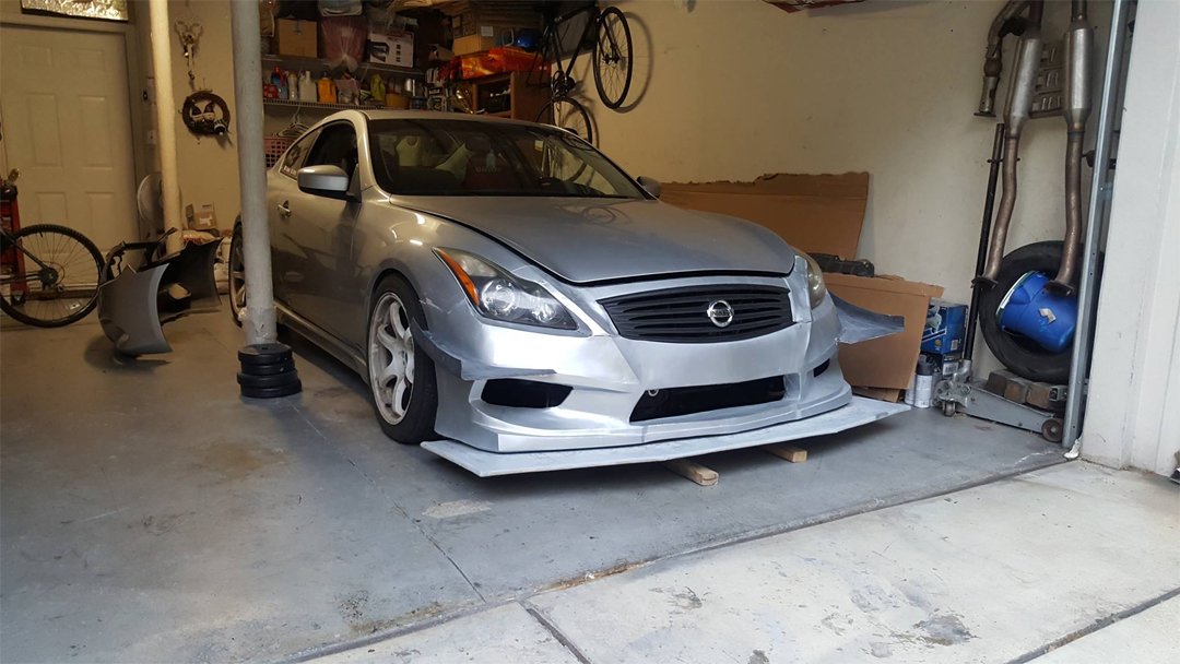

but here's a sneak peak of the canards i have made. they're obnoxiously large right now but i'll trim them down once i'm happy with everything else. a lot more fine tuning left before these go on..
i also made a template for the front splitter but no real progress beyond that yet. i'll be using a 3/4" foam core sandwiched in fiberglass. i have the materials, just have to find the time to lay everything now

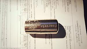

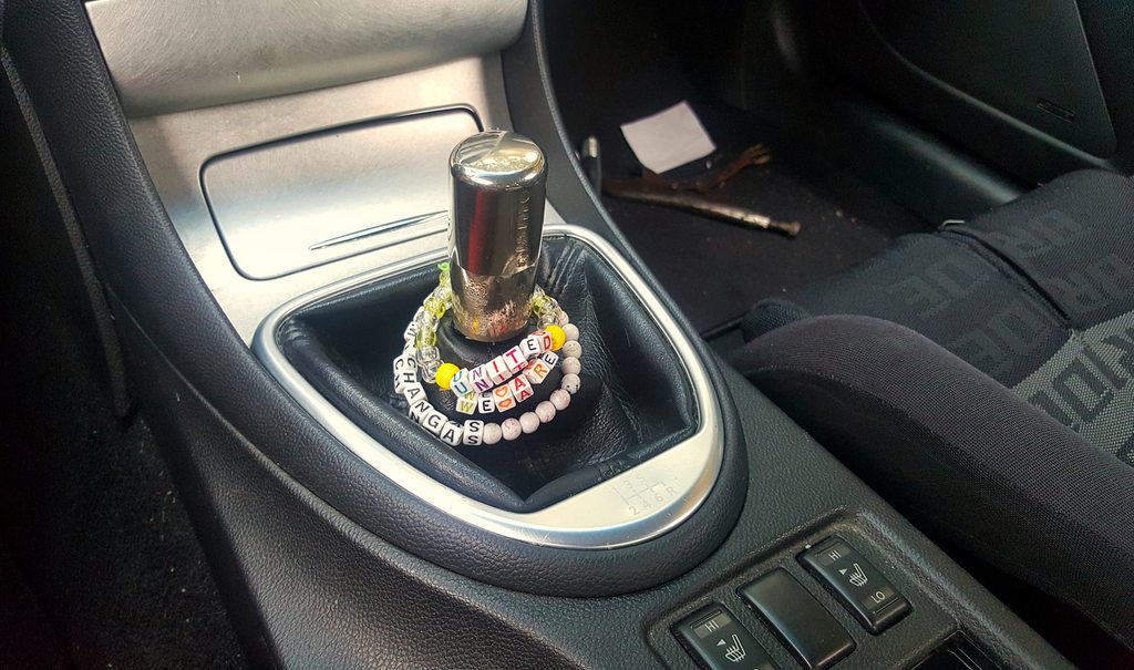

picked up a used nismo aluminum shift **** for $15 from japan. theres a small gap between the boot and the bottom of the ****, does anyone know what i can fill that space with? or is it something i have to live with it?
Old Dec 12, 2016 | 08:13 AM
  #51
PongSanity's Avatar
PongSanity
Posts: 996
Likes: 129
I used this to fill the gap when i changed my OEM shift ****.
https://www.z1motorsports.com/z1-pro...er-p-7259.html

thats perfect, thanks!

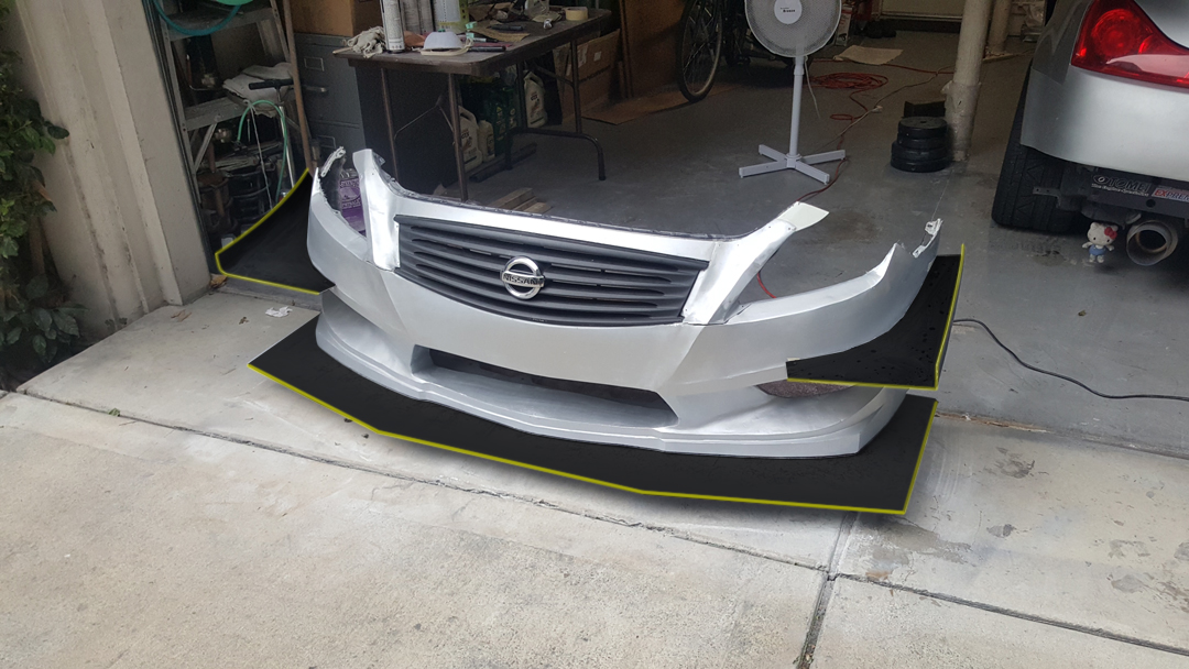

as promised here's an update on the front end aero package for 2017. finished up fitment so now i just have to mount the splitter and paint it along with the canards

both the splitter and canards are diy 1-offs. the canards are fiberglass and the splitter is a honeycomb core composite.
although, i have thought about making a plug and play version of the canards for the sport bumper if people were interested in them since i already have a mold.

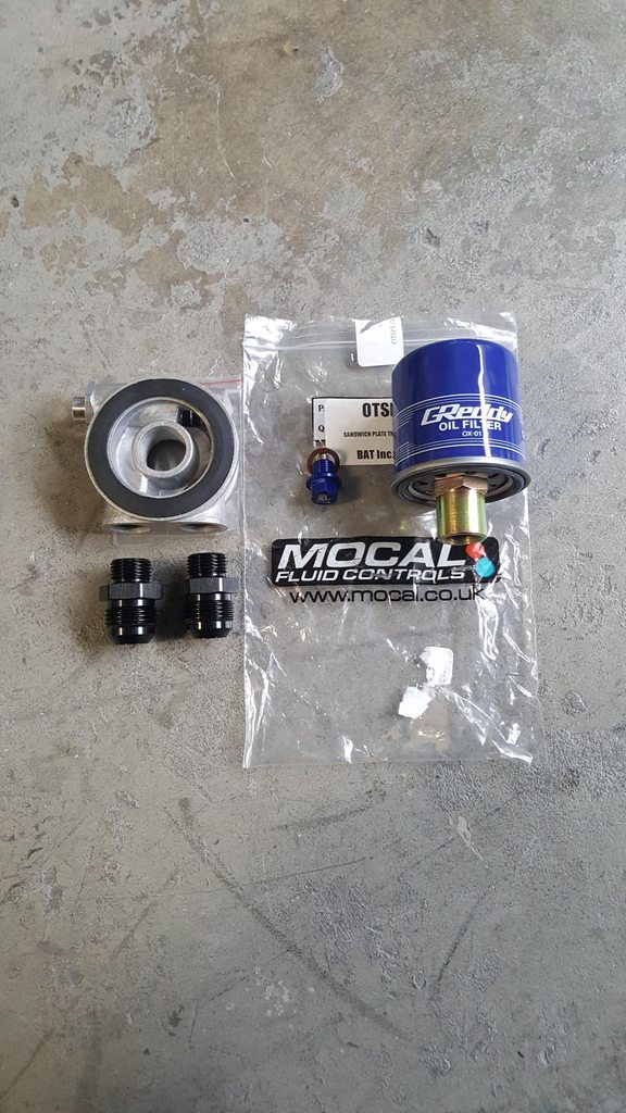

another update, this time to the oil cooler setup. replacing the greddy sandwich plate with the mocal unit which is more compact overall. also picked up a z1 magnetic plug while i was at it.

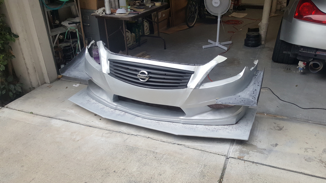

paint tomorrow

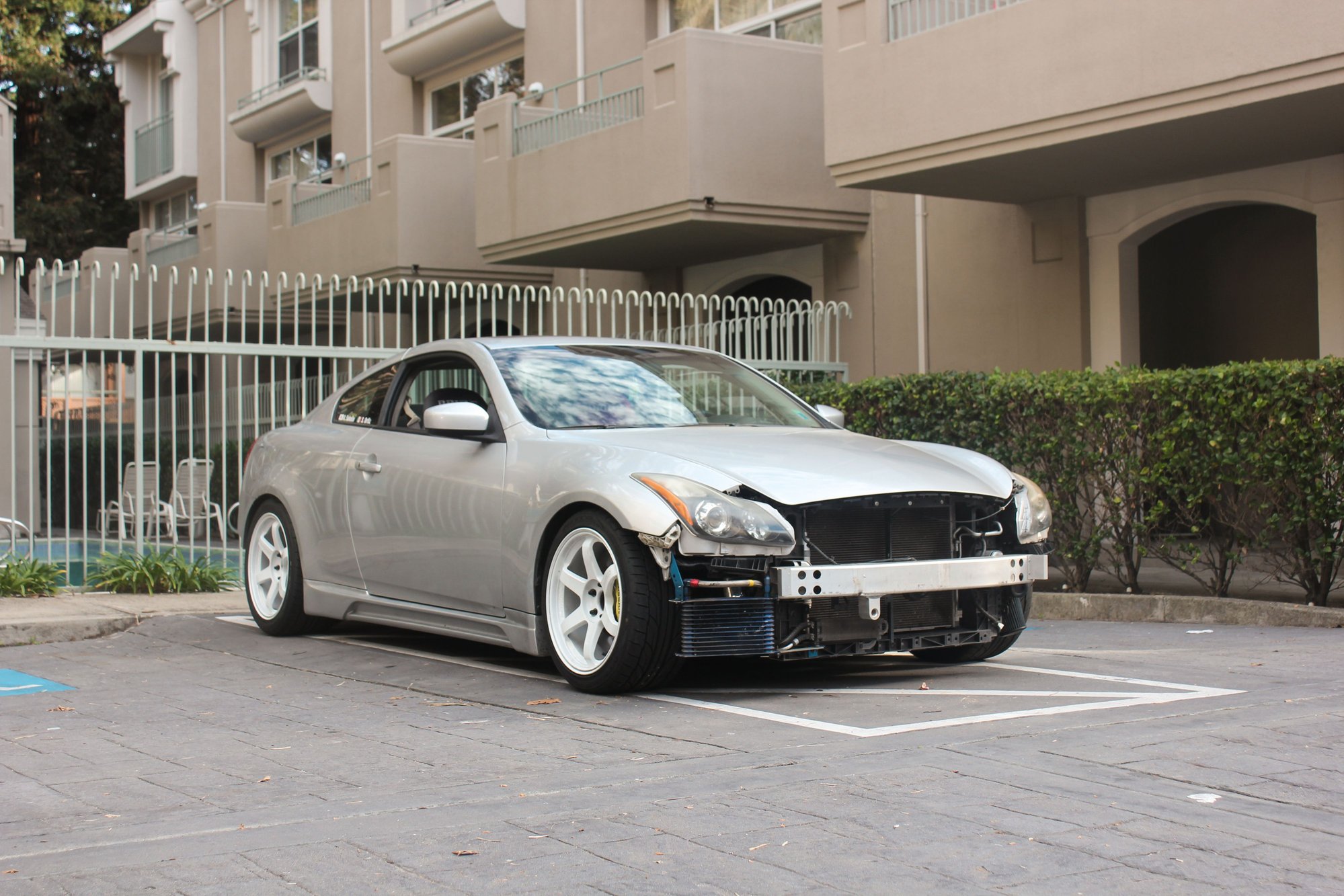

Picture time Volk TE37RTs in dash white. 18x10 +39 with 3mm spacer in the front.
i can finally run non camber-gang specs in the rear lol. not sure how i feel about the fitment up front yet though. also trying out the nitto nt555 g2 so we'll see how these are compared to the invos
ordered a yellow spoke sticker but haven't received it yet.. i might go with pink or black. we'll see when it gets here. and bumper is off because i have another surprise hopefully before the end of the year

Nice to see you updating this build, look forward to more!
What size tires are you running there, and are you going the same size w/ the NT555s?
Old Nov 25, 2017 | 01:11 PM
  #60
Purist's Avatar
Purist
Joined: Nov 2014
Posts: 163
Likes: 26
From: Bay Area
The TEs have the nt555s on them in the pics. I went with 265/35 and 285/35 this time. On the old invos i was running 255/40 and 295/35
