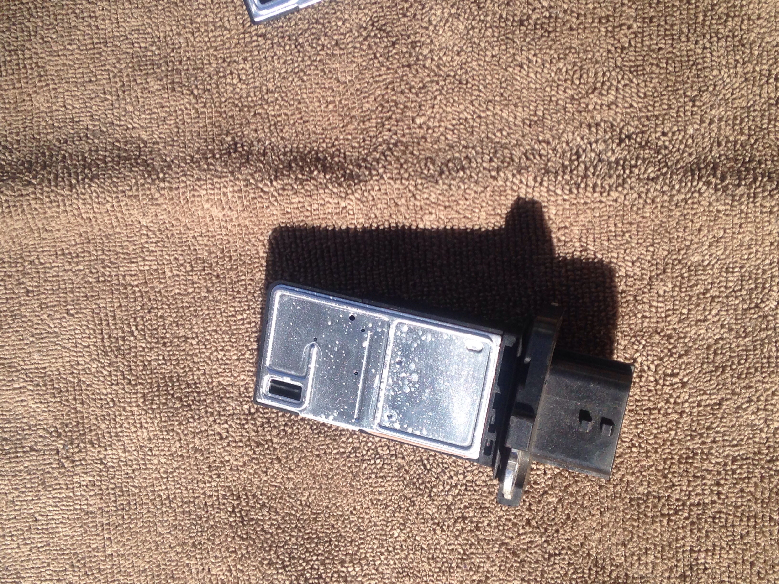

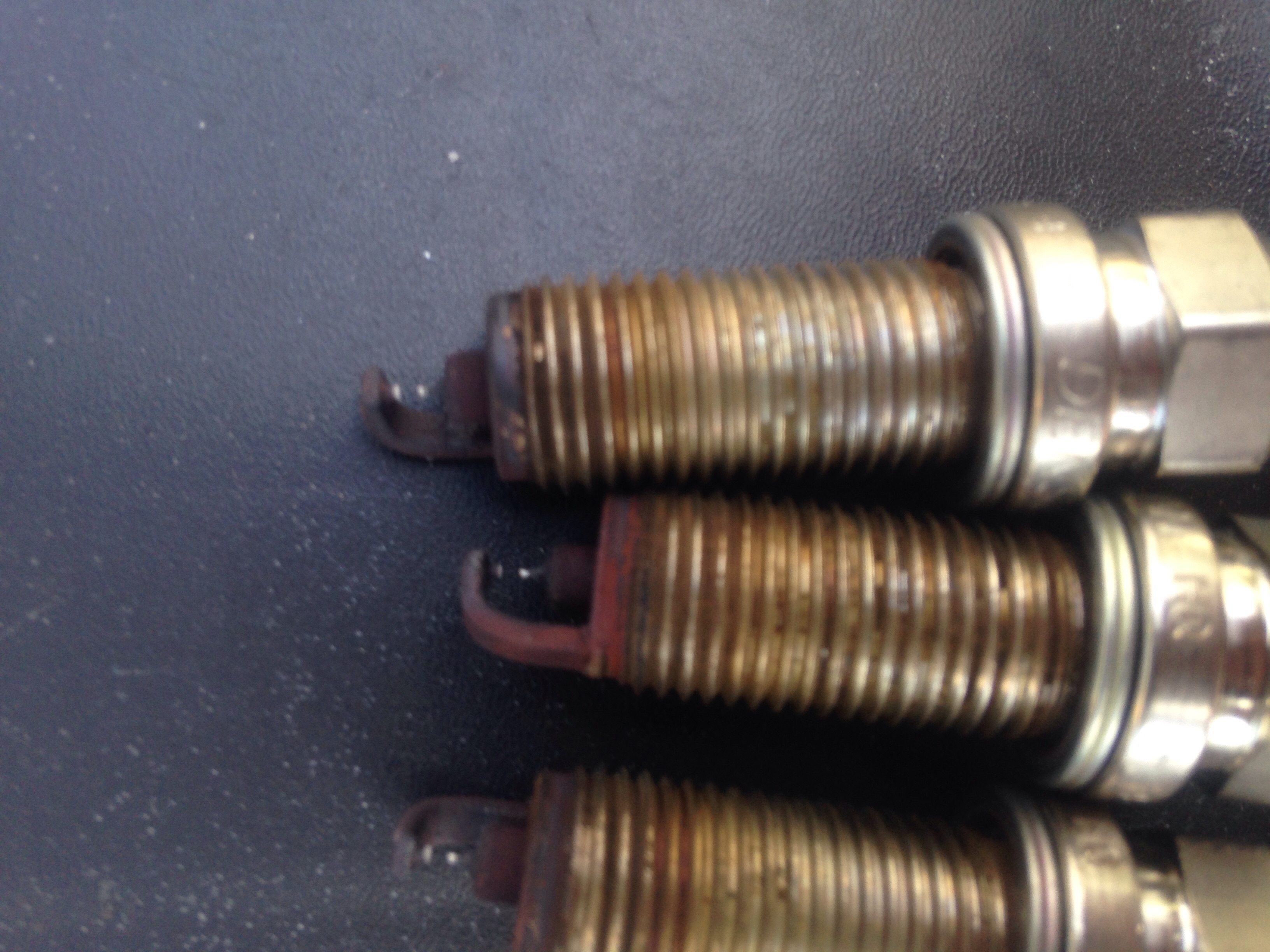

No trying plugs first , my mafs had water spots on them :/ plugs look :/

Mafs water spots:/

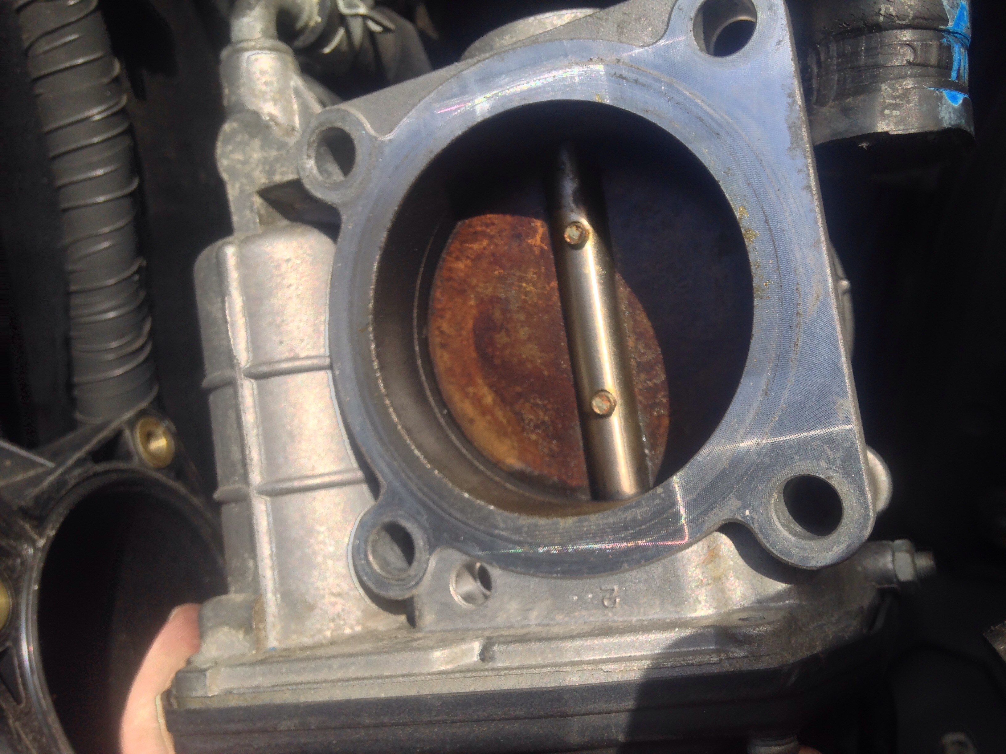

I also had a lot of oil in the TBs and in the plenum pics when in done

So here's a pick of the TB with oil in it

if you haven't already I'd get some BG44K it's far better than anything in parts stores. At least that's what I've read. I've used it for 10years on all my vehicles and never had a knock issue. Carbon build up on your cylinder walls could be the culprit and looking at those plugs it doesn't look like you were getting a clean burn. Obviously if your knocking your aren't. Changing the plugs and having the car run better is a good sign. Get gas a newer Shell station 93 octane and run the BG44k through for two full tanks and that may solve your problem. Maybe the gas you were getting was ****ty thats why is go to a newer station as their tanks should be cleaner.
