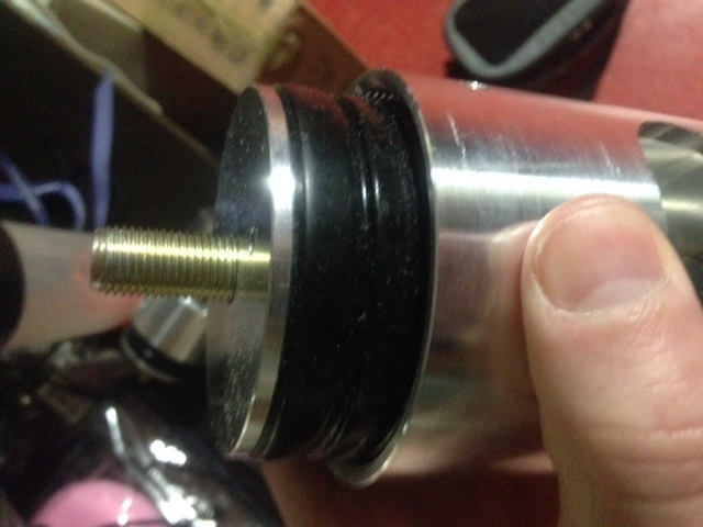

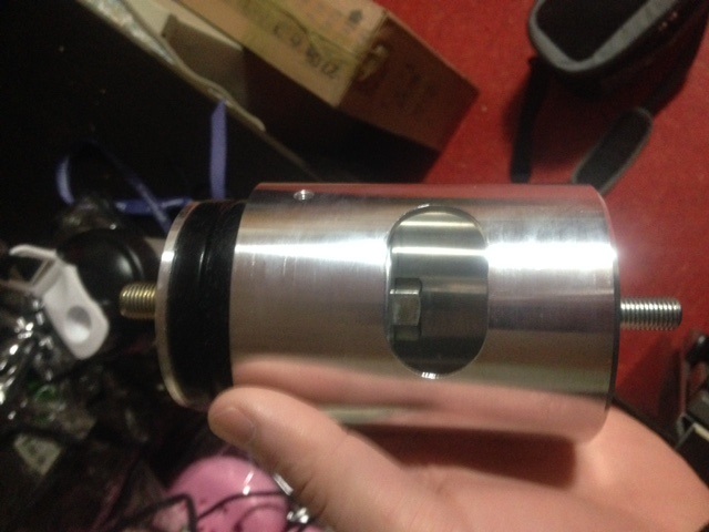

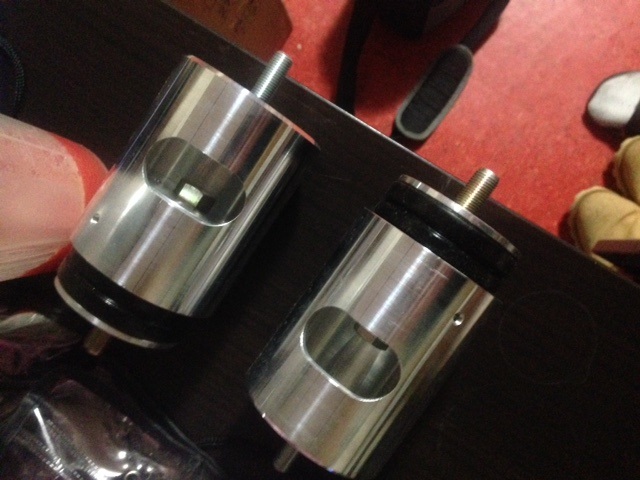

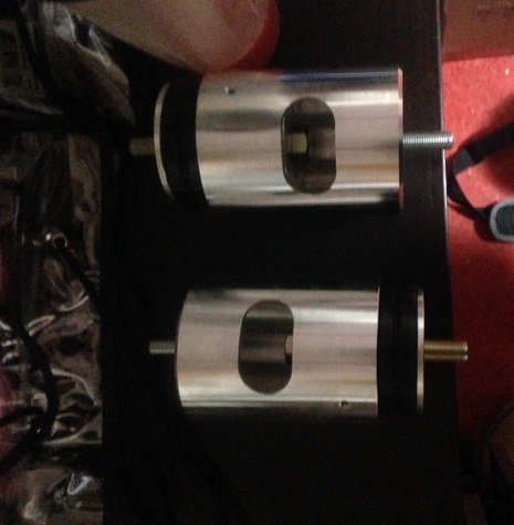

BTW car is at the shop for the Z1 motot mount install. Pics below, Damn these things look serious
That is cool looking hardware, no doubt.
Did your shop give you an estimate, or are you just winging it? In other words, I'm interested in total cost, as well as your impressions.
And then I'm interested in your impressions once you come down from your mod high.

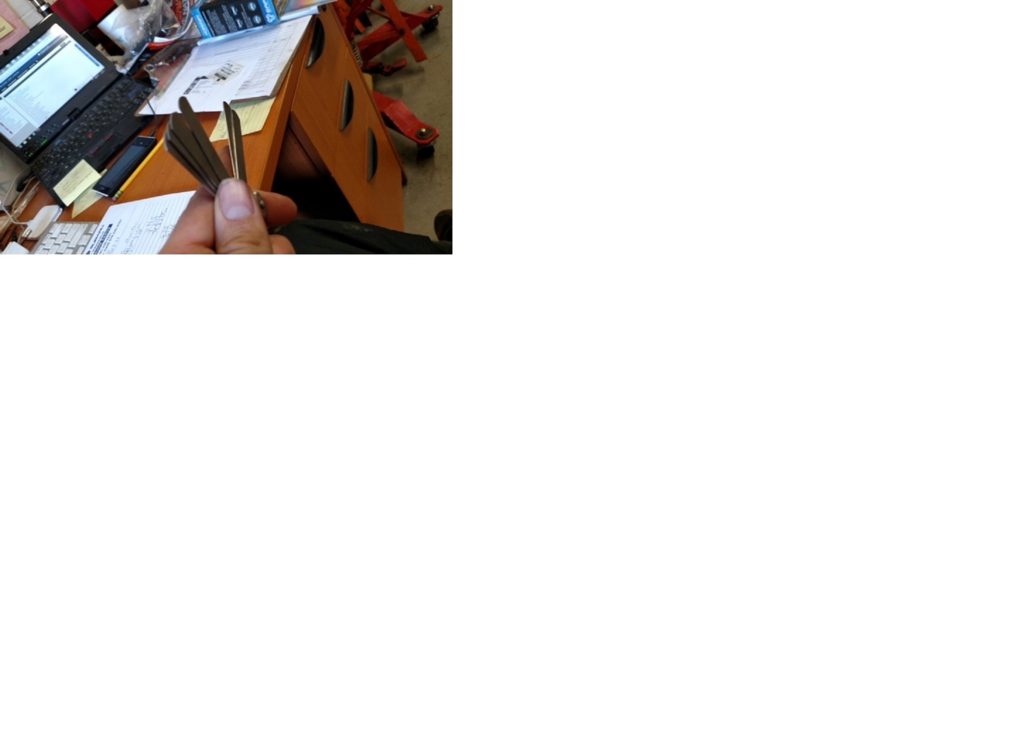

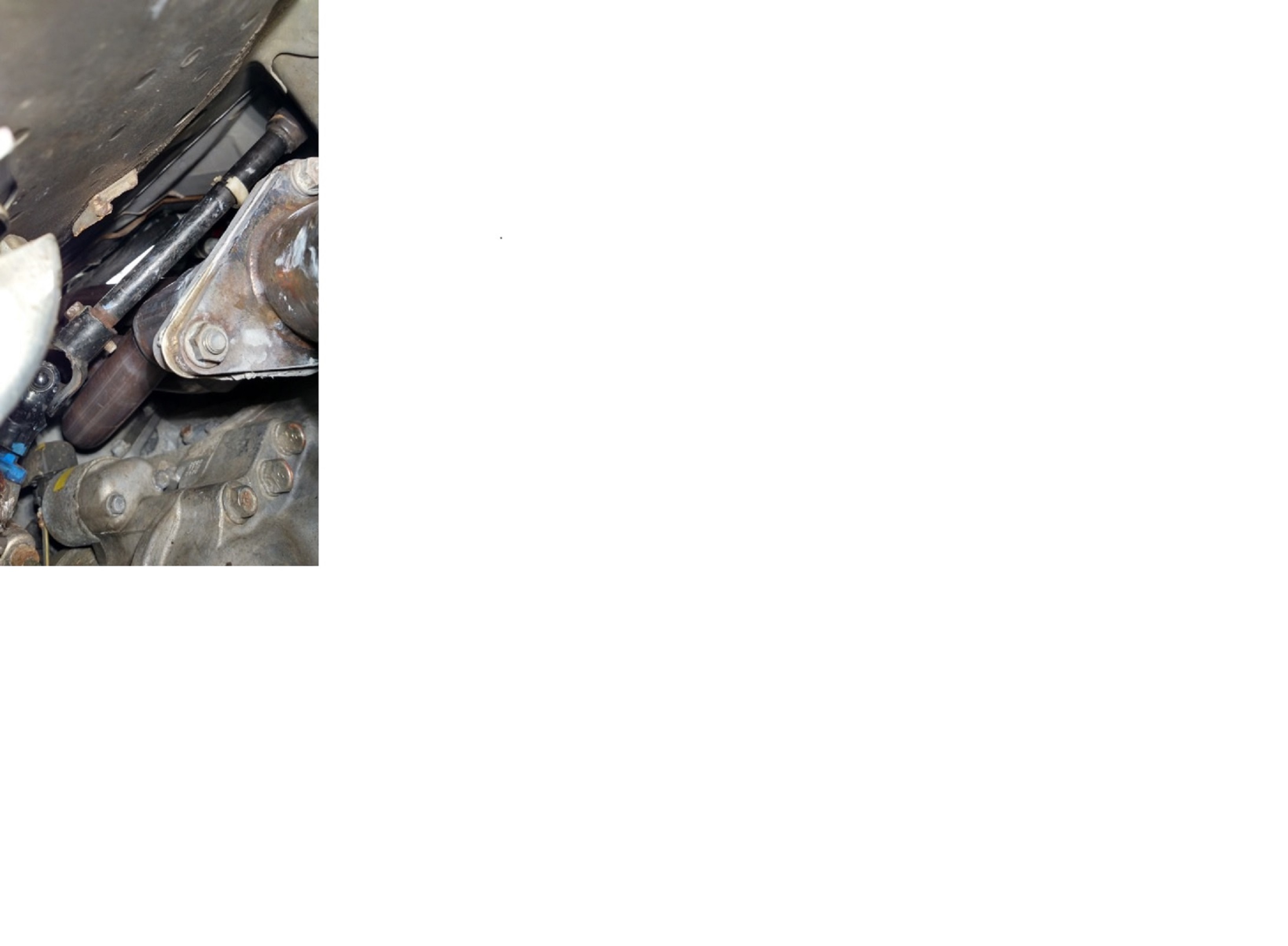

So here is the tech's break down, BTW MUCH PROPS to Jason @ Motive!!
This is the email he sent me:

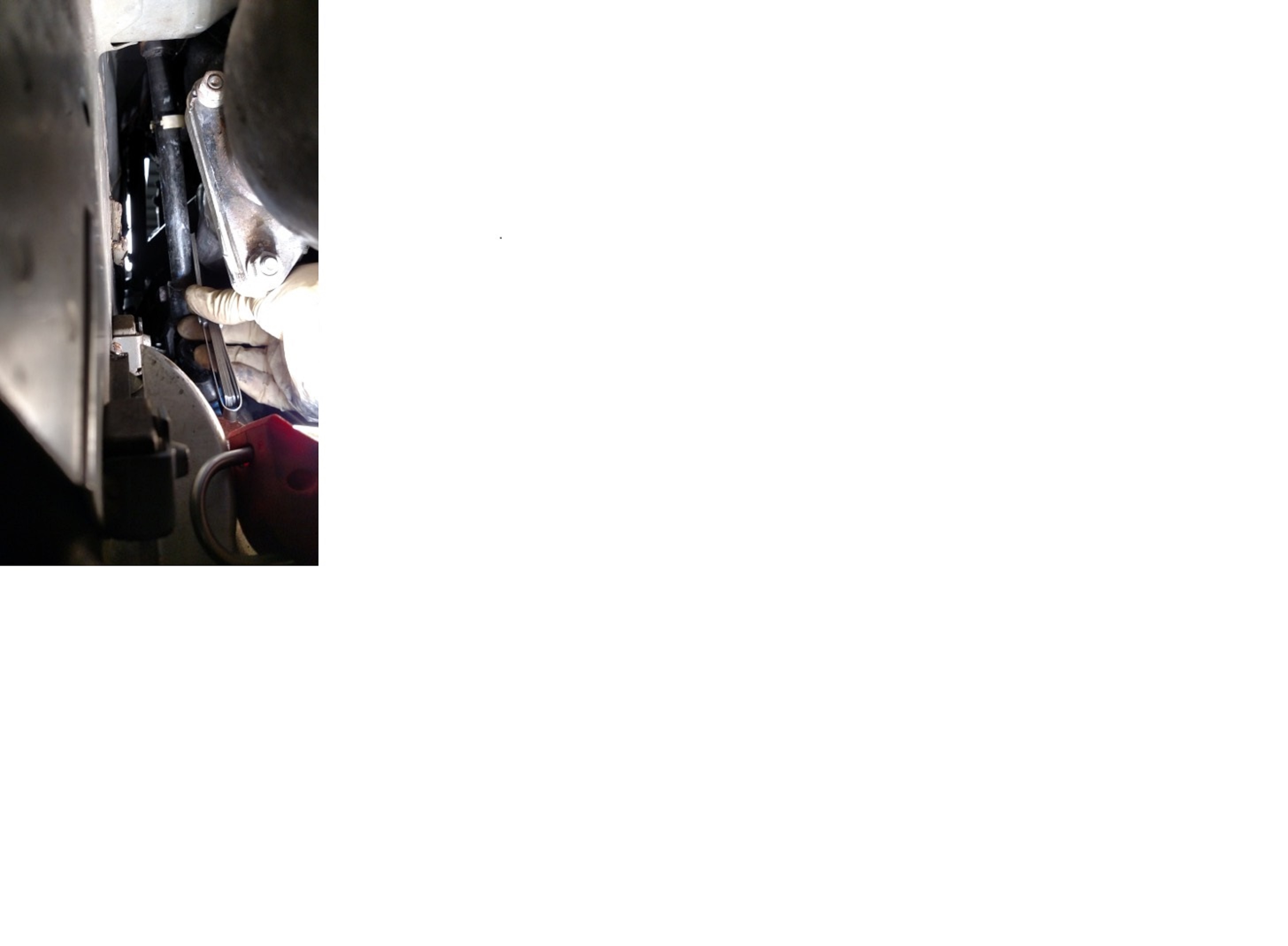

I wanted to take this time to email you the information I was able to get for you today. I will be breaking this down with the math on how close this header is to the steering shaft. Take a look at here Before anything was touched. ( PICS are in order in from the email)
Just 3.175mm in space! ( From the headers to the steering shaft.
After the mounts and a little adjustment on the rear mounting bolt for the exhaust yielded a gain of 1.245mm.... Adding the two blades to the right into our new total of 4.220mm

So... you gained 1 mm clearance, with mounts that won't rock as much as OEM.
Is that about the size of it? Hmm. GL.
