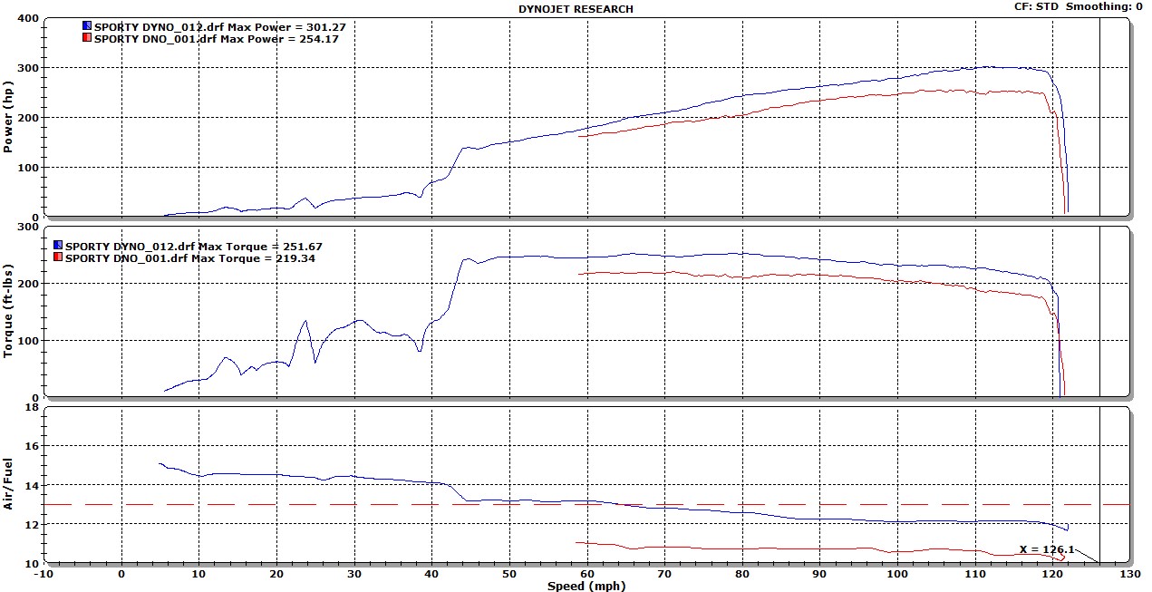

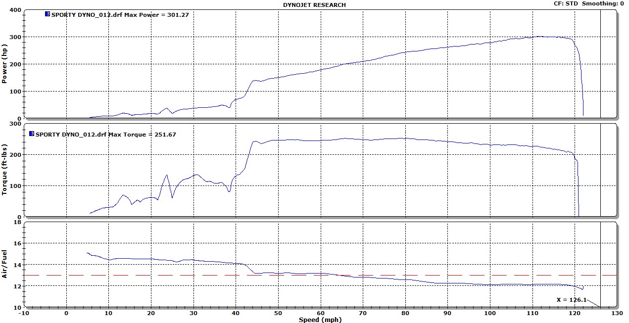

Post-Tune Results are in:
Only got 2 runs in, since the dyno program was having trouble, but both runs were over 300whp.
And finally, the OEM baseline dyno and Post-Tune Dyno.
Summary:
Full Stock Baseline: 254.17HP/219.34TQ
After RHFC, Catback, Stillen Gen 3, M370, and tune: 301.27HP/251.67TQ
Gains = 47.1HP/32.33TQ
Satisfied with the results. Still waiting on my wheels and NST pulleys to arrive which should help me get over 310whp.
