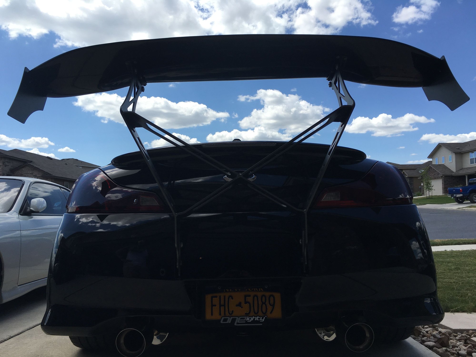

The next phase has begun! Oh yeah, did the steering wheel thing and went crazy with a chassis mount wing (DIY threads on both coming soon)

That wing is HUGE. Do you notice a big difference?
Once it gets up to speed you can really feel the downforce. I'll have to play with the angle of the wing to get it perfect though.
