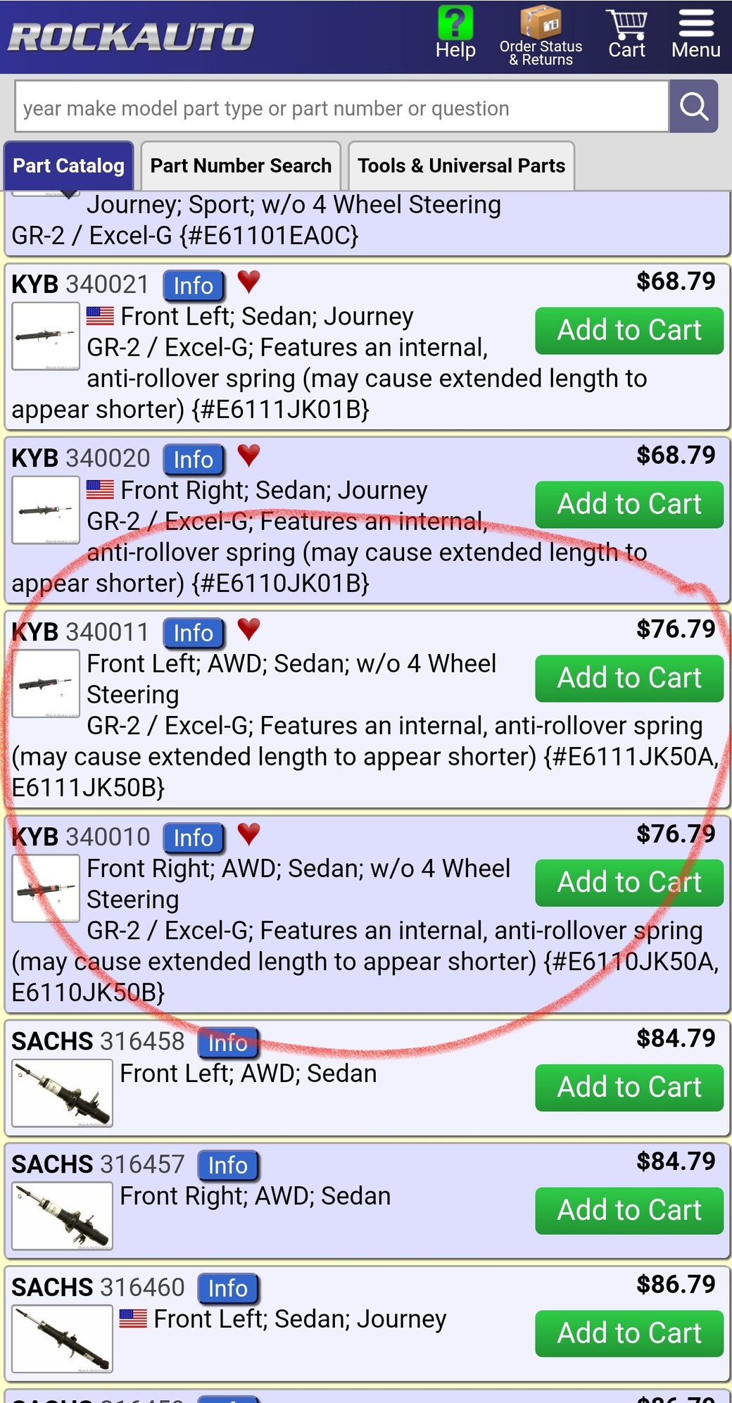

Rockauto has them listed under struts and here ya go OP
Thank you. I had found those but thought there was shocks I needed to purchase as well.

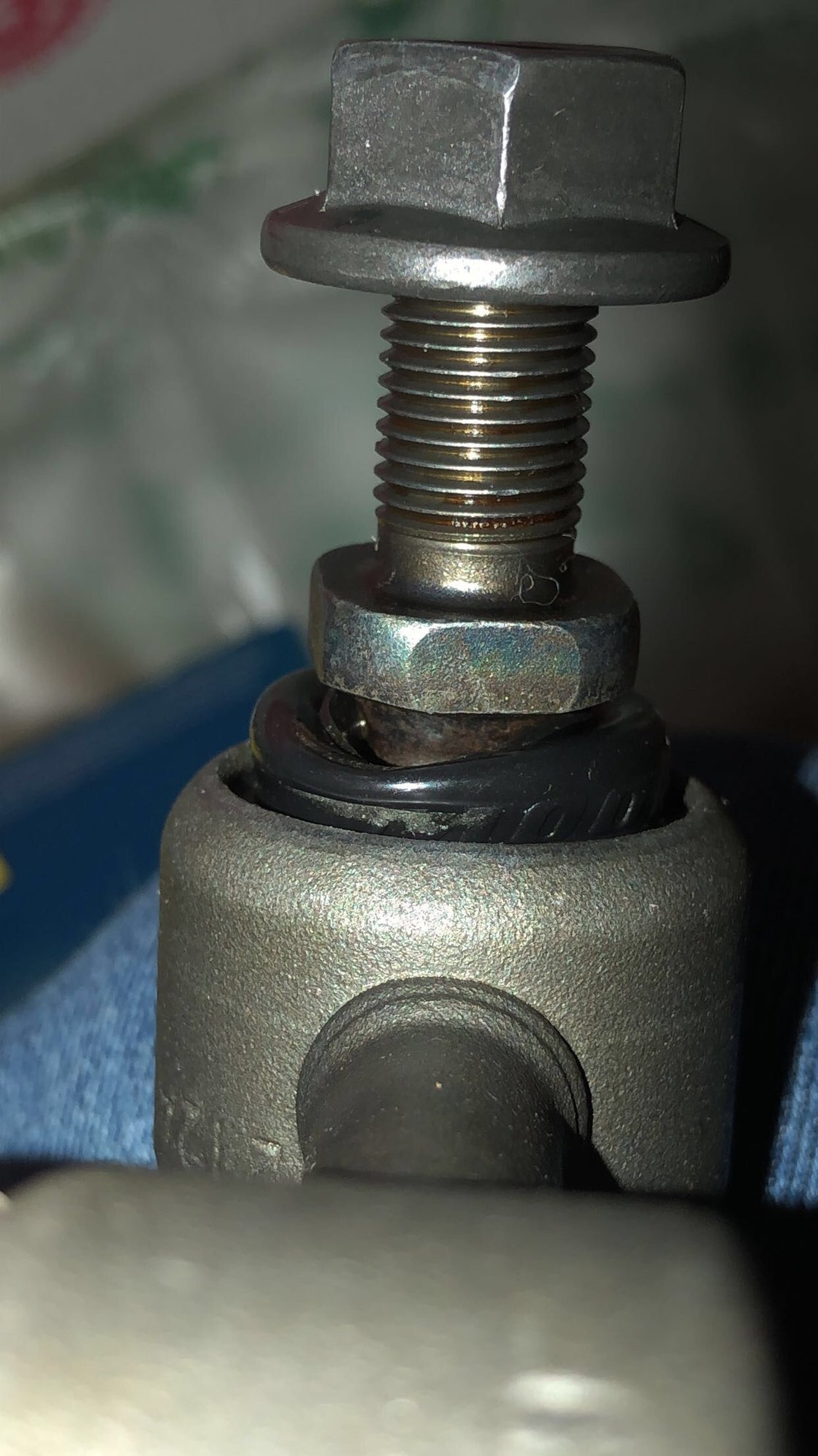

Make sure endlinks bolts arent loose or endlink isnt torn bc once it tears and grease is gone it will clunk when you drive over bumps at low speeds

So here’s how 3/4 endlinks look out of the package. They were really bent inward and when I bent them back to straight the boot didn’t really come with it. There’s a gap.
Edit: should i make a return or is this normal? Doesn’t look to me like it’s torn but in my mind it looks like grease will escape.
