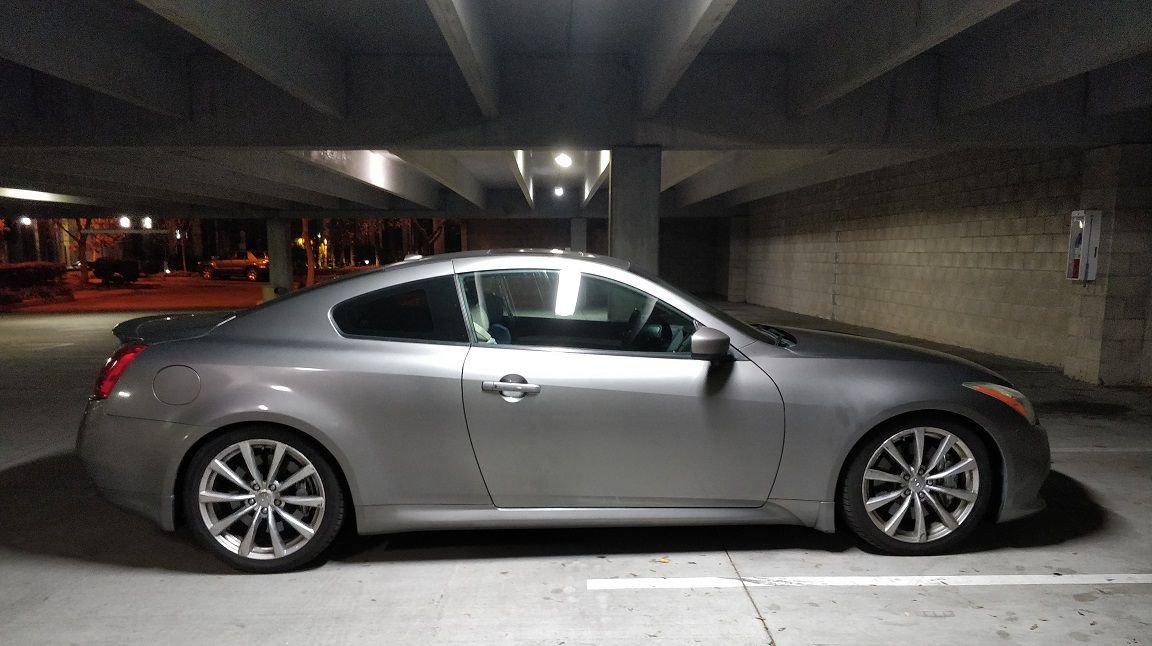

All done!
For now, I will not do the corner balance since I am not gonna do any serious racing. I still need to get an alignment, feels a little squirrely, but wow does it grip! Way less body roll, I still haven't broken traction but I have done some fast turns where my wheels would have definitely been squealing and sliding before. Now it feels like it's glued to the road.
If -15 is hardest and +15 is softest, I set the rears to -5 and fronts to -10
I didn't worry about trying to make the ride height the same, I just made sure the coilovers were adjusted to the exact same height on the left and right. The front is about 1/4 inch lower than the back. I'll let it settle a few more days and get it aligned.
