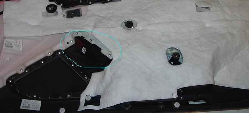

1) remove the interior panel by following the DIY threads above.
2) remove the window control and door lock box from the interior panel (circled in Turquois), held in place by 4 plastic clips, just use a small flat head screw driver. You will need this to roll your window up and down during adjustment.
3) there are two adjustment screws that are in a metal housing with a green plastic cover, and they can be access through the two holes circled in red. You can see them when the windows are rolled up (green). the adjustment is made through the 2 access holes with Red arrows using your rachet.
4) the screws are 7/32 in size and I used a 1/4 small rachet, you can make about 1/4 of a turn each way!
***Counter-clockwise turns will make your window go up higher, i.e., edge of glass will push up further into the rubber seals. Make the same # of turns for those two screws.***
5) don't drop your rachet into the door housing, like I did, which requires the removal of the speaker mount and takes 10 minutes longer!
I spent about 1 hr for this (1/2 hr. or less for one side), well worth the $100+ the dealer wants to charge me, and most of all is QUALITY control!!! Window adjustment are only covered for the first 12 months.... so the story goes.
