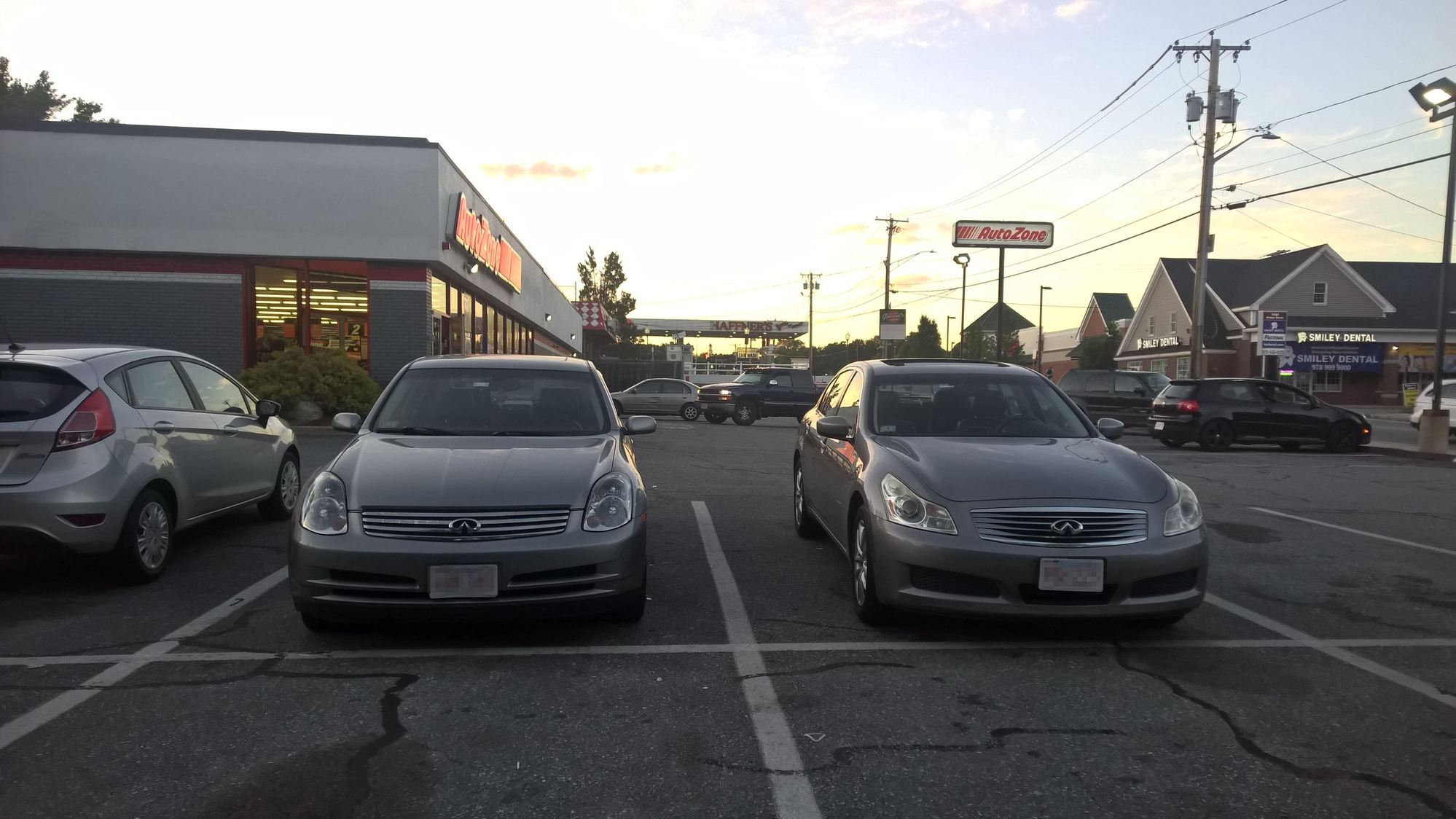

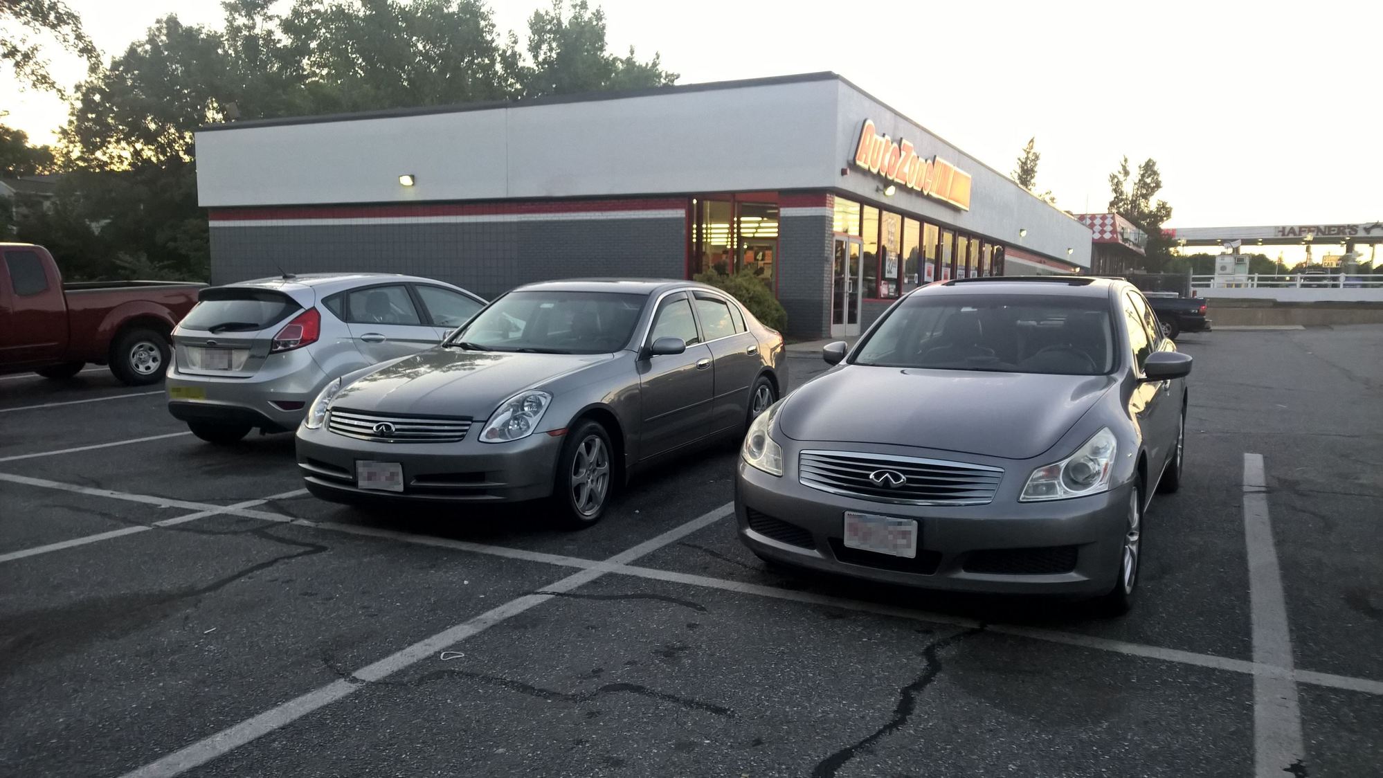

And, some pictures of my car (for bribery, since I never posted any in my Newbie Thread!)
Mine is the 2009; the 1st generation is a nice, clean parking lot stranger in the same color. Makes me smile

Man, those are some clear head light covers on that V35. Those that I see usually have some serious U.V. fogging.

They really are clear! More incentive to polish mine.
