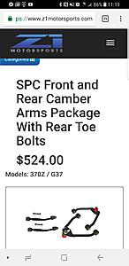

Hey all,
Just pulled the trigger on some coilovers. Now according to the picture attached, is that all i would need to be good for alignment? Would you add anything else? I don't want to keep the stock bucket.
I'll add that i currently have Hotchkis sway bars, moog endlinks. I'm also not trying to be crazy low

I think you covered the bases.

If you don't want to keep the stock spring bucket you'll need toe arms rather than the toe bolts to adjust toe settings.
