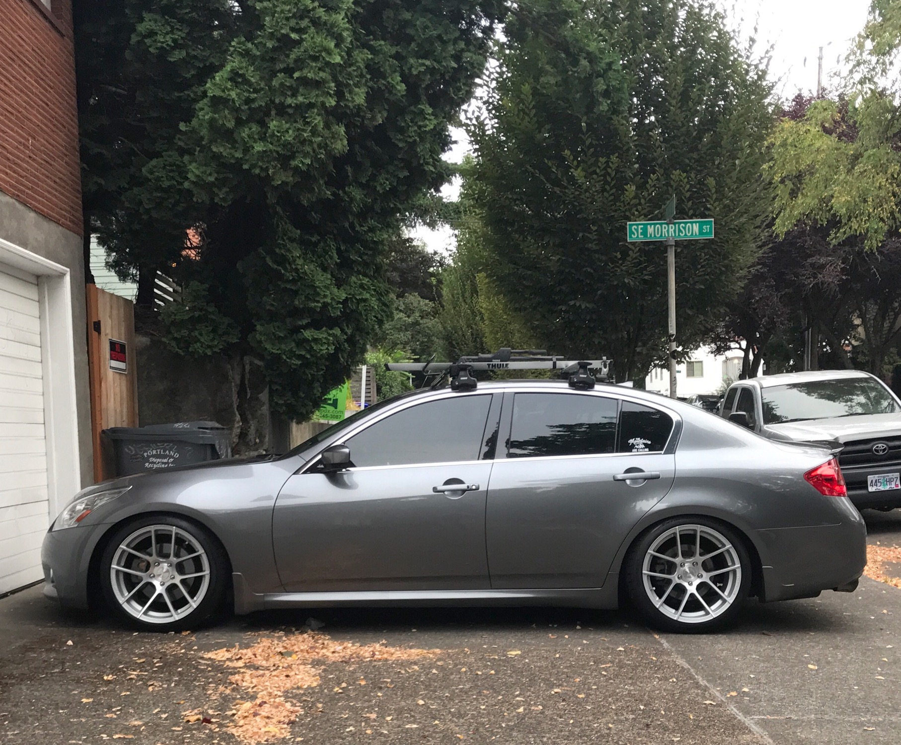

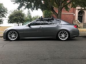

This is my first set of coilovers. I have always just gone with lowering springs in the past and they have served me well and always improved handling significantly. I had Swifts on my g37xS sedan for about four months before making this switch. The change to coilovers from lowering springs is massive. Now having a proper suspension set up its clear coilovers are on a different playing field. My mechanic friend had installed the coilovers along with spc front and rear cambers arms so he didnt have time to get the coilovers to the right height. The car was slammed and for one day I drove it. It was terrible. I was scraping everything and I was extremely anxiety ridden while driving. I should also mention the coilovers were set to their middle setting and that it was jarringly stiff. There were some scary sounds coming from the car and you could feel the hits from the stiffness of the suspension in your seat. The next day he dialed it in to the perfect height and I also asked him to soften the coilovers 5 clicks from the middle, (a minor adjustment). It was immediately, soooooooo much better, it was like a 180 degree change. The ride became compliant yet taut, soaking up road imperfections of all sizes without skipping a beat. The cars new ability to really be thrown into corners and keep it's composure, tires engaged with the asphalt is astonishing. I am still blown away by this new found handling prowess in addition to it having such a supple ride. I also have Hotchkis sway bars installed which I had my mechanic set back to the softer settings, the rear one is in the middle setting. The car feels like and is now a much more sophisticated and competent machine and I couldn't be happier with the purchase. All Feal suspension comes with Swift springs as standard as well which is awesome. The rating for this kit was of their choosing and is 12k-5k. I purchased from Feal directly and the customer service was great the whole way through and they were dead on with the timeline they initially gave me. They had to order in the parts since all their coilover kits are built in house. It took 3 weeks. They were delivered to my door by the beginning of week 4. Hope you enjoyed my review.
The first photo is when it was slammed for a day
Attached Thumbnails Feal 441 Coilovers for g37x sedan-co3.jpg   Feal 441 Coilovers for g37x sedan-co2.jpg   Feal 441 Coilovers for g37x sedan-slammed.jpg   Feal 441 Coilovers for g37x sedan-proper2.jpg   Feal 441 Coilovers for g37x sedan-co.jpg

As it says in the post, the first pic is when it was slammed for a day. The rest are how it sits now.
