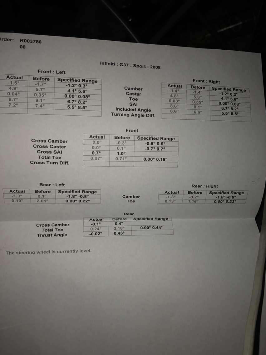

So I took it to another shop who specializes in Nissans. They told me my camber and caster was off. The previous alignment shop wouldn’t even tell me about these issues so I’m glad I found this shop now. I’m currently getting them to replace my front upper control arms with SPL. So hopefully that fix it.

Update:
So after the alignment they were able to straighten everything. I drove on the highway at 70mph and still feel the slight vibration on the steering wheel and veers to the right. It has to be my wheel bearings because the shop tech inspected everything else and said they were good. Called the shop and didn’t answer so I’ll try again tomorrow as they will be closing soon. Ordered some Timkens just now and will replace them to see if that will finally fix it.

Good golly, look at that toe! Good thing you got the suspension sorted.
Lol tracking with the previous specs would’ve been horrendous. Broken parts for sure.
