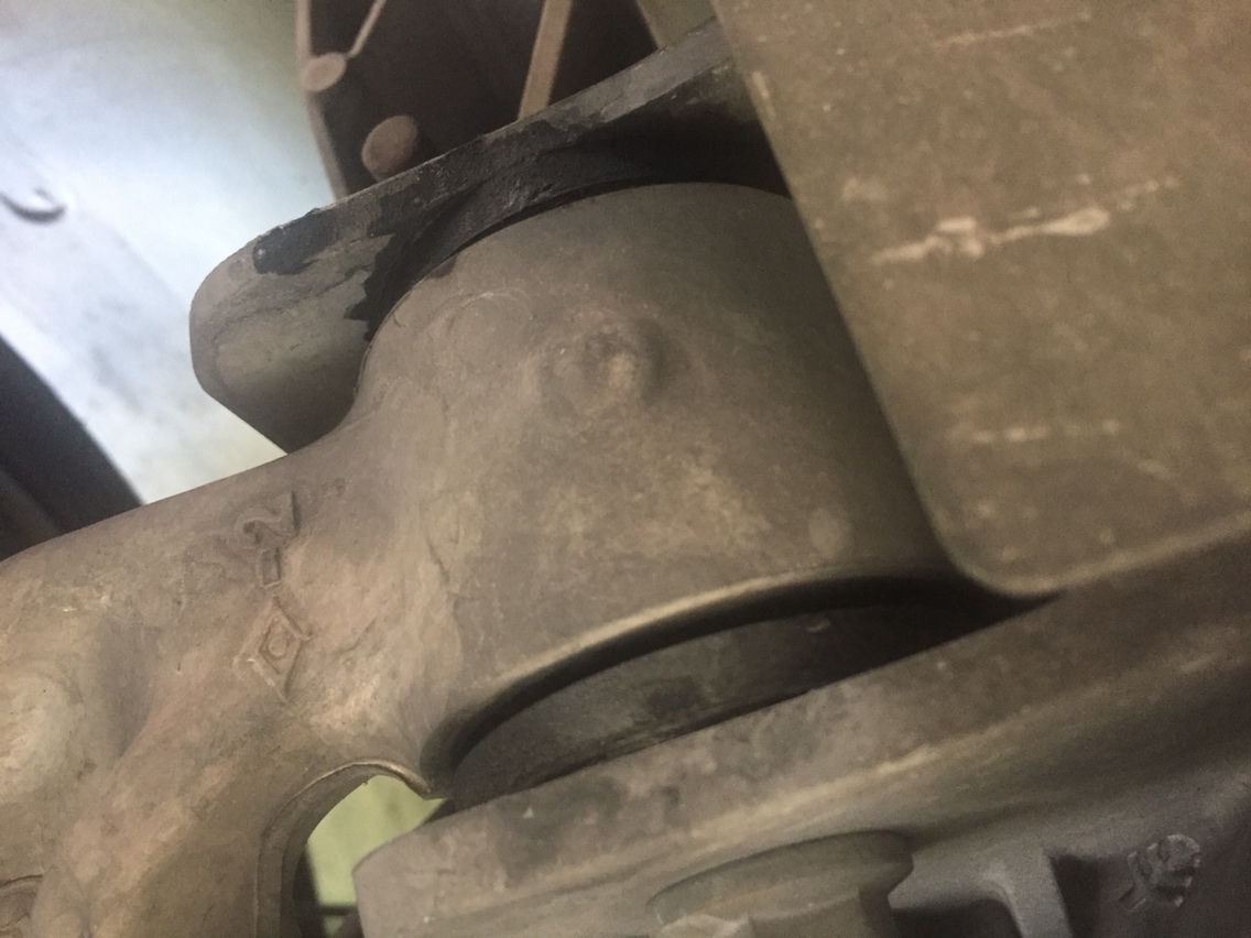

Likes: 35
From: Houston, TX
Originally Posted by Surfnazi
Yes and shock mounts
Do lower control arms have fluid in them as well? Like diff bushings? What could it be?-photo773.jpg
Old Oct 4, 2017 | 05:53 PM
slartibartfast's Avatar
slartibartfast
Posts: 6,105
Likes: 842
From: Houston, Tx
Negative.

Originally Posted by xmajd92
Do lower control arms have fluid in them as well? Like diff bushings? Attachment 177987
The large impact bushing on the lower front control arm is fluid filled.
Consider tramlining as another source. Stiffer sway bars, wider tires, or endlink preload are all sources of tramlining.
