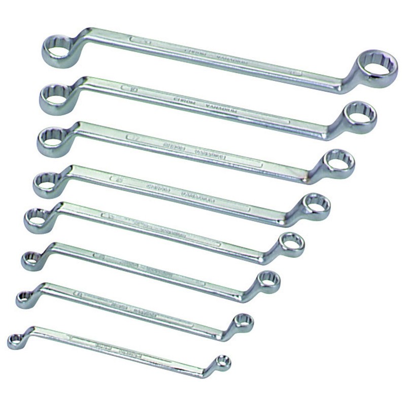

What you'll need is an offset wrench:
I got a really cheap but good set at Harbor Freight and it will allow you to hold the piston in place while you turn the bolt.

The top of the shaft has two flats on which you apply an open-ended wrench. This holds the shaft while you use the above offset box-end wrench to loosen the nut.

Thanks...will be doing it once my clamshell single action spring compressor is delivered. Gonna head to the store for the offset wrench...
