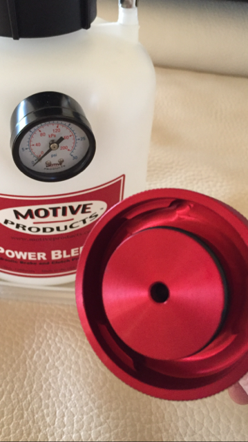

I finally got around to bleeding my brakes with the Motive Power Bleeder 107 this weekend. Before I lifted up the car, I wanted to test to seal of the bleeder. After pumping up the bleeder tank, the cap that fits over the brake reservoir wouldn't hold a seal. I tried numerous times but I could hear the hissing sound of air leaking right at the cap.
I'm going to call Motive this week and see what they will do for me. I'm considering buying the aluminum cap which appears to have a tighter fit. You can also buy the black label version of the 107 which I didn't know about until after my purchase which does come with the aluminum cap instead of the plastic one.
As a side note, be careful as you twist the bleeder cap on to the brake reservoir threading as small pieces of twisted plastic from the soft plastic of the bleeder cap may fall into your reservoir.

So here's the deal with the air leaking issue. I spoke with Motive today and they told me it is possible that I have one of the older plastic adapter caps which has been improved with a better plastic. There may be sellers on Amazon who are selling the bleeders but are selling the older versions with the softer plastic caps that have had leak issues. (Motive said that they don't sell directly on Amazon or Ebay.) BTW, I bought the bleeder only a few months ago on Amazon and just opened the box over the weekend. For my trouble, Motive as a one time courtesy will send me the aluminum cap after I mail them the plastic cap that I have.
sLADe781: I suggest paying a few bucks more and buy the 117 model with the aluminum cap to begin with especially since you will probably do several brake bleeds over the course of ownership of your vehicle.
Amazon.com: Motive Products 0117 Power Bleeder: Automotive Amazon.com: Motive Products 0117 Power Bleeder: Automotive
BTW, my 08 has the same master cylinder reservoir that you do.
Good luck!

Motive sent me the replacement aluminum adapter cap as promised. This cap feels heavy, solid and is a finely polished. Let's hope it works as well as it looks. The other cap felt like a glorified 16 ounce plastic soda bottle cap compared to this one. In the next couple of weeks when my schedule frees up, I will give the bleeder a go and report back.
UCLAg37
Old Mar 11, 2016 | 11:37 PM
Nice upgrade and nice customer service!
