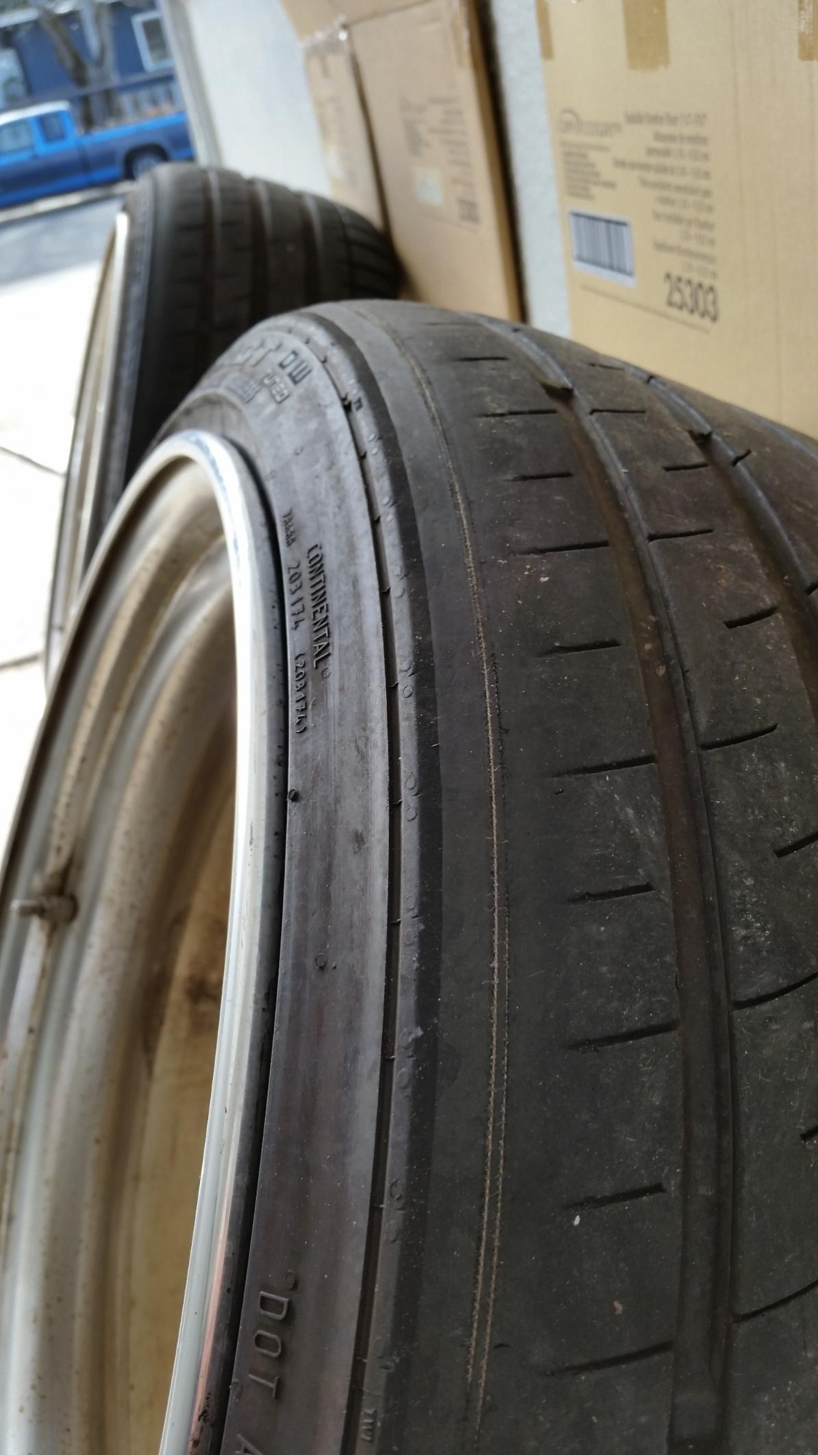

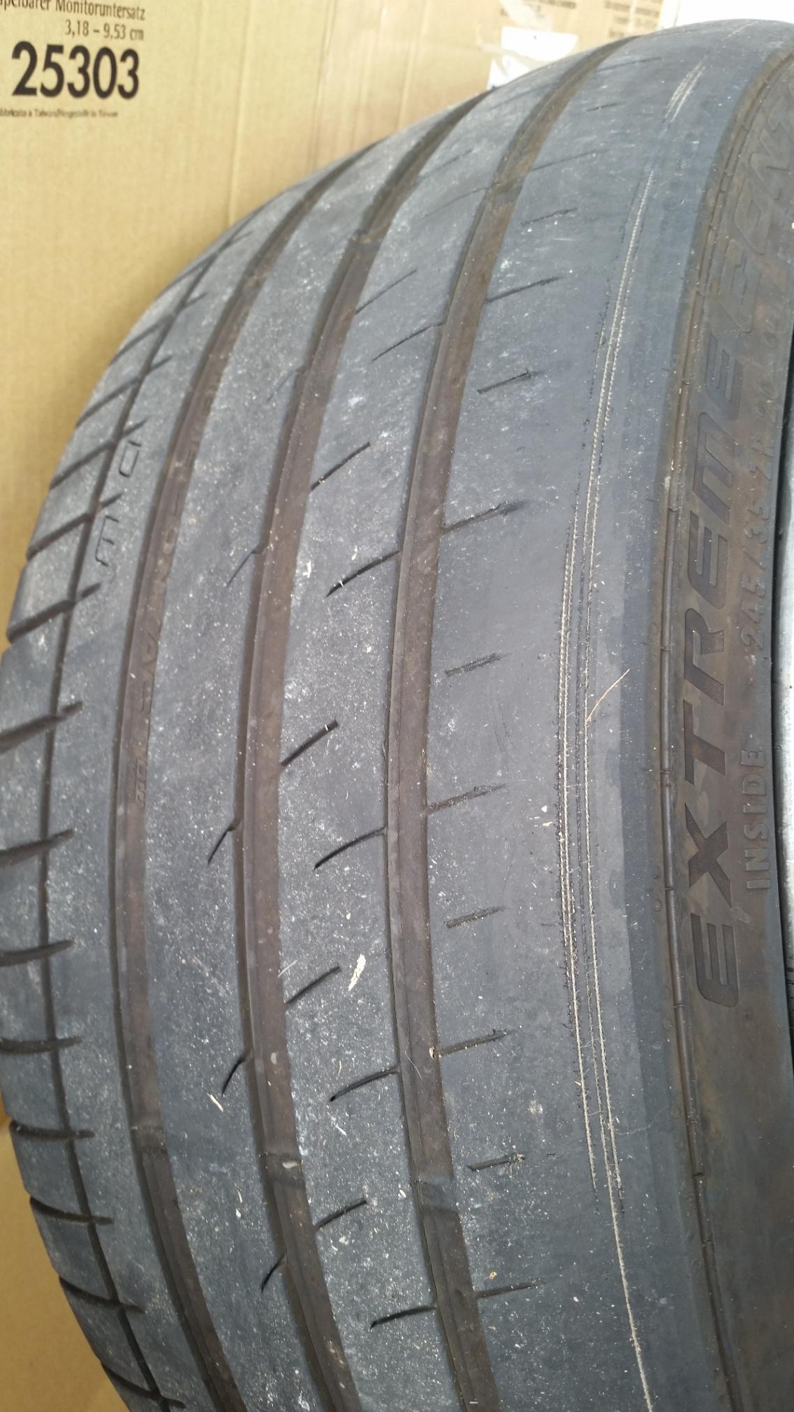

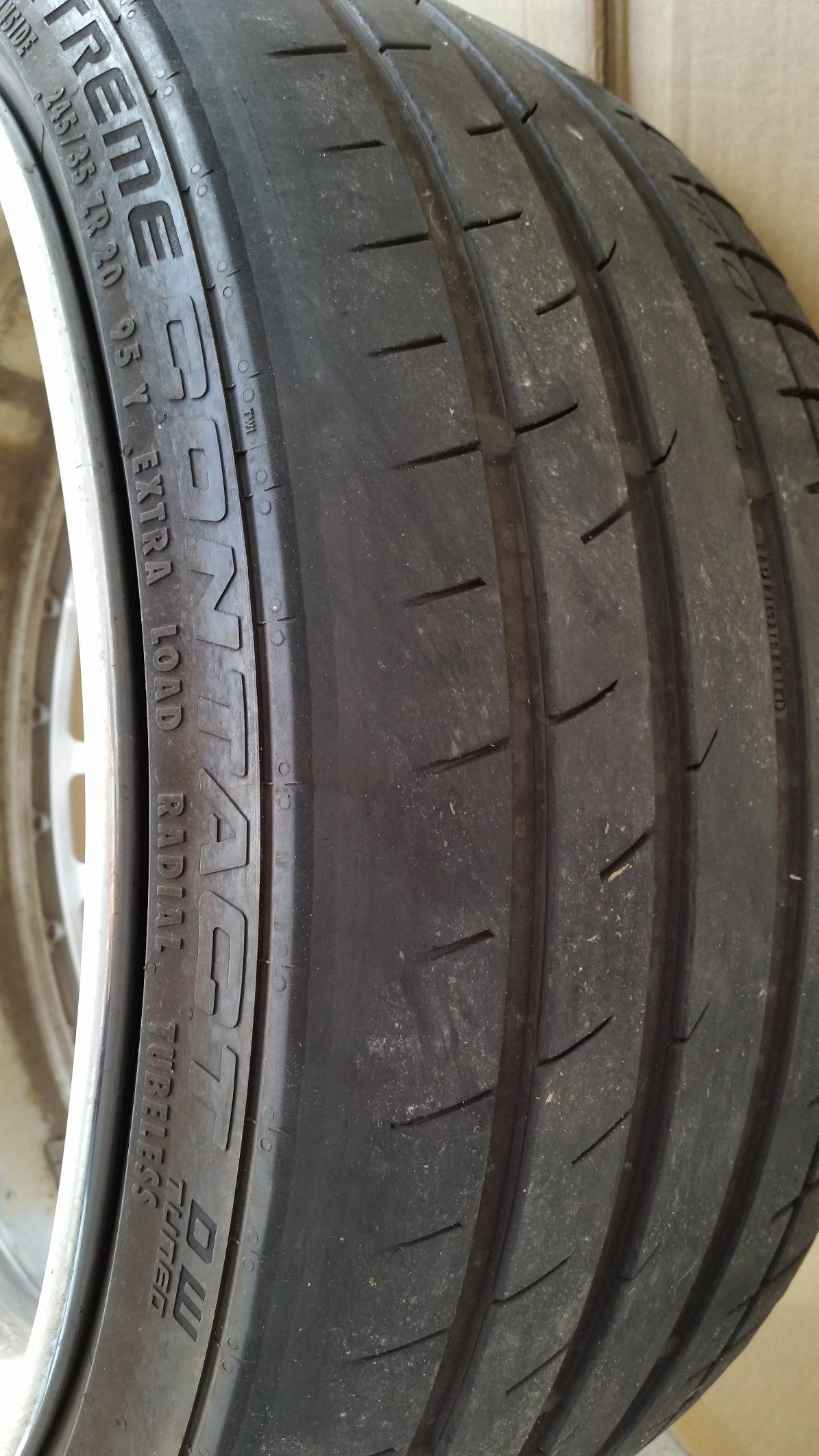

Do I Need New Tires?

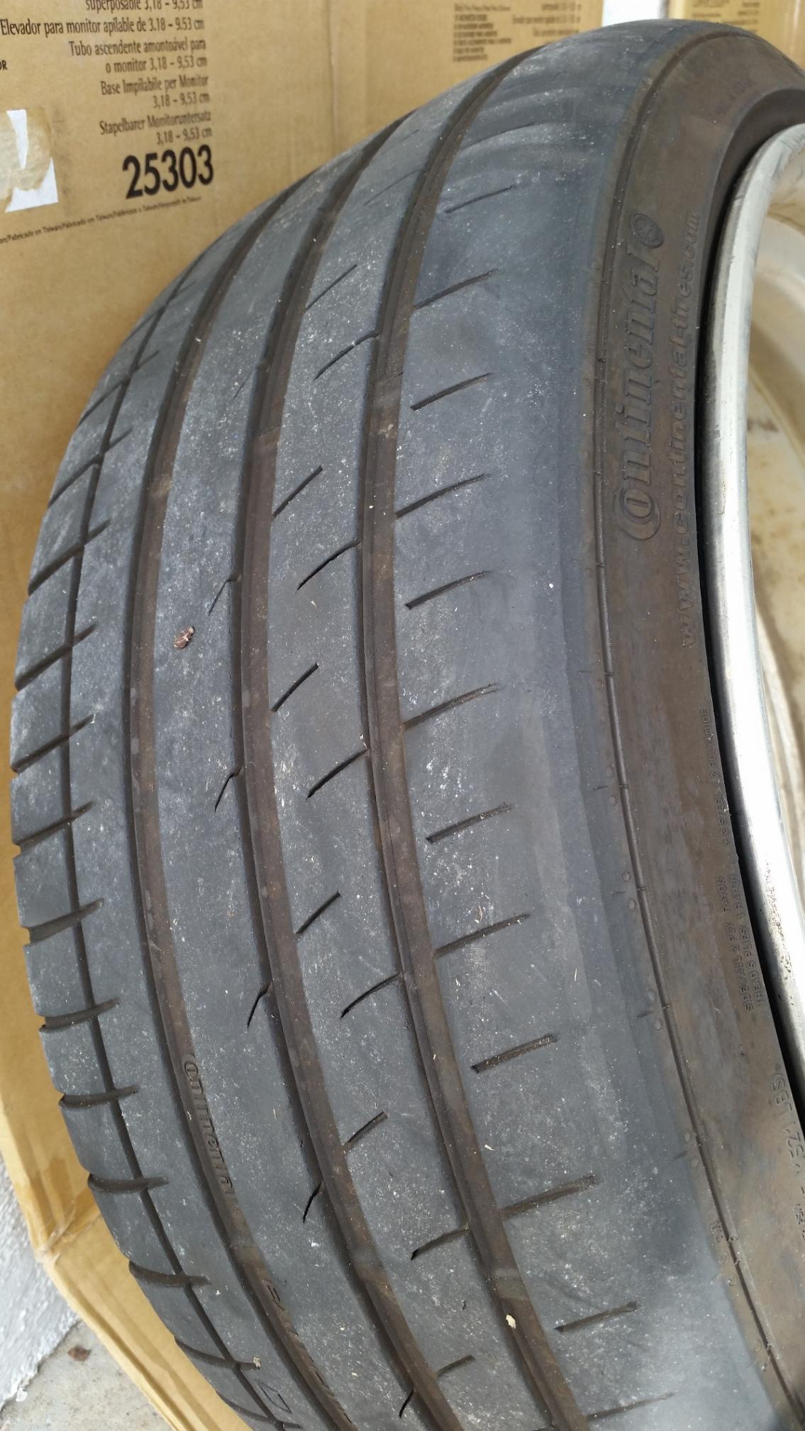

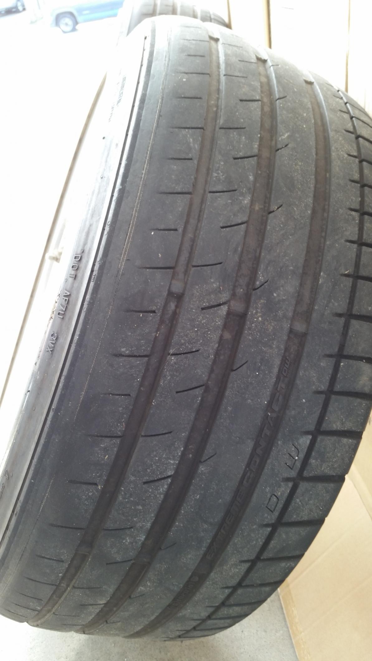

I'm really hoping someone here with more experience can help me out here. My car is set with negative camber to prevent rubbing and I know uneven wearing is to be expected. Today I pulled my front wheels off and noticed that the inner tires, especially the passenger front, is worn really bad. If you look closely, the passenger side tires even appear to have the white stitches showing. The driver is just balding but headed that way as well. However, there's still so much tread on the rest of the tire that I'd hate to waste it if I really don't have to.
So what do you guys think? Replace right away or do I have some time?
Thanks in advance.
Note: the first 2 pics are from the driver side front and the next 3 are from the passenger front.

Thats just an accident waiting to happen. I would think with the tread showing like that it could blow at any time.

Wear bars is showing so that means new tires.

Sunny, the "wear bars" that you mentioned...are those the "white stitching" that is showing? Also, I've heard of tire flipping before but I thought they could only be flipped on directional tires (seems like you're saying otherwise)?

Those white lines are not the wear bars. Sorry for the misinformation

Those white lines are the inner structure of the tires and not the wear bars. The wear bars are rubber blocks that run across the tread from one side to the other...you're way, way past those. It looks like you have about 90% of the tread left on the rest of the tire and probably will end up the same way in about a year when you replace these again. You can think about it this way. You're throwing away 90% of the money you'll be spending on new tires since running that much negative camber is bad on tires. It's probably not doing your front bearings any good either.
Edit: that last pictur on the right shows the wear bar. It the line going horizontal across the tread.

Speed racer is right those aren't the wear bars. For some reason I kept thinking the side wall structure lining were the wear bars. Sorry for the misinformation. Thanks for the correction.

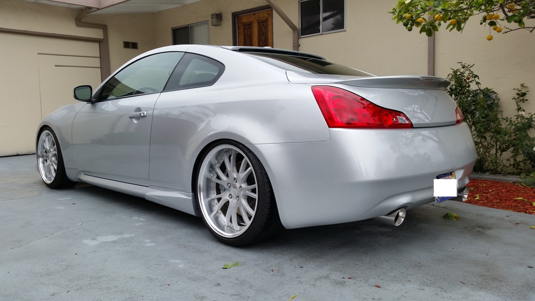

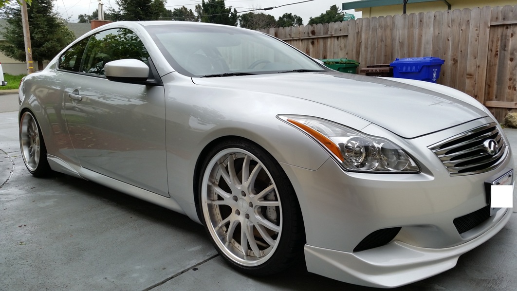

Post a pic I would like to see if there is room to work in a camber kit for both front and rear. Im uploading some pics right now to give you an idea

Yep, throw us a pic or two. You may be able to roll the front fenders to give you more room and then get camber arms to get back into spec up front. The back should already be rolled so not much you can do without pulling out the fenders a bit. If you're not really attached to the wheels you might also consider going w/ something w/ an easier fit and resell your current wheels.

Here are some pictures...thank you sooo much guys!!!

You have a toe problem. If you don't get the front-end re-aligned, you'll wear the new tires the same way.
