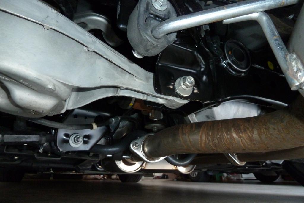

As far as the toe slot DIY, you only need to elongate the inner side of the slot (facing the differential pumpkin). The kit comes w/ a template that you use to scribe or mark a line to cut out. And like I said you only need to cut the inner side of the slot not the whole area in the template. I used a dremel tool w/ a thin metal cutoff wafer and it was pretty simple, the toe bolt goes into a metal housing that has two metal channels(that hold the lower control arm aka spring bucket) so you have to cut out the slot on both sides, so a total of 4 cuts, 2 on the drivers side, 2 on the passenger side.

SPC Rear Camber Cam Bolts (370Z / G37)

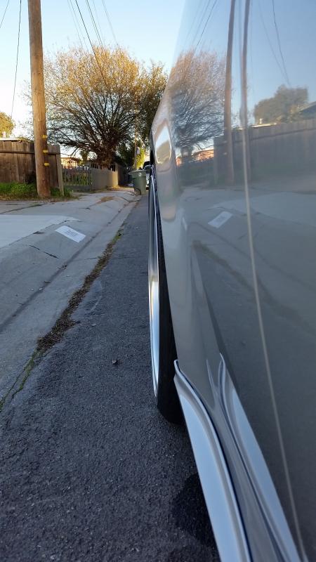

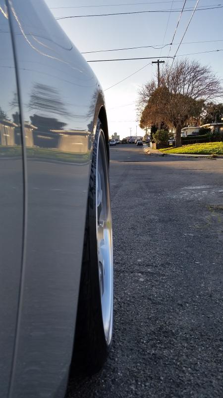

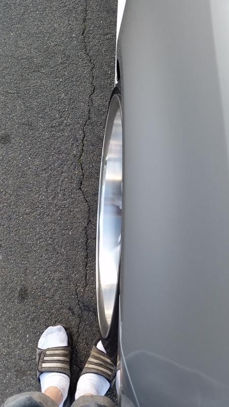

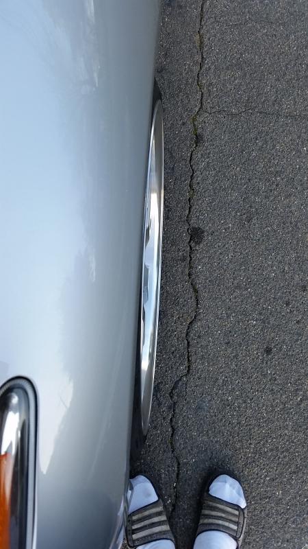

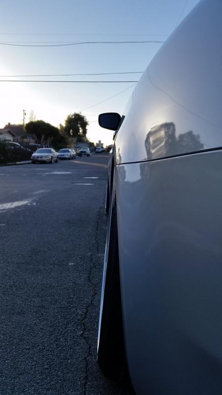

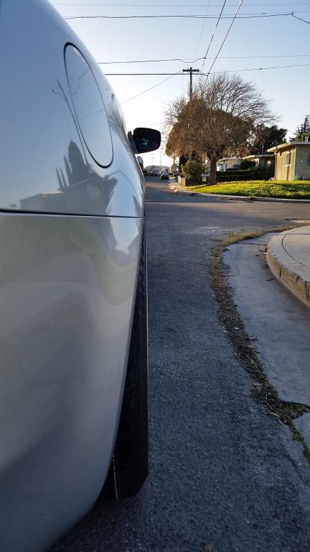

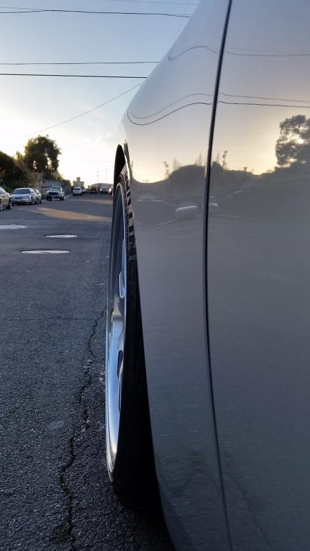

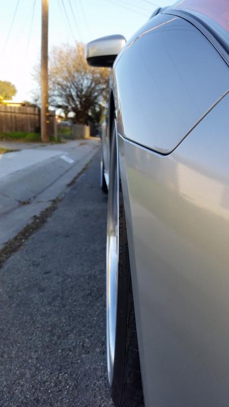

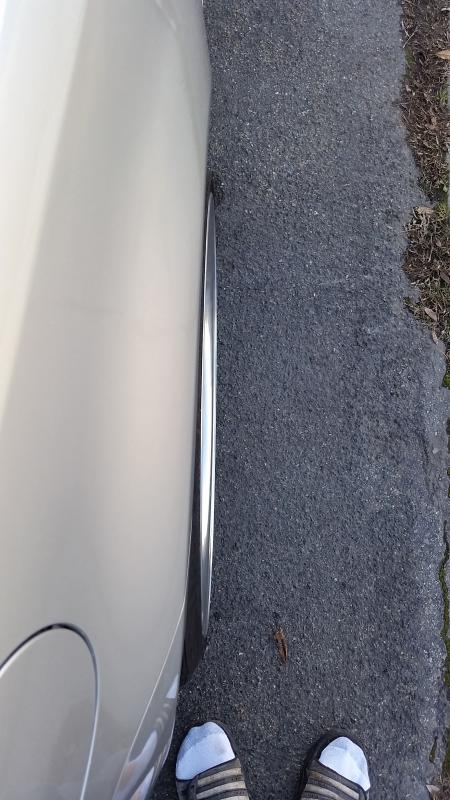

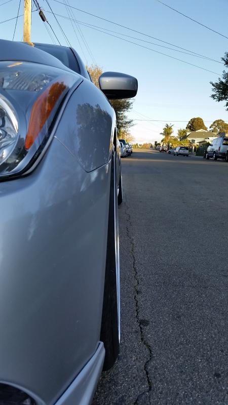

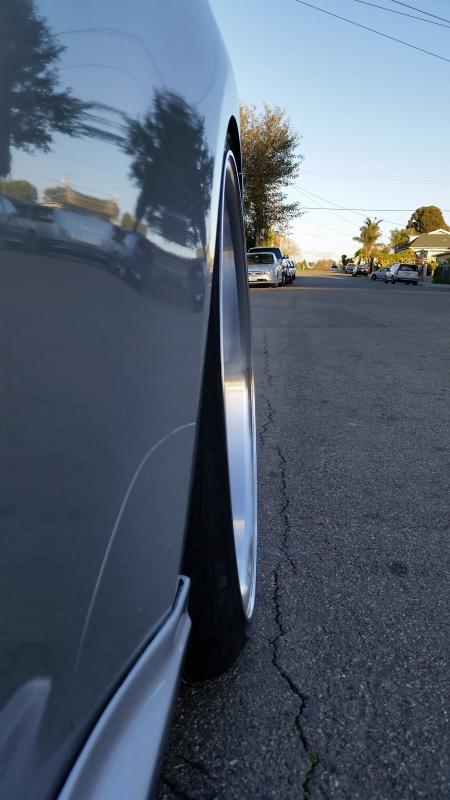

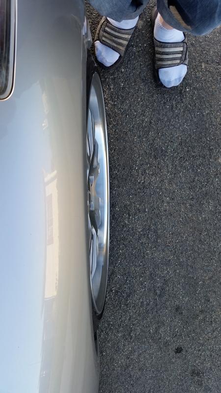

Thanks for the pics.
The front definitely has room to get camber much better, and since the rear is a stretch mount it looks like you can square it up some more. Your alignment tech should be able to get your camber arms set just to the point where you clear the inner rear fender, hopefully that will get you to a point where you're not cooking those back tires too quick. This is assuming you also have teh rear toe bolt kit as you'll need your toe in spec regardless of wherever your camber ends up.
The amount of front camber looks like a natural amount of camber just by dropping it that low without any aftermarket camber arms. I assume you don't have any front aftermarket camber arms and if so you WILL need to get some to get that camber corrected up front. Luckily toe is fully adjustable in front.
G/L and keep us posted.
You're right, I have no camber arms up front or in the back, everything is stock aside from the springs. In spite of that though, would the camber still be able to get back into spec up front (even if I can't 0 it out) or that's not at all possible due to the drop? If not then I guess I can just ask them to make it closer.
In regards to the rear, is it at all possible to adjust the rear toe without the kit at least to spec or that's not possible? I know I probably won't be able to hit 0 without the kit but I'm curious if I can at least get it within spec. The reason I ask is that I reviewed a DIY instruction/video about how to elongate the slots and I actually don't have a power dremel to do so. At first I was going to just manually dremel it out until I saw how much surface area had to be removed.
Judging by the pictures, how bad does the current setup look as far as burning through tires go?

Here's exactly what I would do, step by step:
First, purchase front and rear adjustable camber arms. SPC and SPL are the two best brands to go with. This will run you around $400 but it'll save much more money in tires in the long run.
Next, buy new tires, bring it to a shop and have them put the tires on, install the camber arms and do an alignment to adjust camber and toe. (Look for a shop with a road force alignment machine, ask what brand the alignment machine is, Hunter is a good one)
Finally, they'll give you a print out sheet of what your camber and toe specs are. With the camber kits, you should be in spec and shouldn't have to worry about tires for awhile.

You won't be able to get the rear in spec with the camber arms and still keep from hitting the fender, at least from what I can see from those pics. What you can do is get the kits and get it as close as you can without hitting the fender. If you're currently at -4 degrees in back maybe you can get it to around -2.5 which is much better and w/ toe in spec you should have reasonable tire wear.
I'm a bit surprised you would have that much negative camber without camber arms, a deep drop like that on stock arms results in about -3 degrees give or take. Each vehicle does drop a bit different though so YMMV.
As far as rear toe, you will need the kit to get toe in spec when you're dropped that low, and camber & toe are related, so when you drop real low you usually need the camber arms along w/ the toe kit to get it right.
The rear kit is pretty affordable, about $150, the front is the biggie, about $350. If you burn through tires twice as fast or even quicker that $500 pays for itself pretty fast.
