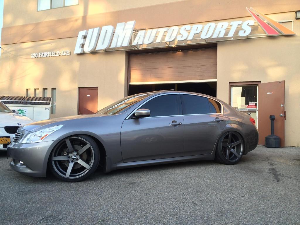

The new look for the summer... pics will be upload it shortly...
Thank you for all the input...

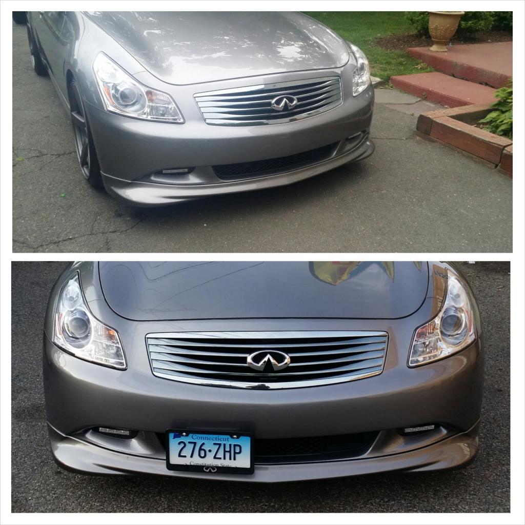

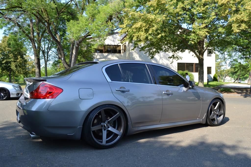

[QUOTE=jnova;3792058]
[IMG]http://
[/IMG]
{STR 607 20X9 235-35 Nittos, 20X10.5 - 275-30 Nittos - Megan Racing coilovers- GMG Motorsports NO HOLES license plate relocator - OEM sport front lip - Duraflex GT spec roof spoiler} more to come.....
[/IMG]
Must say you've put it all together very well, love that wheel color w/ your cars' paint. The drop and stance looks just about perfect, did you get it aligned yet? Where did you set your coils, I have mine about a third up the firmness scale.
All aligned... I'm in 13 from soft for comfort ride... Front responds well rear is a bit stiff...
