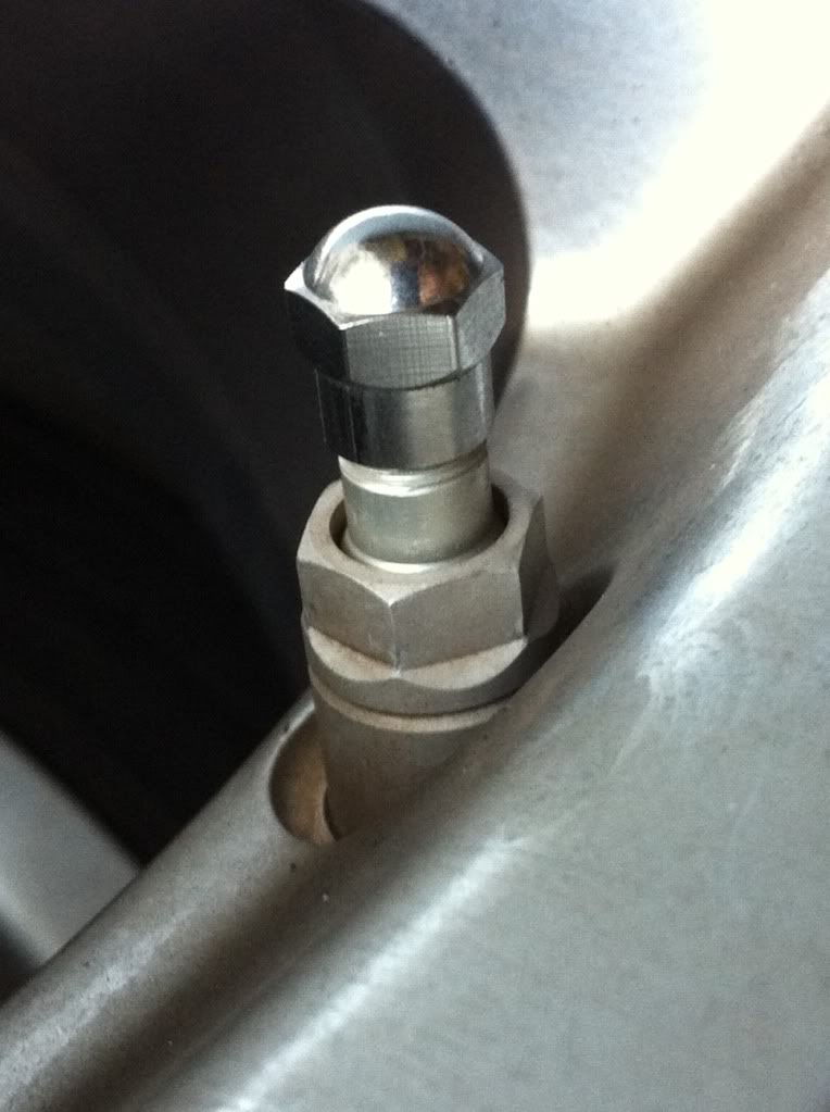

Here's the nut, doesn't appear to be a sensor tho. Honestly I can't tell...but I don't have a warning light on.

This is really odd then cuz mine looks the same, but like several have mentioned it would have been odd for them to remove my old sensor and remount the tire without asking:

The picture you posted are what the valve stems on the OEM TPMS look like. Those don't appear to be brand new valve stems. Do you have brand new rubber valve stems on your old wheels you took off? If so, then it would appear that they did dismount your old tires, remove the TPMS, and place them in the new wheels. Make like Colombo and do some detective work and figure this out. Use the clues.
