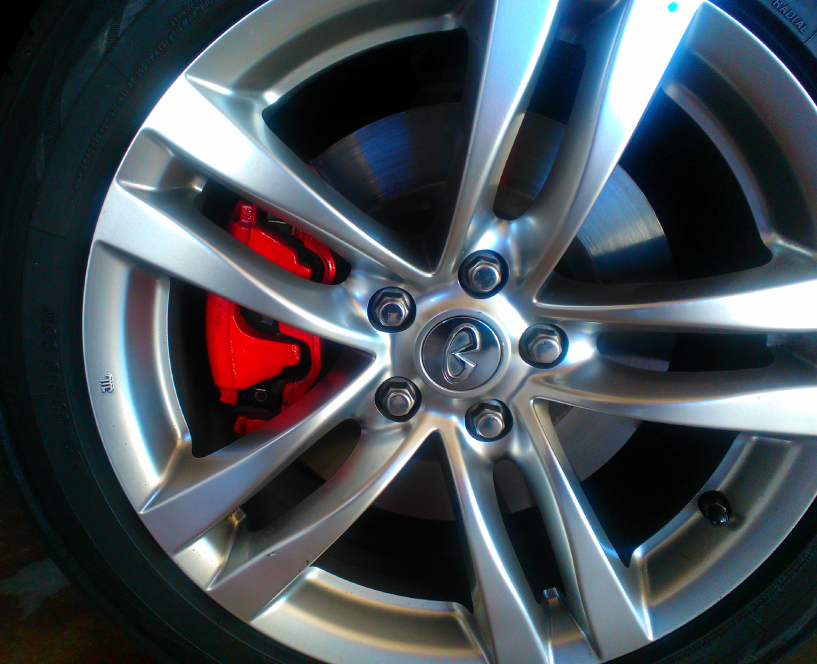

I used the G2 brake painting kit from amazon, and i think it turned out great. I just took the wheels off, masked off the rotors, and painted the calipers with the paint. The included brush is good for about 2 calipers, then you need a new one, so any of those little bristle brushes from michaels, home depot, lowes, would work fine. 1 can of paint in this kit let me put about 3 coats per caliper on and i still had 1/4 of paint left.
High Temperature High Gloss Self Leveling Brush On Red G2 Brake Caliper Paint System Kit : Amazon.com : Automotive High Temperature High Gloss Self Leveling Brush On Red G2 Brake Caliper Paint System Kit : Amazon.com : Automotive
