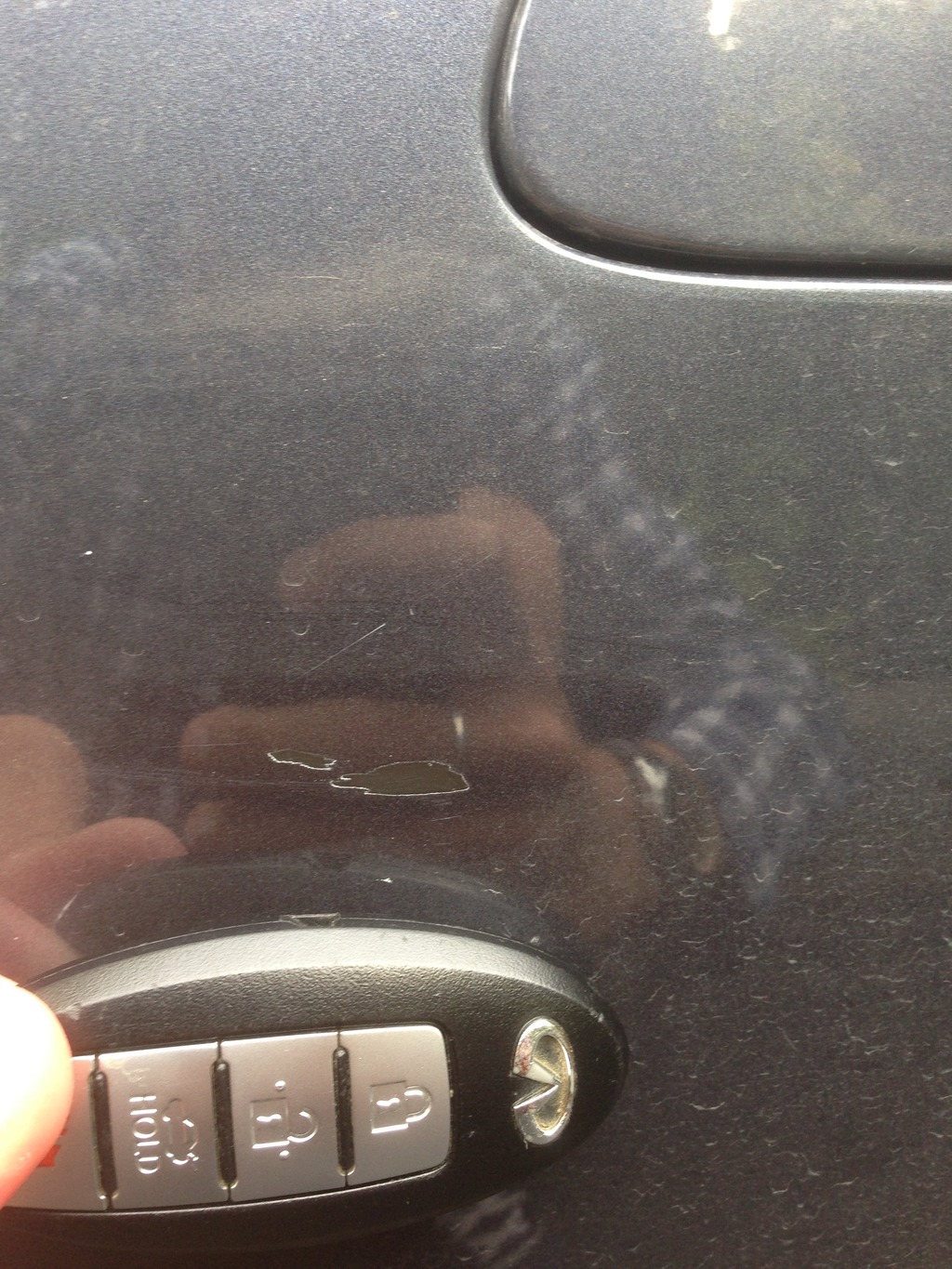

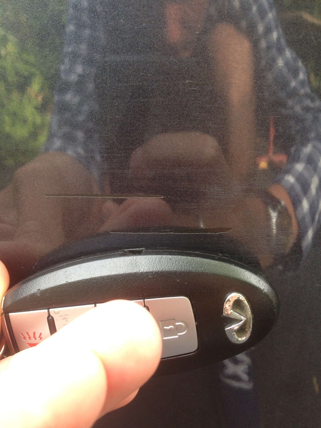

Lease is coming to an end. AutoVIN (lease inspection company) did an inspection of the car. They found two of the three scratches in the pics below and are wanting to charge me $300.
How easy would these scratches/missing paint be to fix? My car is K52 colour. I was thinking about just using a bit of touchup paint then buffing to keep things looking uniform and smooth. I am in Toronto, Canada so recommendations for local suppliers would be great!
Thoughts?

Most of those look through the clear and a little paint so buffing/polishing won't work. For a quick fix I'd say touch up paint.

First, those are NOT small scratches and you'll likely have little positive effect by using the touch up paint on them. The scratches are through parts of the paint and clearcoat, and that paint chip will NOT buff out. Since this damage was already documented on the inspection, I'd say you're better of paying the $300 and calling it good.

I'd just swallow the pill at this point. If you did a decent patch repair prior to getting it inspected it may have gone through, but since it's now on record they'll go over that w/ more scrutiny.
