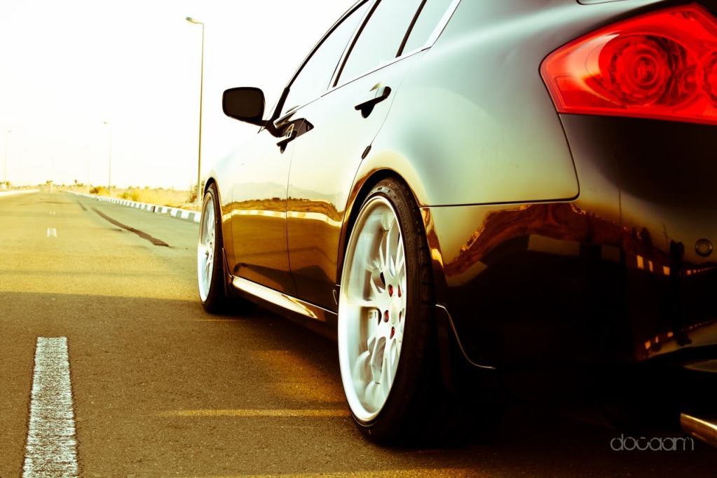

Without lowering the car, the rim of the wheel will stick out just as you see it on the blocks. You mentioned that you will be lowering the car with Eibachs in the future. Once you lower the car the natural camber that will be created will tuck the rim of the wheels in further.
To give you an idea of something similar, here is another member's car. He is running 20x10.5 with a 35 offset in the rear. He is lowered with, I believe, 1.6 degrees of camber in the rear. Take note, his wheels are 20x10.5 as opposed to your 20x10s.

they fit fine ive run 20x10+35 on rear with 275's and never rubbed even with the car full off people.
