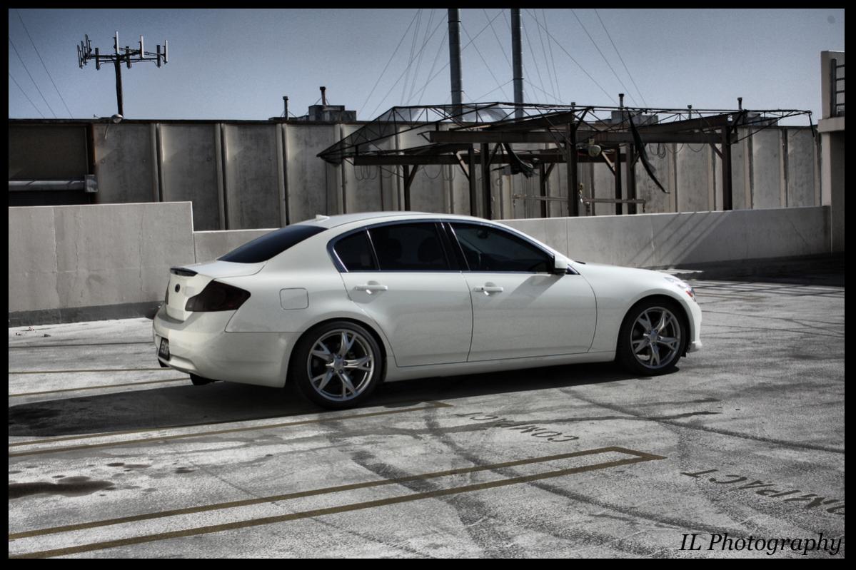

I love the 370z wheels, I have a 2012 g37 sedan non sport, will these fit without any issues, I see some have them, I don't want to lower or do anything, I need to know if these fit, and what size tires I would need front/rear, thanks for the help, I appreciate it!! wheel size are 5x114.3 front 19x9 +47 and rear 19x10 +30

Yes it should be fine. I dont know much about wheels but all OEM nissan stuff works well with other nissan cars. A friend of mine but these wheels on his Max and it was fine

They will "fit"....however without lowering your vehicle you will have a hard time running the rear wheels. That 10" +30 is going to stick out past your fender a good bit unless you drop the car. Even the sedan pictured is lowered. The front offsets are pretty weak too... So you're looking at a front wheel that is really sunk into the wheel well, and a rear wheel that is sticking out way past the fender. Wont really work well on a stock sedan.
