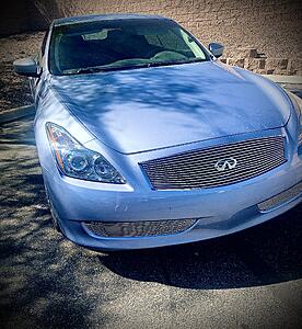

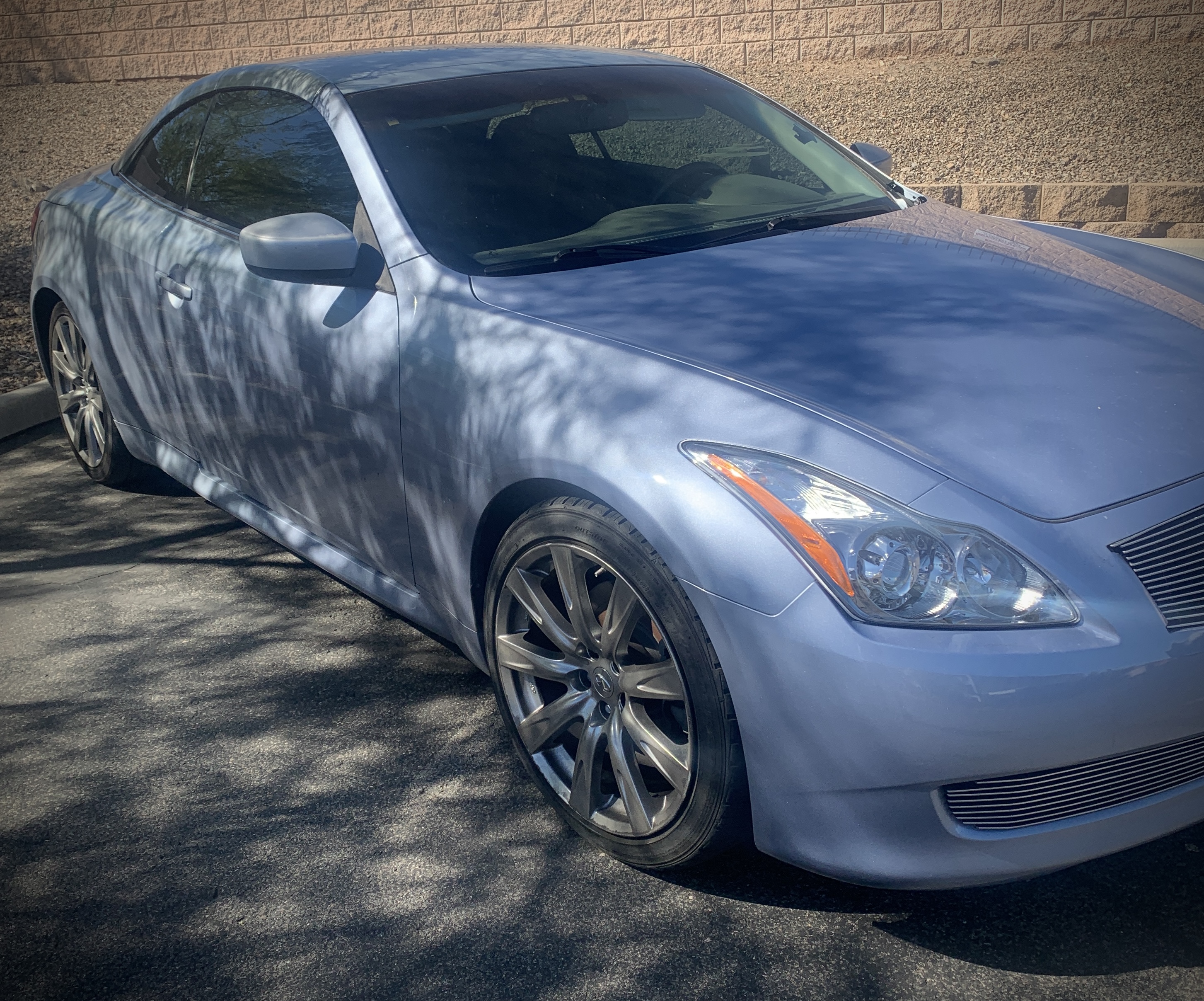

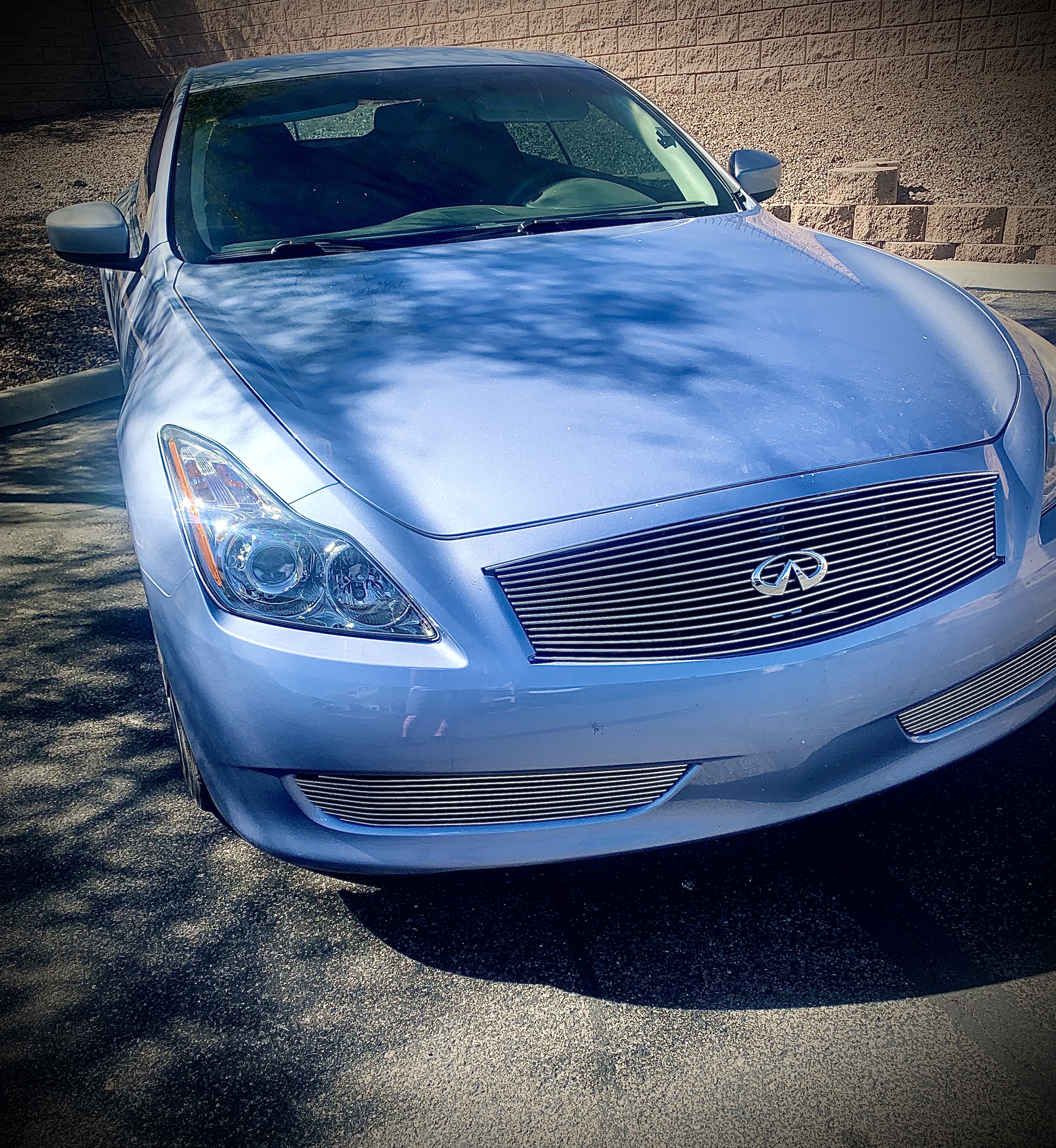

My G37 2010 sport vert
I’m running with 245/40R19 all around.
Mechanic at firestone recommended not driving freeway until
I get the right/recommended size tires.
I do notice some shakiness/sloppiness at freeway speeds.
Is it a big deal or not ?
Does he just want to sell me tires?
Attached Thumbnails Staggered wheels on G37x-img_7560.jpeg   Staggered wheels on G37x-img_7559.jpeg
