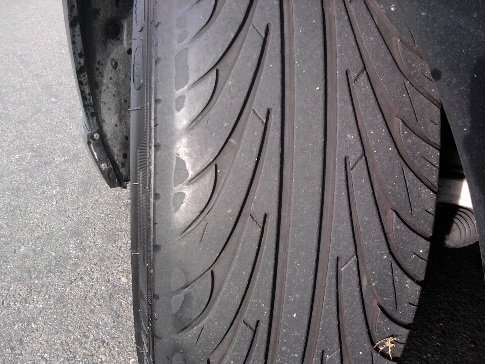

I didnt realize how bad my tires were until i just took that picture. how much longer do you think I could run these tires because the insides still have a lot of tread on them. The two front tires were swapped yesterday. Times are tough and moneys a bit tight to spend on tires.

holy sh*t^^ your tires are as bad as mine and I'm slammed on KW's!!??? I'm actually suprised a shop woudl actually swap the tires for you? Where did you go?
I called tires plus and they wouldn't even swap them for me. They said most shops won't swap them ANY part of the tire is under a certain tread depth because of being a liability, and the very edge of those is SHOT.
Did you get an allignment too? It seems like its gotta be off if its just ont he edge like that and you're only on eibachs. you mayyyy want to start saving for camber kits my friend :-) I just ordered mine from TMmotorsports on here. Nick's def the sh*t!

Also...the tires you had swapped are actually pretty dangerous to run. you literally have NO tread left ont he outter wheel, and what happens if you hit ANYthing sharp to puncture the tire? can say goodbye to your mint wheel...
