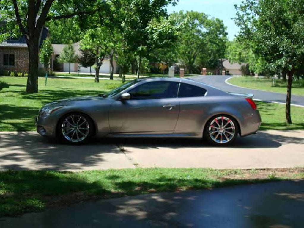

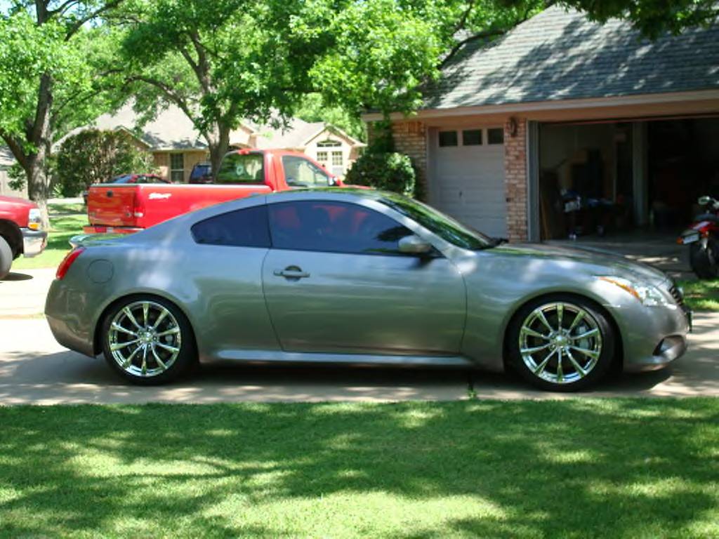

I'll get there someday, here's two more The second one is stock chrome rims with 1 7/8" drop no rubbing

I want to drop the front some more but don't want to go to far b/c of alignment concerns. I've got the camber kits for the back and think I'll drop it another 1/2 to 3/4 of an inich. I'm wondering if anyone has the GT 30's and how much of a drop in the front will the factory set up take and still manage an alignment? Here's another pic of the stock chrome rims with the 1 7/8" front drop . I think it looks pretty good but I'm TOG! (the old guy)
