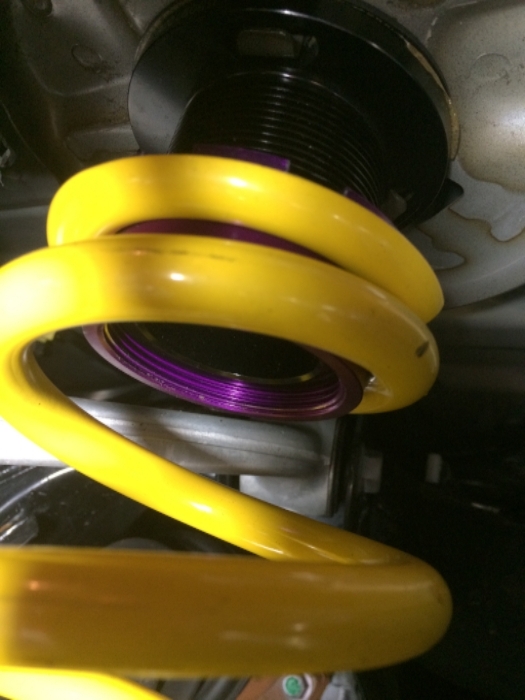

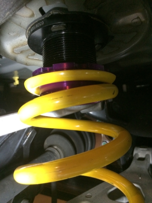

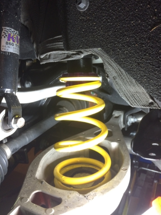

OK so got over to the lift today.
Fronts now sit at 26.25 with plenty of adjustment left in either direction.
Rears still sit at 26.125 after adjusting the fronts. I am ok with this setup for now and will get an alignment. I think the 30mm spacers are on backorder right now so may be some time before i can get those and install them.
Here are some pics of the rear install. In the first pic you'll see what i mean with the purple perch sitting about 3 threads too low on the black housing. Once i have the spacer I'll correct this even if I decide to stay at this height.
Yikes!
I know you want your rears as high as they can go with those particular CO's, but are you genuinely comfortable sacrificing 3 threads of contact on that ring? That seems like a mechanical engineering no-no. That you had to do that in order to come *up* to 26 1/8" suggests to me these CO's might not be the right fit for you.
Your spring design is so much different my my Teins. Yours are narrow at the top, with wider rungs. And look how much thread exposure you have on your adjustment compared to this pic, when yours is actually sitting 5/8" lower. That's amazing.
Apples and Oranges, I guess.

...Yikes!
I know you want your rears as high as they can go with those particular CO's, but are you genuinely comfortable sacrificing 3 threads of contact on that ring? That seems like a mechanical engineering no-no. That you had to do that in order to come *up* to 26 1/8" suggests to me these CO's might not be the right fit for you...
^^^ This. So much this. If your shop doesn't aggressively dissuade you from keeping this configuration, you should remove "reputable" from their description.

Thanks for all the responses guys. Actually after sleeping on it Saturday night I decided to change the rear set up again to be flush with the bottom of the black housing - so no threads hanging off. While i think the 3 threads hanging off was 'probably' ok - decided it wasn't worth finding out the hard way that it's not.
