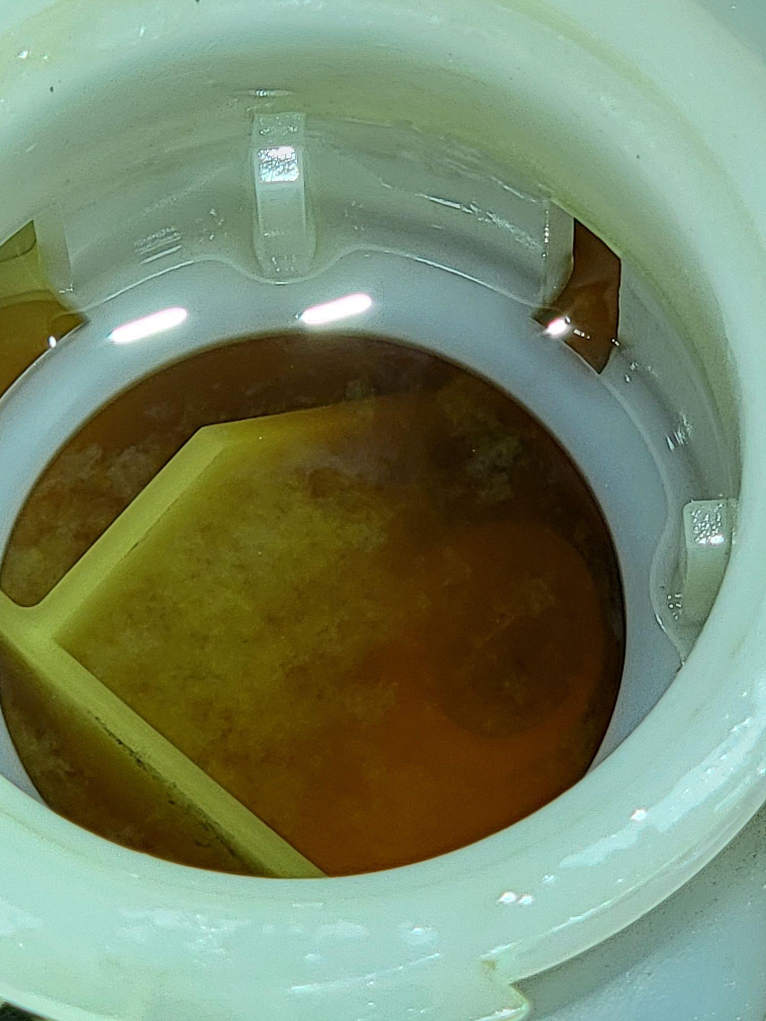

UPDATE: As I've inspected my car some more and checked the fluid apperance.. tried as best I can to find any leaks near the reservoir and around/on calipers/rotors/tires (car is pretty low), I've so far come to the conclusion that my original instinct is correct -- there is air in the lines. I tried depressing the brake pedal a bit and after the 2nd press I felt the pressure. The only thing I don't get is how it's already this bad after only 14 months. I'm thinking I should try DOT4 and I have seen mixed information online but it's possible 5.1 just absorbs water faster.
Here's how the fluid looks:

That brake fluid looks too dark for being only 15 months old. I recommend a good DOT 4 fluid like ATE Gold 200 (which is widely available) to do a full four-wheel bleed. As for establishing whether the body shop was responsible, that's debatable. Not sure how you'd ever prove it, unless you could show how and why they'd pull a brake line doing bodywork.

They weren't sure exactly which brand it is so I called the other 2 stores in the area and they both use penray. I figure it's the regular, not the plus one.. because I don't see why they would spend on plus as most consumers probably don't care what they get.
https://penray.com/product/synthetic-dot-4-brake-fluid/
It looks like the standards aren't as stringent as it says "Wet Boiling Point 311ºF minimum" and "Dry Boiling Point Exceeds 465ºF" rather than a specific claim.
Yeah, I was in the same situation about proving it was something they did, which is what I was trying to rule out so I could determine if it's just a really bad coincidence. I ended up concluding that it was and in the meantime I've also pulled the only wheel they would need to pull off and there's no damage to the brake lines. Additionally, I believe their claim they didn't remove the wheel because of the feeling/sound of breaking the lugs free. I don't think they would have been that way if they were recently put back on.
Anyways I am going to have JiffyLube flush the system and take a look at it tomorrow. I know the staff there a bi, they aren't braindead, and I live nearby. Should be operating fine tomorrow and I'll see if we can find if there's a leak/problem anywhere.
