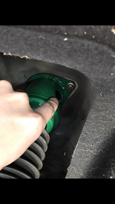

Old Oct 30, 2017 | 12:52 PM
  #22
xxg00w0's Avatar
xxg00w0
Posts: 698
Likes: 29
From: los angeles
Originally Posted by chrisko
You should be able to access it by just taking the wheels off. Assuming that you can reach up there, you don't need to remove the struts.
ok I see what you were talking about. I was able to stick my finger in there and turned the ****.
Thx
