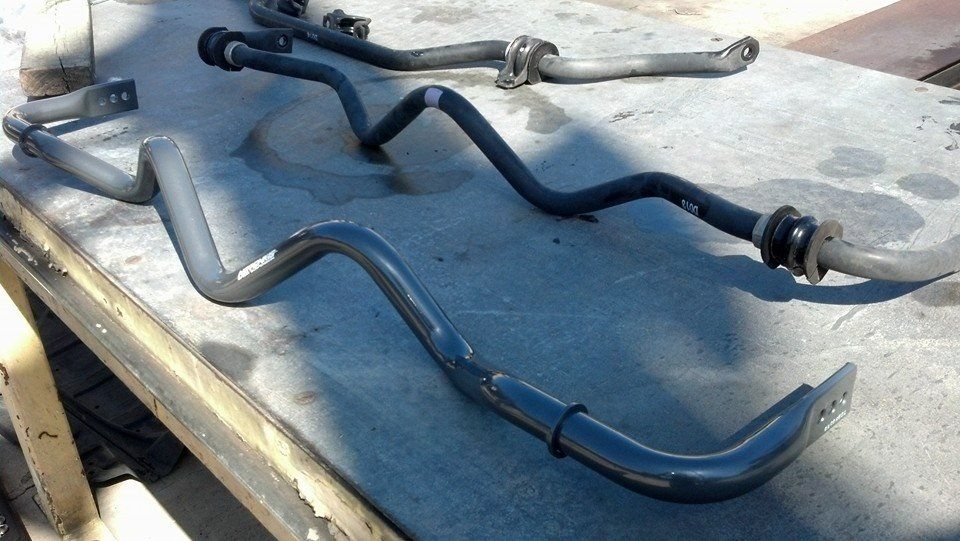

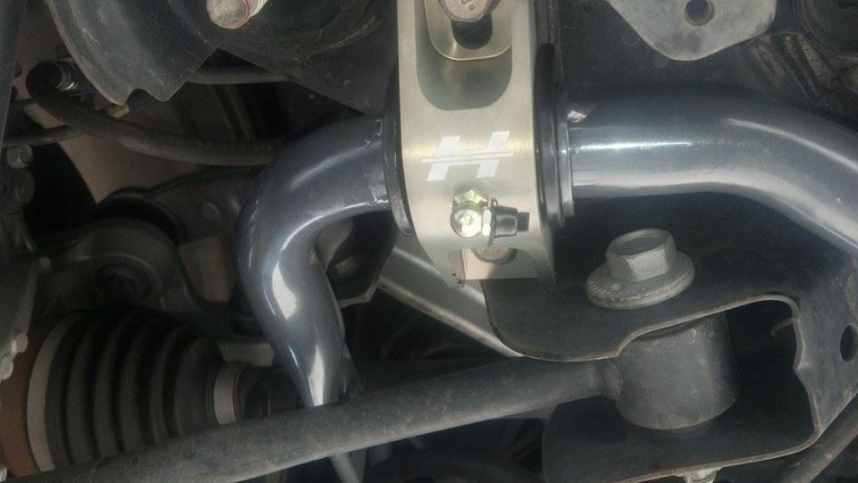

So I did disconnect the pipe (see photos below). Did this about four years ago. I also recommend the Hotchkis sway bar bracket upgrade with grease fittings, these have definitely paid off and make it easy to properly re-grease when necessary.
Hotchkis vs. Stock

Ends with grease fittings =).
