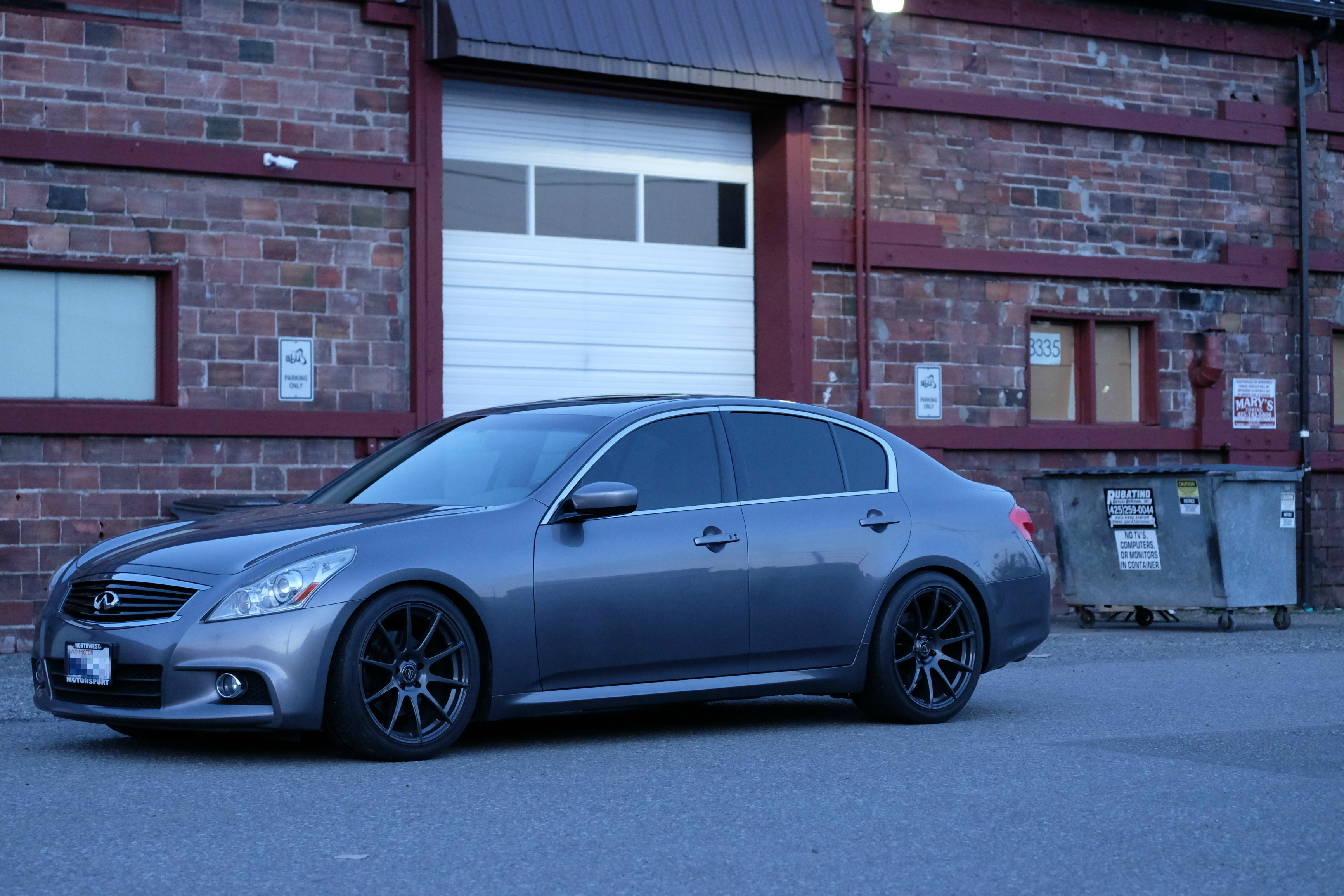

As a first stab at the setup I'm happy with the result.
Old May 12, 2017 | 10:54 PM
Likes: 4,952
So glad you got that rear shock situation remedied and hopefully brought enough attention to the problem that it won't happen to another member around here.
That height is definitely looking proper!
