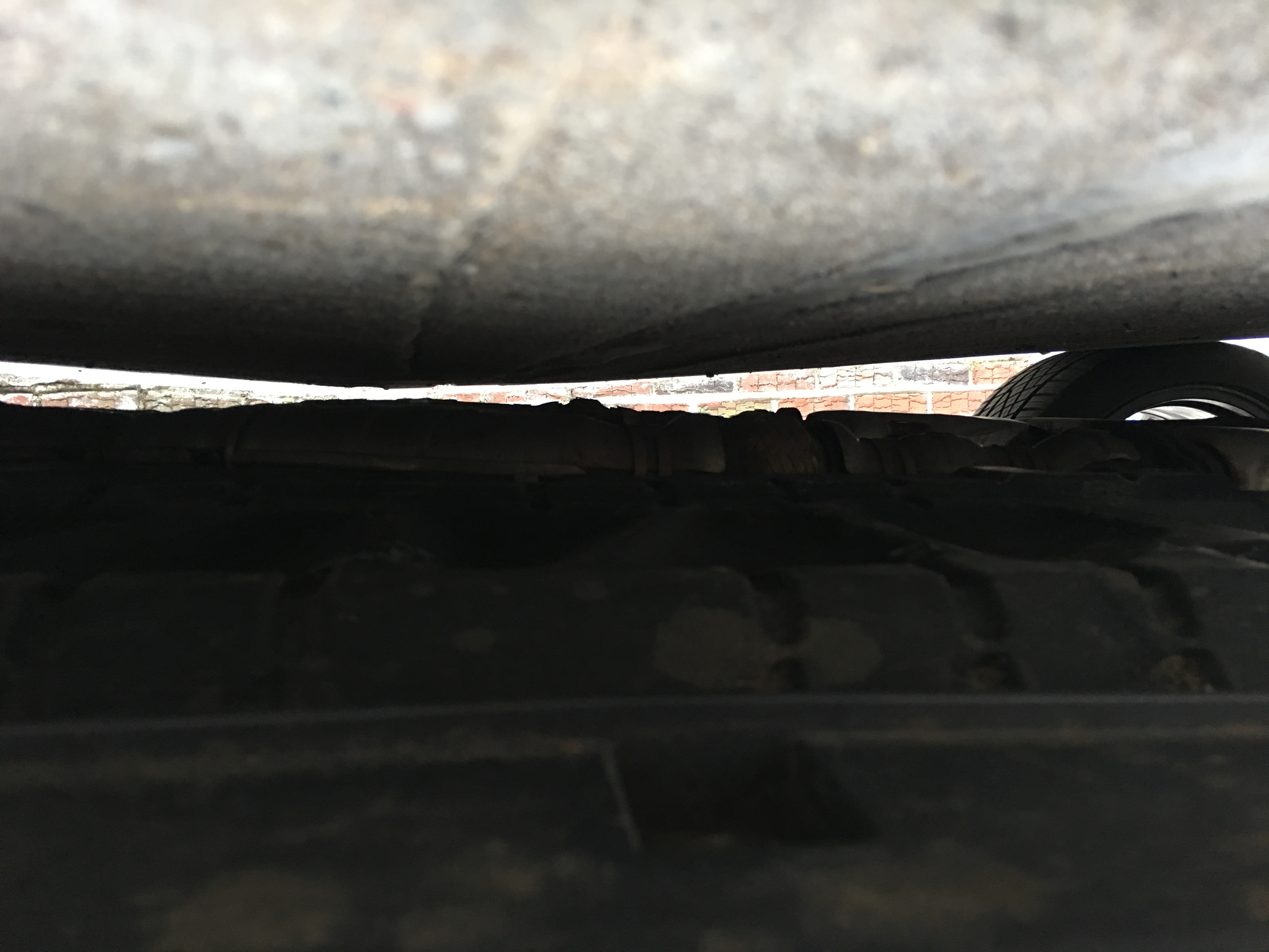

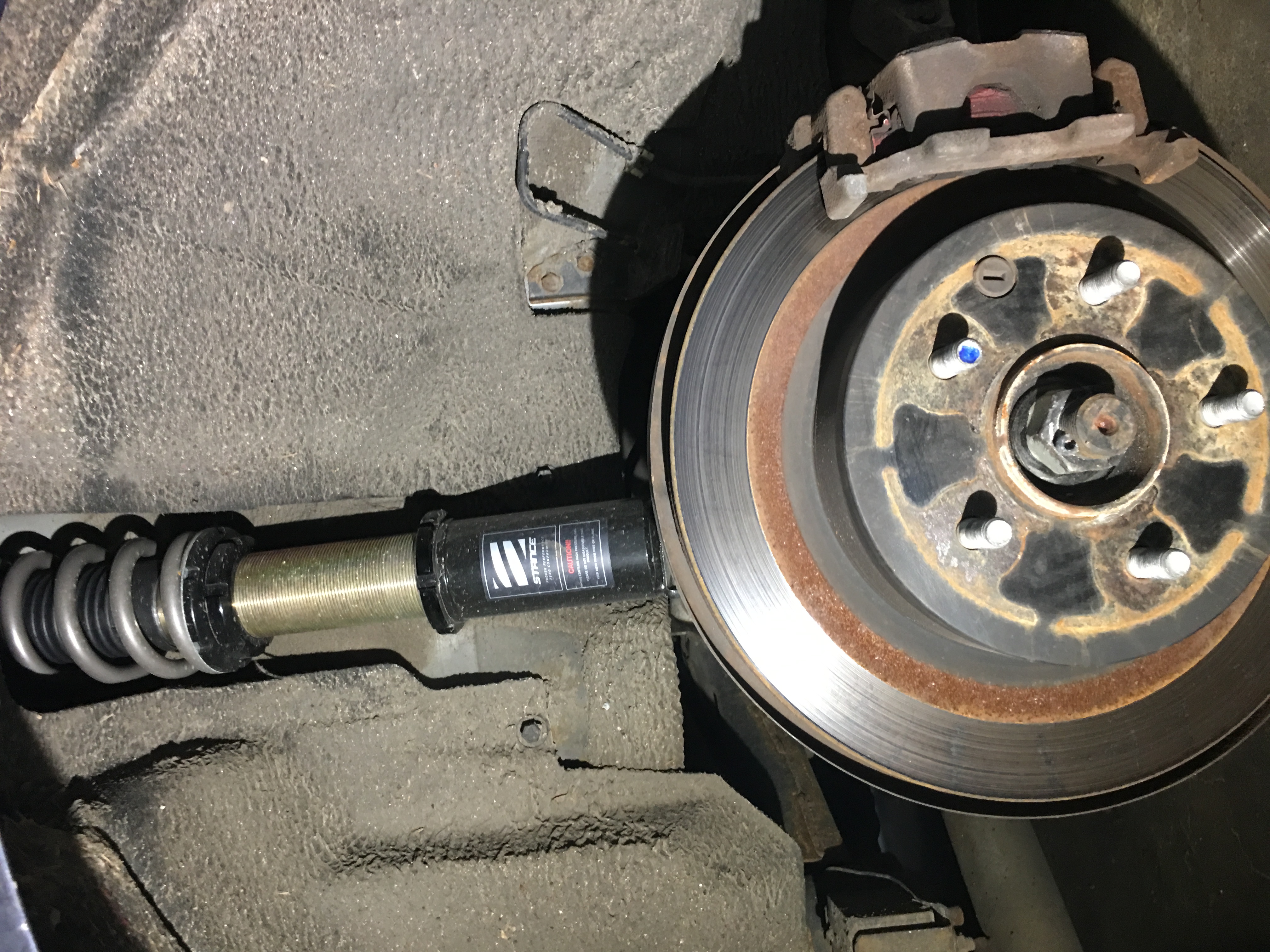

Installed finally! Stance true setup with SPL toe and camber arms. Ride height was 26” from fender line to the ground and had to adjust it as I always scraped when entering my driveway. Raised it to 26.5 and it’s perfect. Sucks I can lower the front anymore due to the driveway slope. Attached a picture to show how much clearance I have when driving down to the garage. I have the updated dampers so I can raise the rear higher if I wanted.

Looking good at 26.5, making your daily drives (not to mention your driveway issues) that much easier is worth that extra half inch IMO. I went up from 25.75 to 26.25 when I went w/ coils several years ago and never looked back
Congratulations on getting yours handled. Hope you're enjoying them! Your G looks great!
