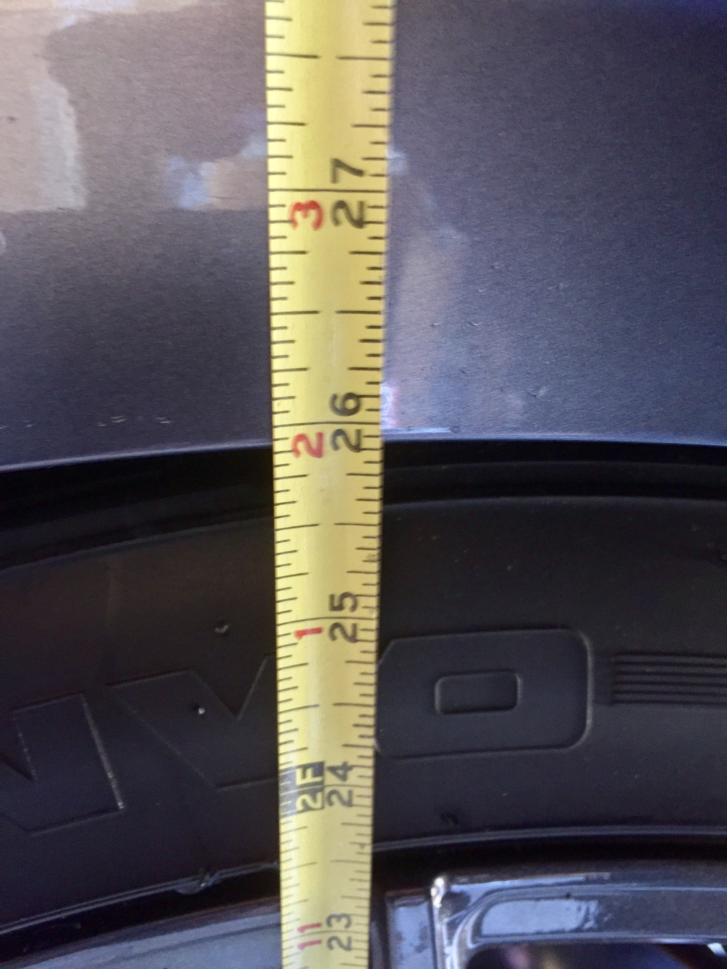

Coilover install today of Stance XR1's. A relatively quick install since there was no height adjustment option.
My 19x10 rears were just a tad wide at the outset, so the initial game plan was to simply drop the car an 1.25".
Wrong.
The rears were installed first - The highest setting of the coilover's created a near 2" drop. I don't know if this is "normal" for XR1's on an AWD G sedan. I'm guessing I'd still be dealing with the same "no adjustment" drop no matter how wide my current rears are?
Perhaps, if there was a plus side today, it's that the 19x10 rear's tucked. I'm not sold on these wheels or tires so if I'm forced to make a change to better accommodate the coilover's then I'll have to consider that. But I'm guessing no matter what I'm still going to end up with a rear tuck? Still, it was quite a surprise that the highest adjustment setting placed the rears in this position.
I'm brand new at this...still much to learn, obviously. I'll place a call to the rep tomorrow....more later.

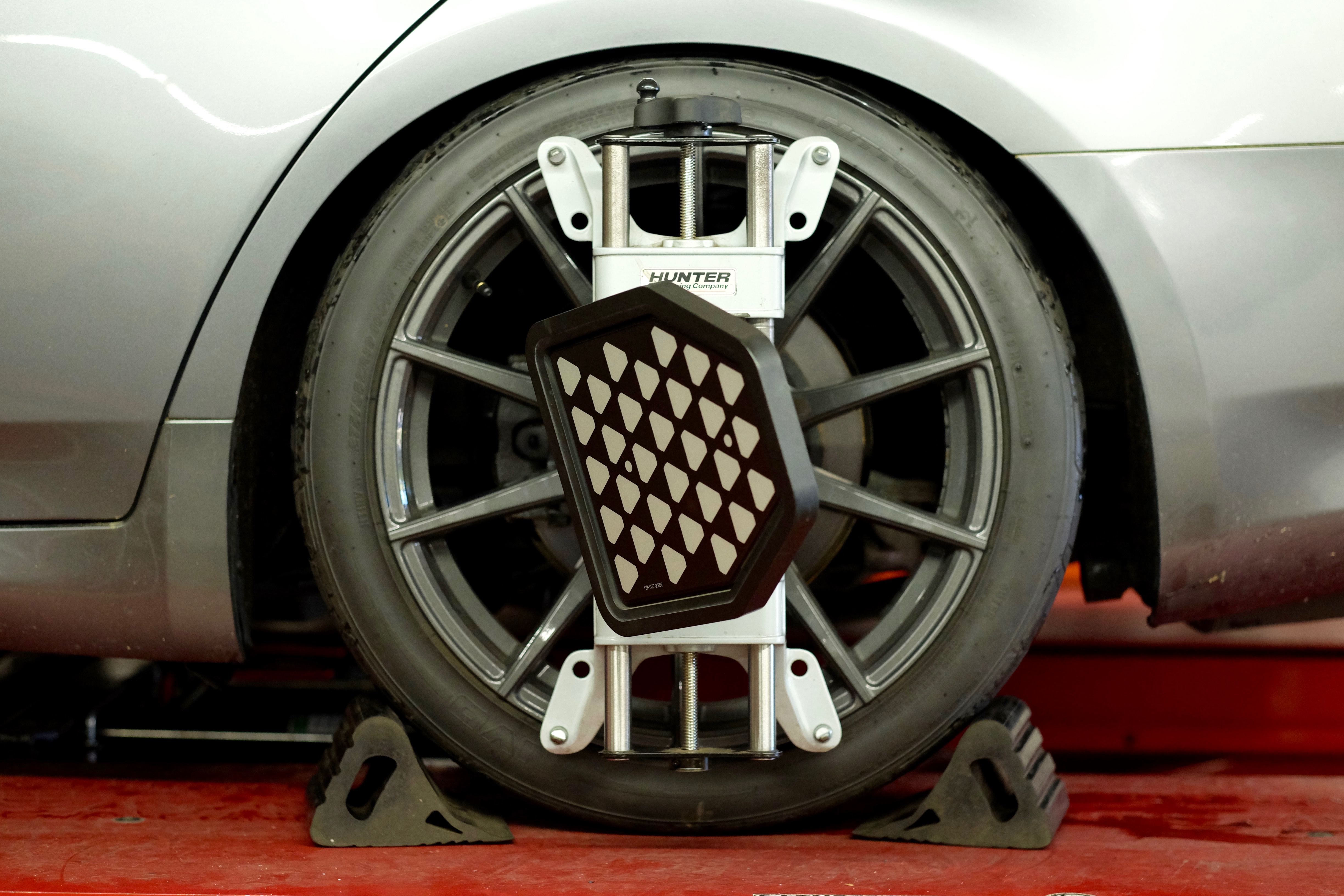

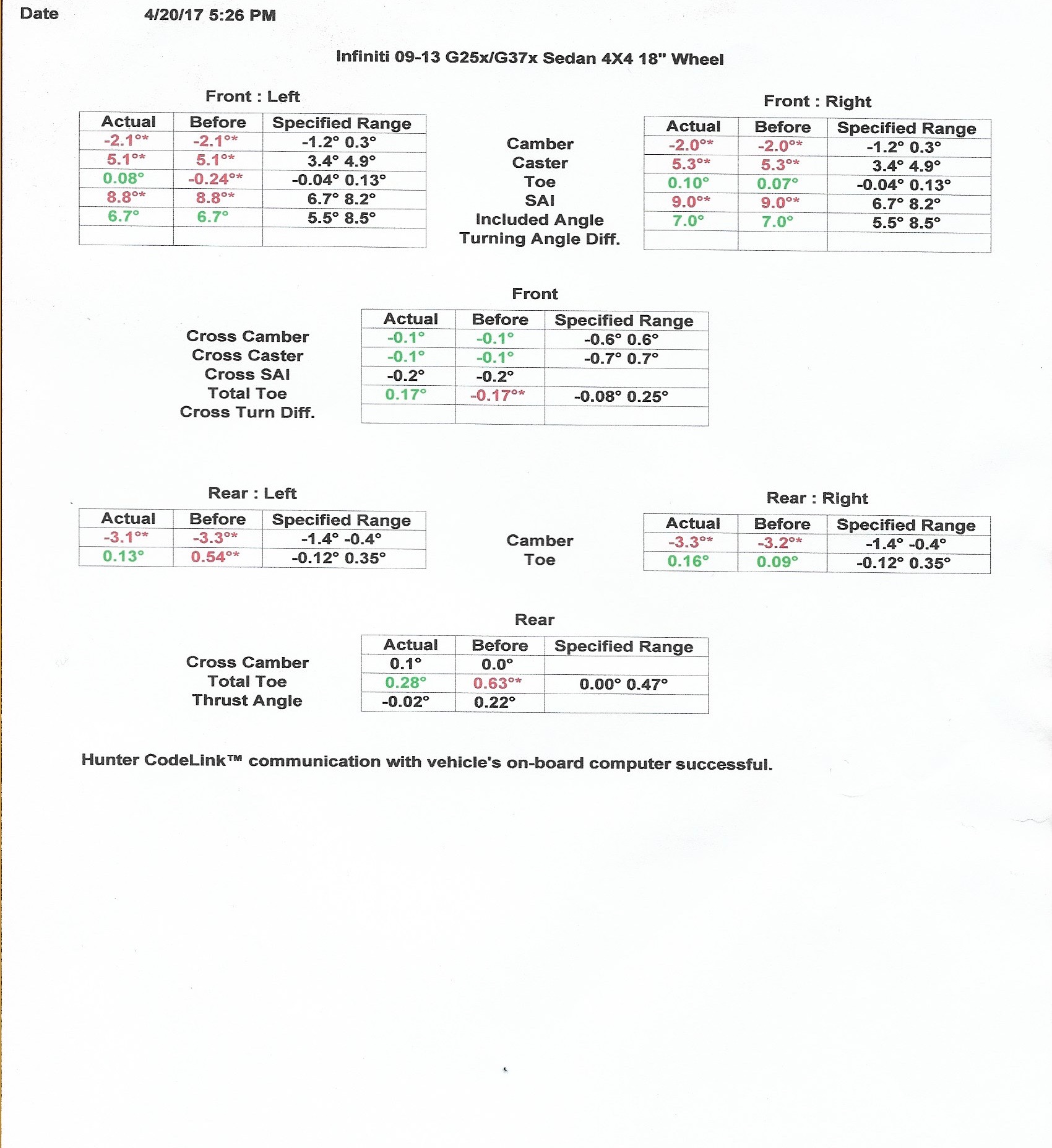

As always, appreciative of your input blnewt! Alignment work, yes.
F19x9 245/40/19
R19x10 275/35/19
You may recall I earlier questioned a members suggestion that a 285/35/19 could be considered for an AWD G. My concern was stuffing a wider tire beneath the rear fender.
Per the shop there could be no SPC rear camber install without going to a narrower rear tire. Reason given: Additional camber adjustment would only bring the rear tire outward and place it closer to the fender. As it is, the rear is completely tucked about 3/8's" inside the rear fender.
There seems to be an awful low of red on this readout - that can't be ideal?

Do you have the wheel offsets? That rear camber should be under -2 for reasonable tread wear, w/ that -3 you're going to wear the inner edges fairly quick, but your toe is good all around so your tires won't be fighting the road. I was running 295s on 10 +45 at camber of -1.0, hopefully your offset is in the +40 range, this would allow you to get that camber down and keep your fenders intact
Also are you absolutely sure there's no room to raise the back? If you can get that in the 26.25" range you should have an easier time w/ the camber spec.
Ok, found your specs, the 10 +41 running 275s will be fine w/ the SPC camber set added, you'll be able to get that camber down like me -1.0 if you want without trouble. My 10 +45 is 4mm in from your wheel on offset but out 10mm for the wider 295 for a net 6mm out from yours. Here's a pic of that setup~
The offsets are f/35mm r/41mm. What should my alignment readings be with a SPC camber kit install?
According to the supplier, who reportedly installs these XR1's on AWD G's weekly, the rear is fully adjustable as well. It seems that the issue is this shop has never installed these true type coilover's and the result is they didn't know how to properly adjust them. I'm returning to the shop next Tuesday and after the shop speaks to the supplier I'm hopeful of getting an adjusted install.
But my concern is the shop didn't read the manual, for having just read it myself the adjustment protocol is written in clear terms. The shop tech advised me "these coilovers are only adjustable at the top and can't be adjusted once they're installed. The coilover's are at max height, so no height adjustment is available."
I'm thinking it's quite possible the tech never bothered to read the install manual, for if he did why would the tech tell me the rears cannot be raised.
What's baffling to me is I chose this shop because they reportedly do coilover installs often and they are reported to have one of the best alignment machines in the state.
Well, we'll see what Day 2 brings.
