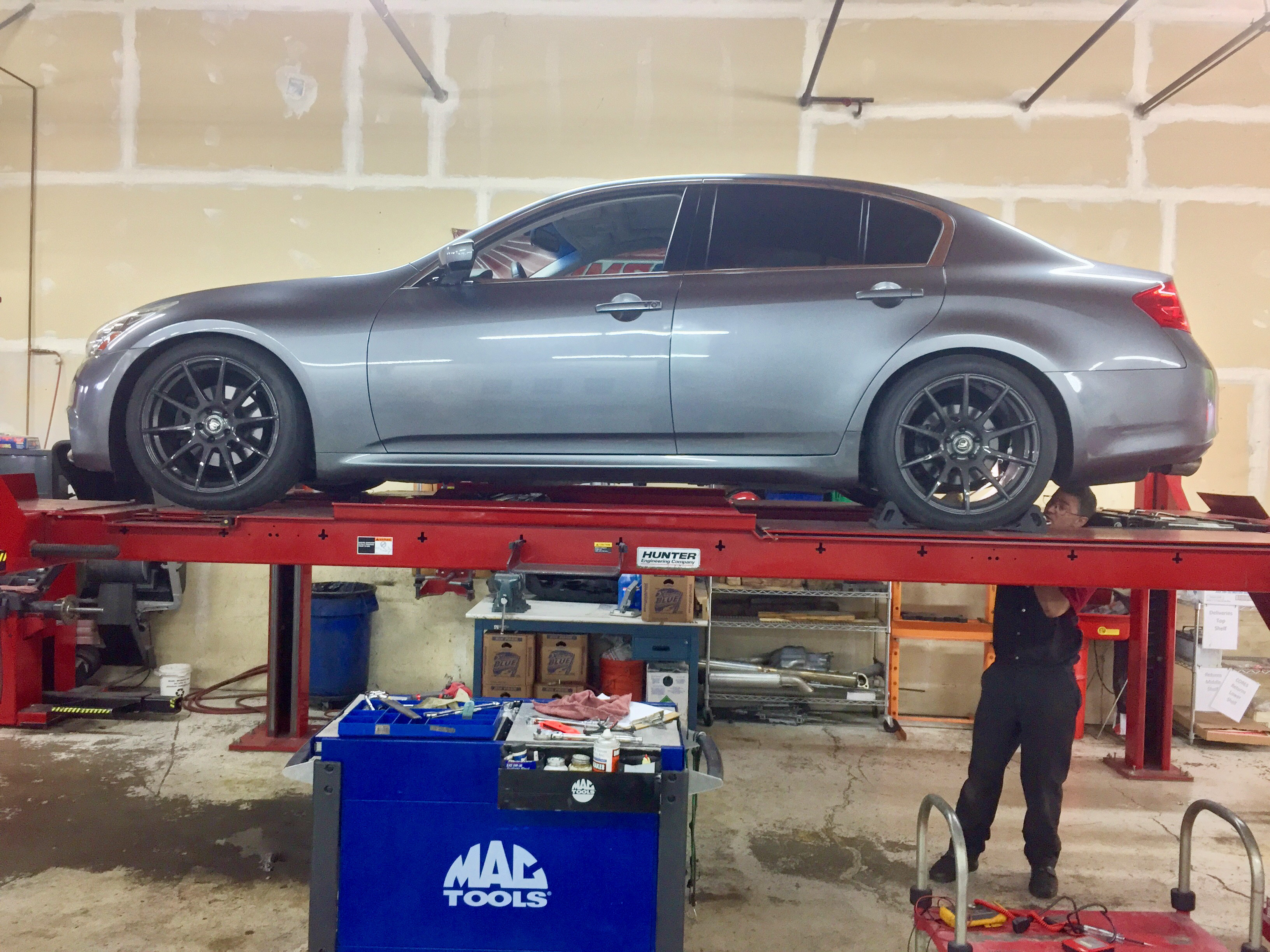

I'm sitting on the sofa of the suspension shop waiting room at this very moment. Rear camber kit just installed. C/O's being installed. Hoping for no noise from the rear.

Brad, I can't thank you enough for your continued assistance with beginning modifications of this X sedan. My initial ambition was to get a stance for an X sedan I could live with. Thanks to you, and others here, I've now achieved a setup I can begin to work from.
Okay, good newz!!!
I took Brad's recommendations and went for a target install of 26.75"
G/F height front now is 26.5/8" - even on both sides
G/F height rear now is 26.75"
I had a 40 minute hiway ride home from the shop. The best way I can describe the ride is driving a moderately, and welcomed, stiff sport type suspension. Ride quality is firm, with greater control than OEM. I'd anticipated a rougher ride, but 24 hours later, no. Going over bumps, I don't experience any pre bump apprehension as I did with the initial install. In relation to OEM, the ride comfort feels closer to stock than I anticipated.
Better yet, now there's NO noise from the rear.
An update on that former noise note: I discovered that the shop that did the initial c/o install did not set up the rear coilover's correctly. The shop failed to torque down a nut at the top of the XR1 c/o's that, per Stance, required a 35 pd torquing. This failure to do so led to an upper rubber/metal bearing around the shock shaft pinging against the shaft over every bump.
I was fortunate to find a more legitimate shop that quoted me a flat rate install. The tech in this new shop doing the break down of the rear c/o's to install the proper 10.3" rear dampers worked for years as a Mercedes shop tech. He spent 9 hours on the install of the rear SPC arms and toe bolts, c/o install, road test, and ride height adjustment.

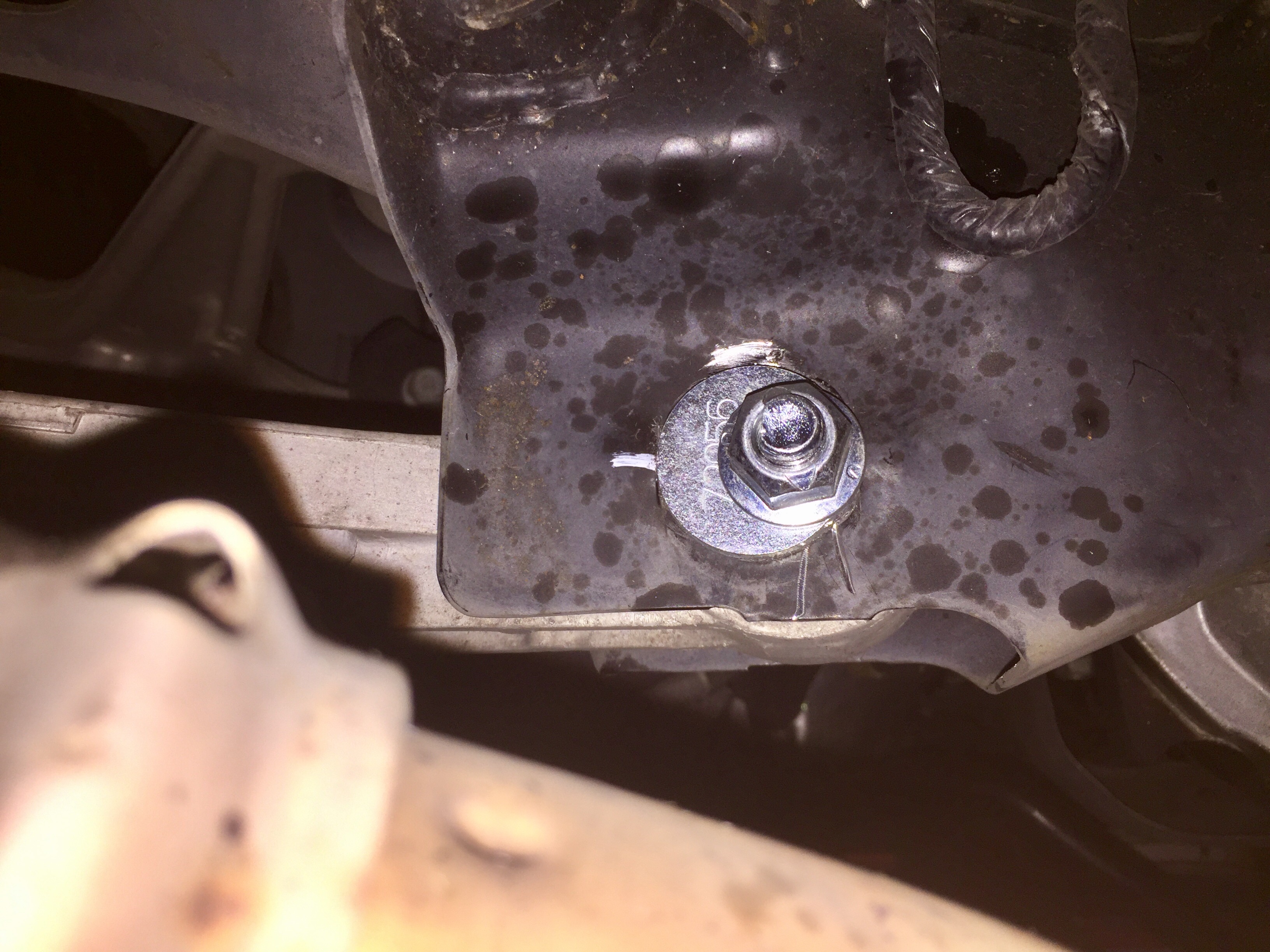

SPC toe bolt install

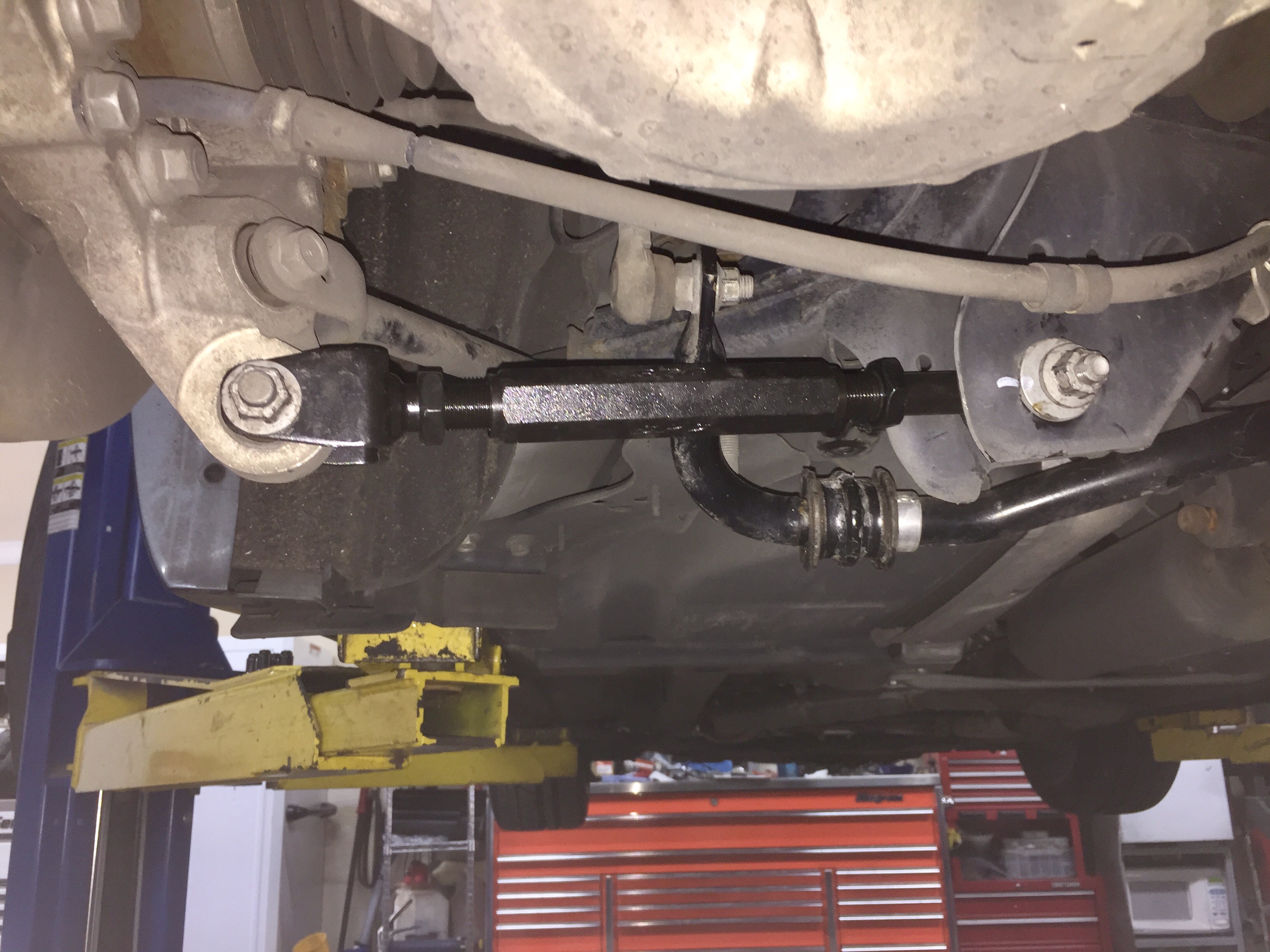

Camber arms

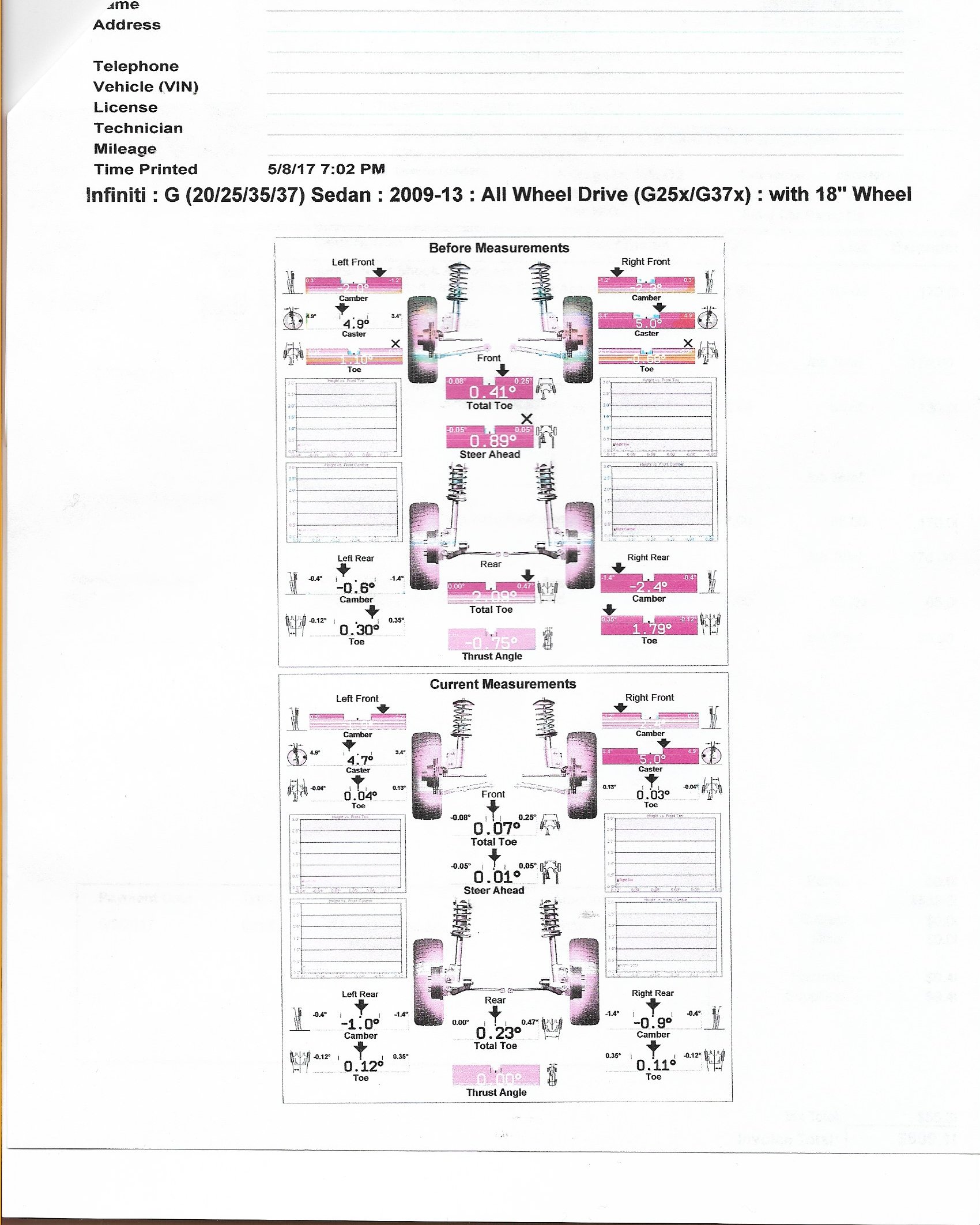

Initial after c/o install alignment specs for rear camber were L/ -3.1D R/-3.3D
Here's yesterday's alignment - rear camber spec is now L/ -1.0D R/ -0.9D

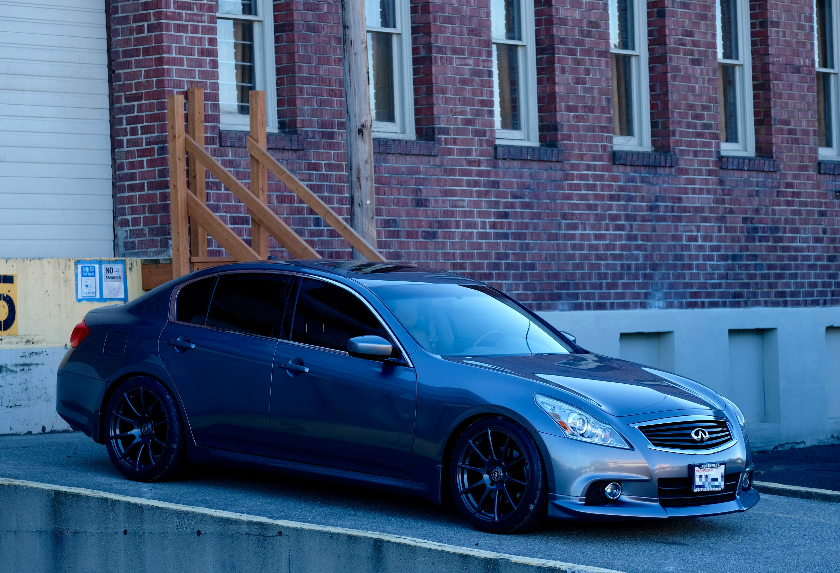

after install
