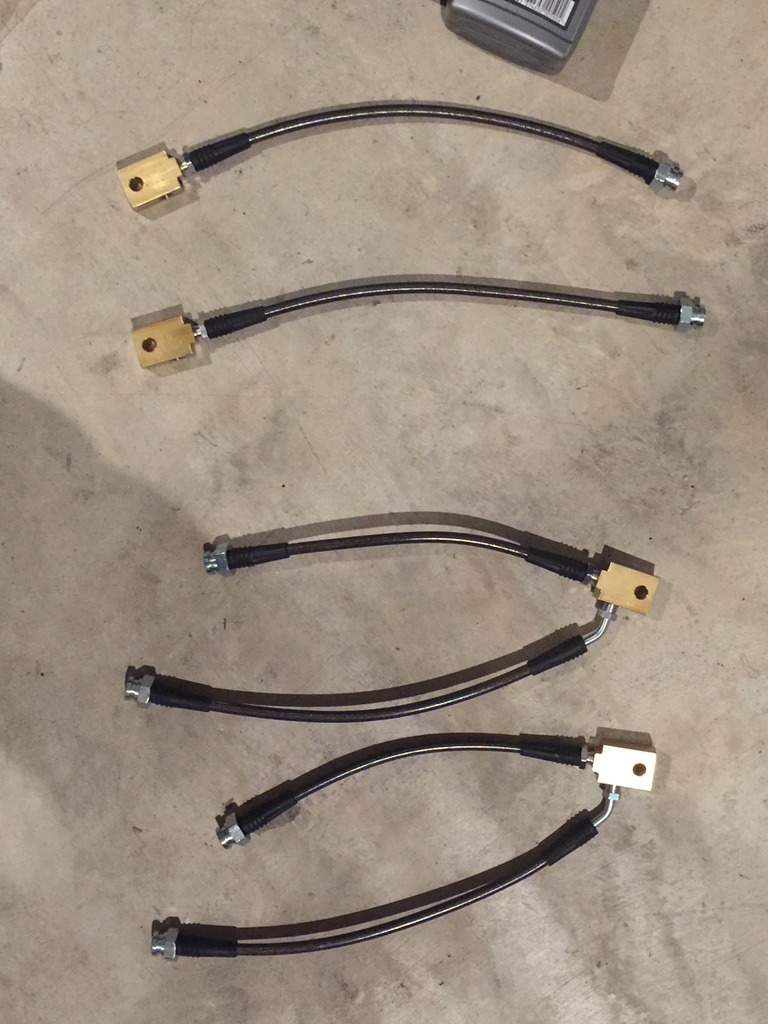

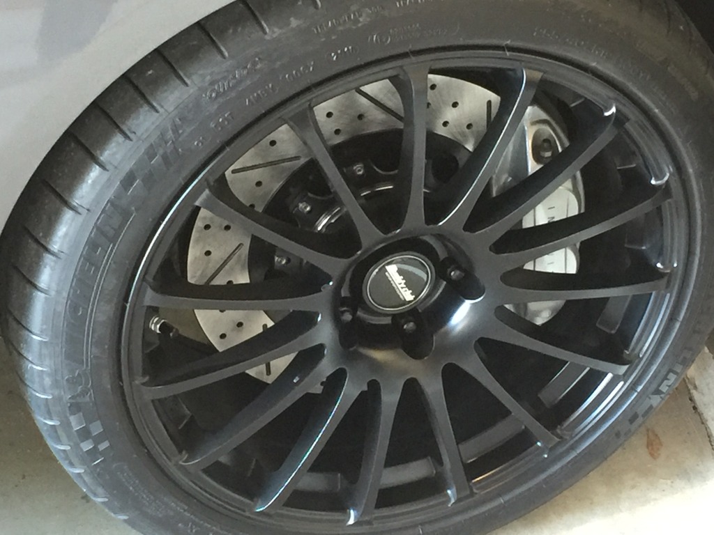

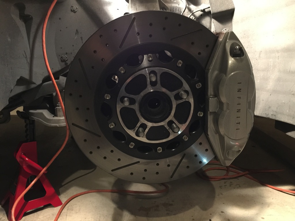

Z1 2-Piece rotors, braided lines and Nismo pads
I made a bunch of changes within the period of about a month so it's hard to differentiate between the individual components and their effect on braking performance.
I completely overhauled the entire brake system short of the MC and ABS unit. My OEM brakes were still very fresh and bedded in well but did need a brake fluid change. They had 30K on them and pads looked almost new when I pulled them.
I upgraded using the following parts:
-Z1 front and rear two-piece rotors
-Z1 premium stainless steel braided brake lines
-Nismo pads
-Z1 master cylinder brace.
I do not track the car and don't plan to therefore I went with cross drilled and slotted rotors and felt comfortable choosing the Nismo pads based on a Car & Driver review as well as from forum members over on the370z.
I did install the brakes/pads first, then the lines and brace second. So I had some time to evaluate the rotors and pads before doing the lines and brace.
After bedding everything in, braking force was noticeably stronger but easier to modulate. The pads do not have the initial bite of the stock akebono sport pads but are far more sensitive to braking pressure throughout the pedal's travel. It's just more of a 1:1 correlation with no drop-off. They're very intuitive pads if that makes sense
Knowing my fluid was over two years old, I replaced it, along with the lines. I used Motul 5.1 which works very well with ABS systems as it's elasticity is less than standard brake fluids and it works better in the small passages of the ABS control module. If I were doing track work, I'd go with Castrol SRF.
While I was expecting a drastic improvement in the pedal's firmness, I didn't get that until I bled the brakes a second time a week later. Switching out the braided lines introduces a lot of air into the system and you'll have to bleed them with a level of devotion bordering on obsessive compulsive. And then bleed them again.
Once I had the lines bled properly, I did the Z1 brace and it indeed made a difference. It's a huge PITA to install and you will need the proper tools to do it (namely a round point 5mm allen hex extension).
The sum of the parts is now pretty incredible. The car will stop HARD. Throw you into the dash hard without engaging the ABS. I've also upgraded the rolling stock with wider wheels and stickier rubber which allow the brakes to work at their optimal level. If you continue to push on the pedal, you'll eventually run into the ABS system. It's easy to walk the brakes up to that point and back.
The Z1 rotors are a good deal lighter than stock. The machined hats are works of art and they're very easy to assemble/disassemble if you have to change out rotors in the future. They're coated rotors so the the parts that don't touch the pads will resist rust. If you track them, that coating will burn off. So far that hasn't happened to me. I had zero issues with the rotors, everything seemed to be in spec and I didn't have any new vibrations or noises after installing the rotors when not braking.
As I stated earlier, it's a street car so I went with the cross drilled for wet weather performance. If I were going track-only, I'd do solid disks without a doubt.
The disks have a slight whirring sound when applying the brakes and you can feel it in the pedal. It's not bothersome in any way at all, it just feels different from OEM and it's a good indicator of how much more feel there is through the brake pedal itself.
Initial bite on the Nismo pads is still "softer" than the stock Akebonos but there's just basically more feel and modulation with the pads under any pedal/braking force level and you can just feather the brakes to scrub off slivers of speed when needed.
I'll also say that the hotter the ambient conditions, the more initial bite these pads will have. I went from a 50 degree to a 75 degree day and the initial bite increased by a good amount. They will also bite harder after the first braking application. Rolling out of the driveway backwards on a cold day, the pads will feel soft. They'll squeak a bit after washing the car but that stops quickly.
And the Nismo pads do dust. It's a fairly dramatic increase from the stock Akebonos. So if that's a concern, look elsewhere.
In addition to a big increase in braking performance there's a rather large increase in unsprung weight. In my application, not only did I loose weight via the rotors but the dampers, tires and wheels. All told, I'm in the neighborhood of 15 pounds per corner front and 8 pounds per corner rear. There's lots more traction to take advantage of in the corners and under braking and acceleration but it's made a night and day difference in ride quality. The Michelin PSS is more compliant but I wasn't expecting such a noticeable difference after installing the rotors. I have a much firmer suspension setup but it very close to riding like OEM with all the benefits of a higher end suspension system and spring rate. The car seems more in control over typical road irregularities and the suspension feels softer without actually being any softer from a body control standpoint.
In short, they're more brakes than you'll ever need on the street and they offer a wider margin of reserve braking force vs. the stock setup which can get a bit soft and loose feel on hot days.
