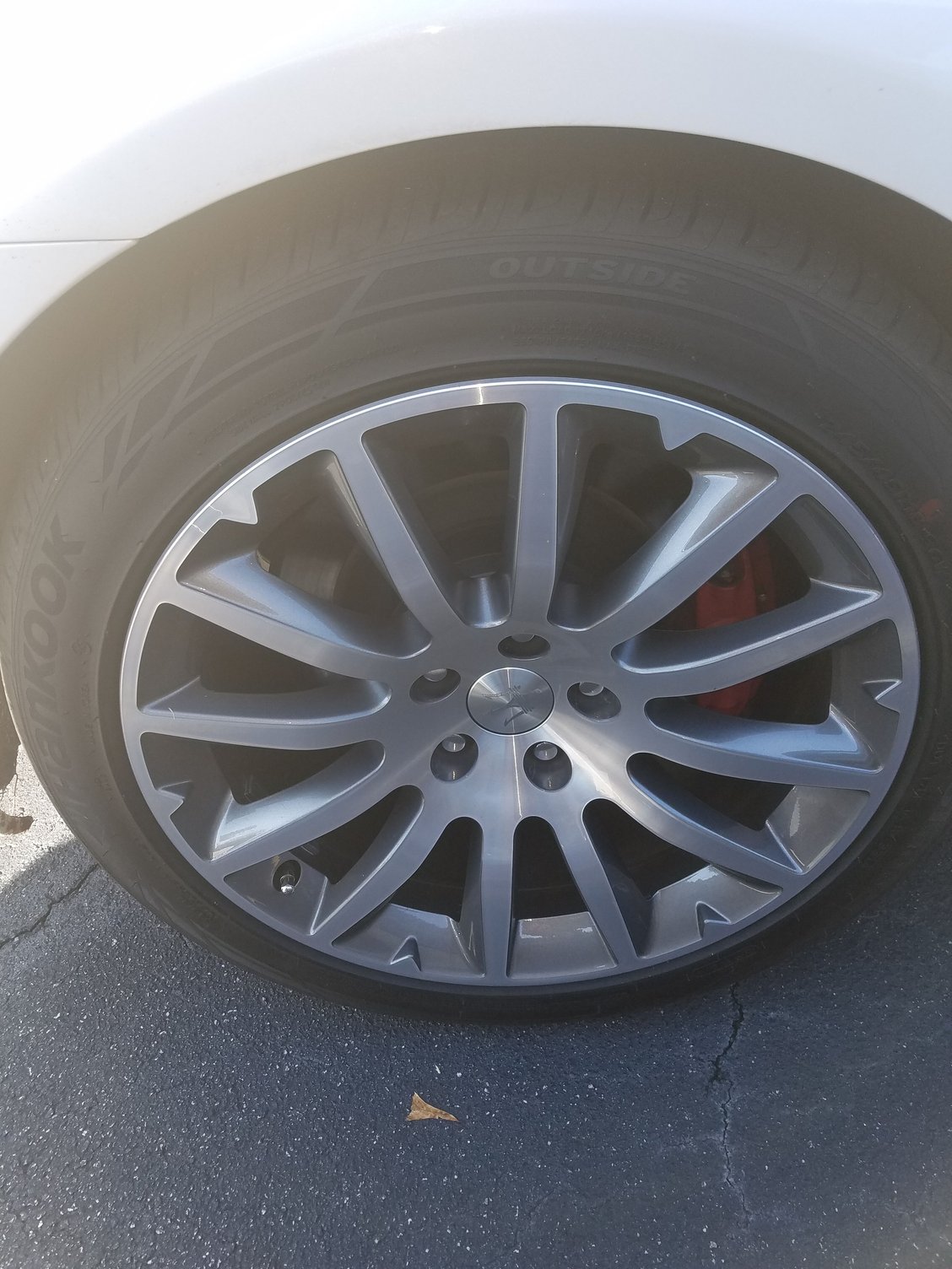

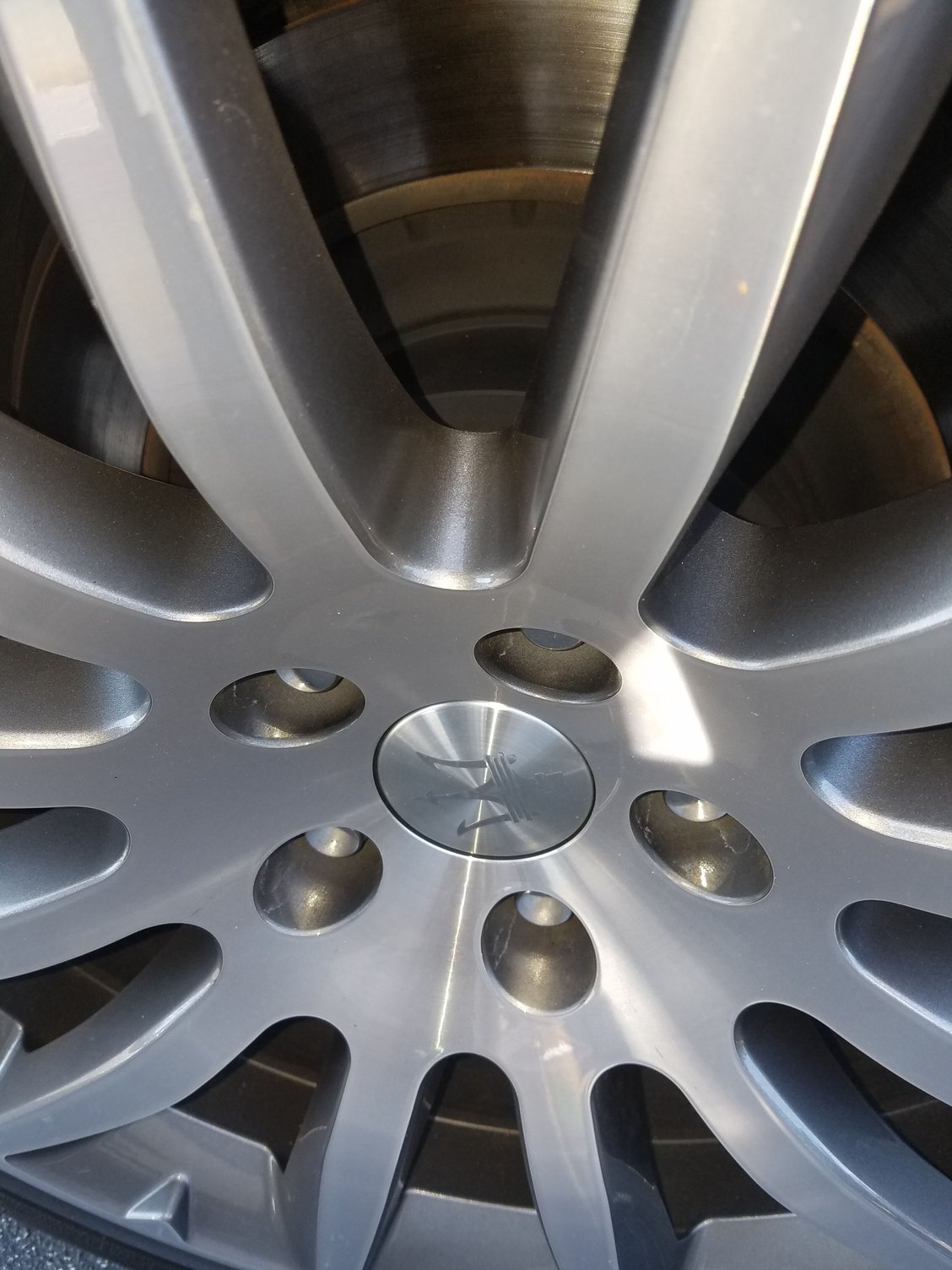

They are not OEM they are aftermarket. I didn't change them it was whoever owned them before.
Please see a picture below:

They were all no when I bought the car so I can't really answer that question. The tires are 18in. I just added some pics of the car and wheels that are aftermarket.

What are the specific tire sizes? 225/50/18 or something like that? It could be throwing off your traction control if there is too much difference. Also it is possible there is no TPMS in your wheels or one or more is not working properly (needs to be recalibrated or replaced). And did those wheels come off of a Maserati?
Wow! I never even put the two together. Looks like they came off a GhiBli.
#1981 2014 MASERATI GHIBLI ALFIERI STAGGERED FACTORY OEM 18 INCH WHEELS RIMS | eBay
Well damn I really like the wheels, maybe I can get some Infiniti caps to replace the Maserati ones.
Anyways the tires are 245/45/18. I have a Tires Plus I trust to work on my old 2003 G35 can I bring the car there to look at the TPMS or do you think I need to go to Infiniti for this?

I'm sure he can do that for you. Either you don't have any TPMS installed, or they are out of battery or need to be re-calibrated. I'm betting you don't have the right TPMS or none at all if they came off a Maserati.
