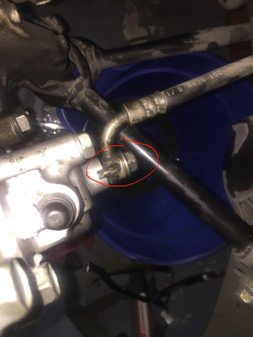

Installing the rear akebono caliper and I've come to a road block. The point where the line is screwed onto the caliper is what I'm talking about. The bolt doesn't seem to screw in all the way so the line has space to wiggle and potentially leak fluid. Should I just add washers to remedy this?

Do you have both copper washers installed? There should be one on each side of the banjo bolt.

You probably need the shortened banjo bolts if you're using your stock lines. https://www.z1motorsports.com/brakes...lt-p-8488.html

I got it fixed guys. I had dropped one of the copper washers. I'm good now lol

if those are stock lines you need shorter banjo bolts

I replaced the stock line with Ss lines. No more stock lines like from the pic
